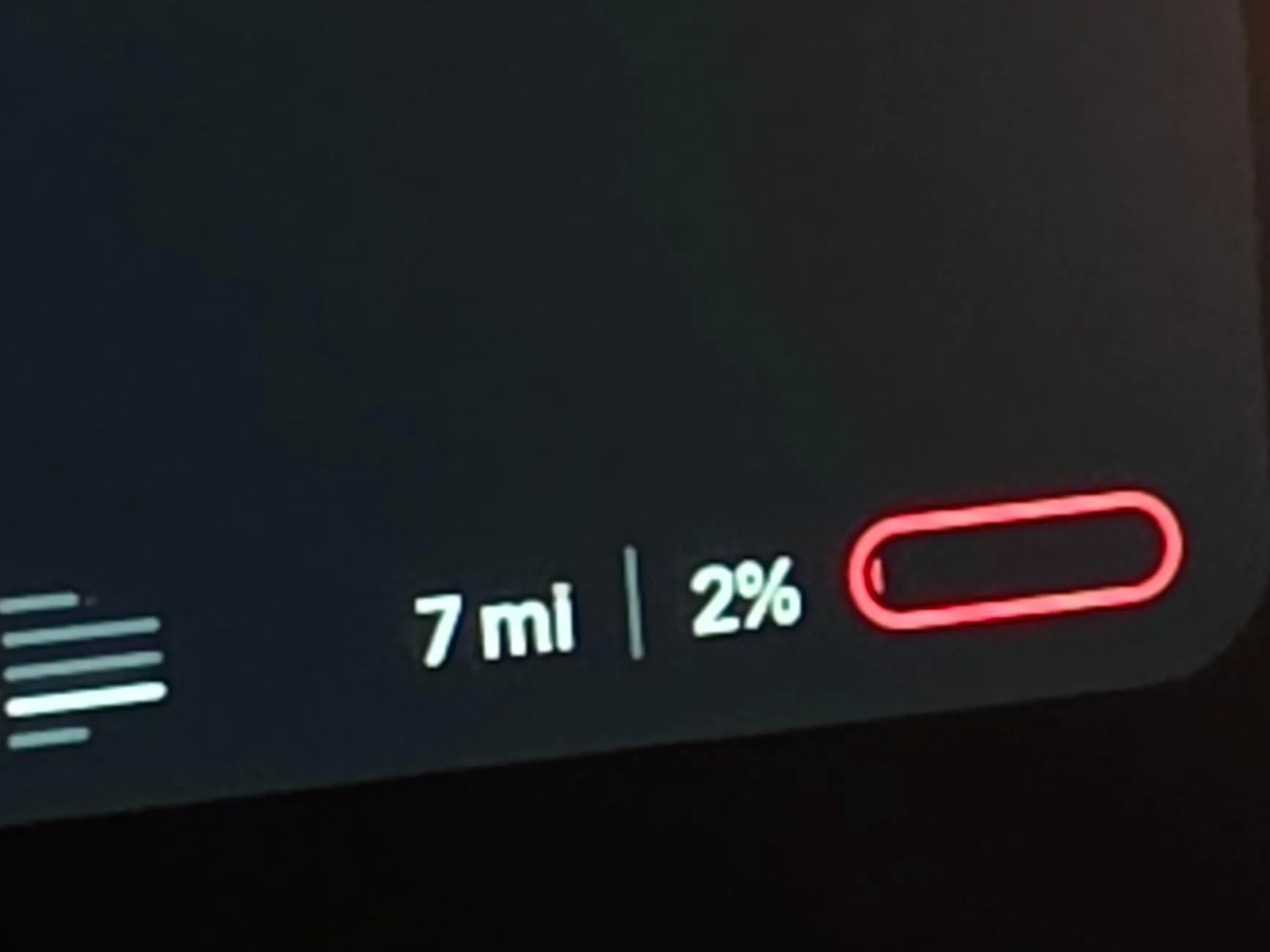

Excellent insight and I’m going to try this. On my Phx-SD trip I avoided one Tesla SC stop because it’s always a shit show there. I made it to Dateland with 10%. Not quite your balls of steel with 2% lol
I do mostly Tesla SC and had no issues. I normally have a 'plan b' mid way between my current location and charge destination. If while heading over, the wind picks up or something goes sideways I can always slow-down and make it to my destination or use that extra PlanB stop and carry on. I had to use my plan B only once because my right foot got heavier 🙄
But I did over 7k miles of road trips already in less than a year, So I got pretty good at calculating my range 😊
One of many examples (and it was in the middle of nowhere)

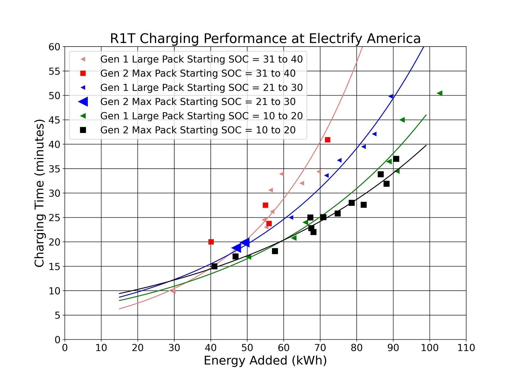

Anyone have quick links to the charging curve differences between the G1 large packs and the G2 Max packs?
As best I can remember there is only a 10kWh difference between them (G1 Large = 131kWh, G2 Max = 141kWh). If that's the case I'm not sure how much time would be saved overall, however I can see the added sense of security being a nice benefit.
Plus getting a new vehicle is always fun. :D
I have owned both the Gen 1 large pack and the Gen 2 Max pack. They add equivalent amounts of energy in a given amount of time as the chart below shows.
Rivian R1T R1S Fast Road Trips with Max Pack? IMG_4429
i have kept detailed charging records on my road trips and can also say my experiences have been the same with electrify America and superchargers.
