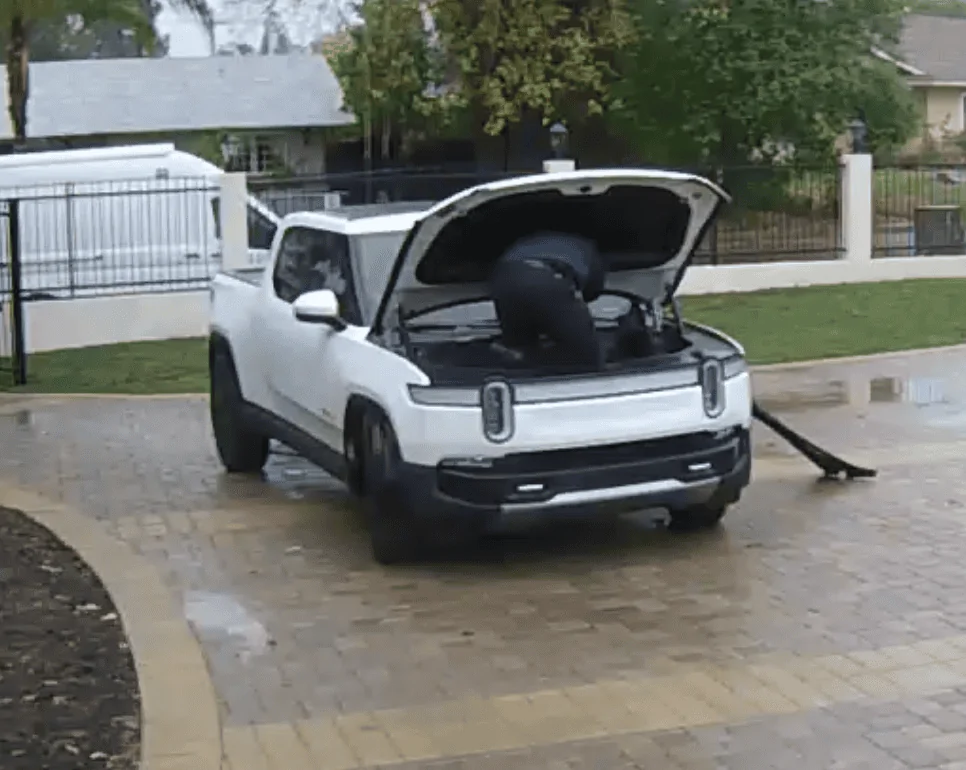

They're working on it.
So far, removed the fender well panel to get the frunk open. Now replacing the battery....
From my security camera....

Not going well. 12V batteries replaced. Headlights flash when pushing the frunk button, but doors still won't open. Appears likely this thing is going to be getting towed to Rivian. Fingers still crossed.

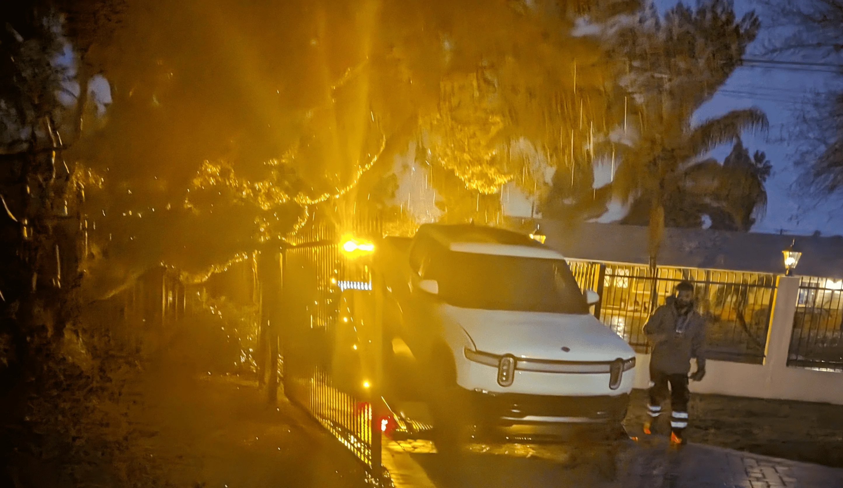

Unfortunately, jumping the truck didn't help. Rivian mobile came and changed the 12V batteries and still nothing. The tow truck driver tried to jump it as well (from the rear and directly from the batteries).
The ONLY thing that worked was the hazard lights.
Tow truck driver broke in to the truck to get the door open so I could get my stuff out.
Tried a hard reboot as recommended by the service tech that was here, once I was able to get into the truck. No luck.
Other than hazard lights, truck entirely dead. No dome lights, no brake lights. No window controls. Nada, nuttin.
Even more odd, once the frunk is open, you can't close it!
It's heading to Rivian now to let them figure it out. Clearly more than just a dead 12V battery.
Still amazed it takes all that just to get the door open. Really needs to be a better way.
Scary thing is, the tow truck driver is apparently a Rivian specialist and said he's come across this 250 to 300 times just in the SoCal area alone!!! That's a big number considering the number of trucks sold, let alone the number sold in SoCal. He definitely knew what he was doing.
And here I thought I was just getting key fobs programmed!
I can say, Rivian has responded well. They weren't able to resolve it yesterday when I called. But, did get someone here the next day, despite telling me they couldn't. Once the Rivian tech completed what he could do, the tow truck was here within a couple of hours to pick it up.
Away she goes......
