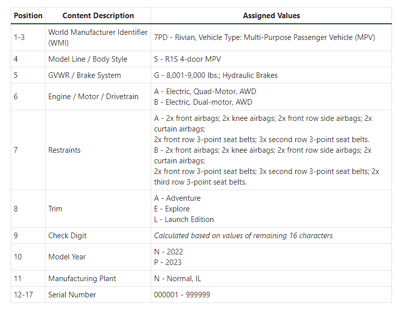

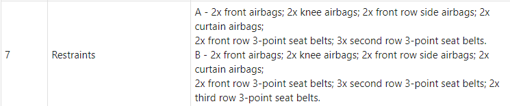

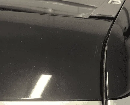

R1S Vin Decoder, The only difference is the 3rd Row Seats have a 3 point restraint sysyem. I would not be worried about that at all. Unless there is something else you may have read. If so please share with the group. Now for all that other stuff, those pictures make it look like a used car to include the micro scratches on the roof of the SUV. My last four of the VIN is in the Mid 8K range but have not seen it in person yet. This forum makes me nervous.

That has quite a bit of issues. I’d also return it and ask to be put back high in the queue. Maybe they can give you access to the R1S Shop.

Sorry to hear about your issues! I would follow other posters and recommend returning it. This probably was rejected previously. The pictures you sent over do look pretty rough.
As far as I read, the changes were the 3-point belt and a design change on the floor of the driver's side. Certainly not something that is overly concerning for me at this point and I've gotten my wife more comfortable with it as well.
Rivian had plans to build both 2-row and 3-row R1Ss when that VIN decoder was provided to NHTSA. The seventh digit would be "A" on 2-row models. The seventh digit should be "B" on all 3-row models.
