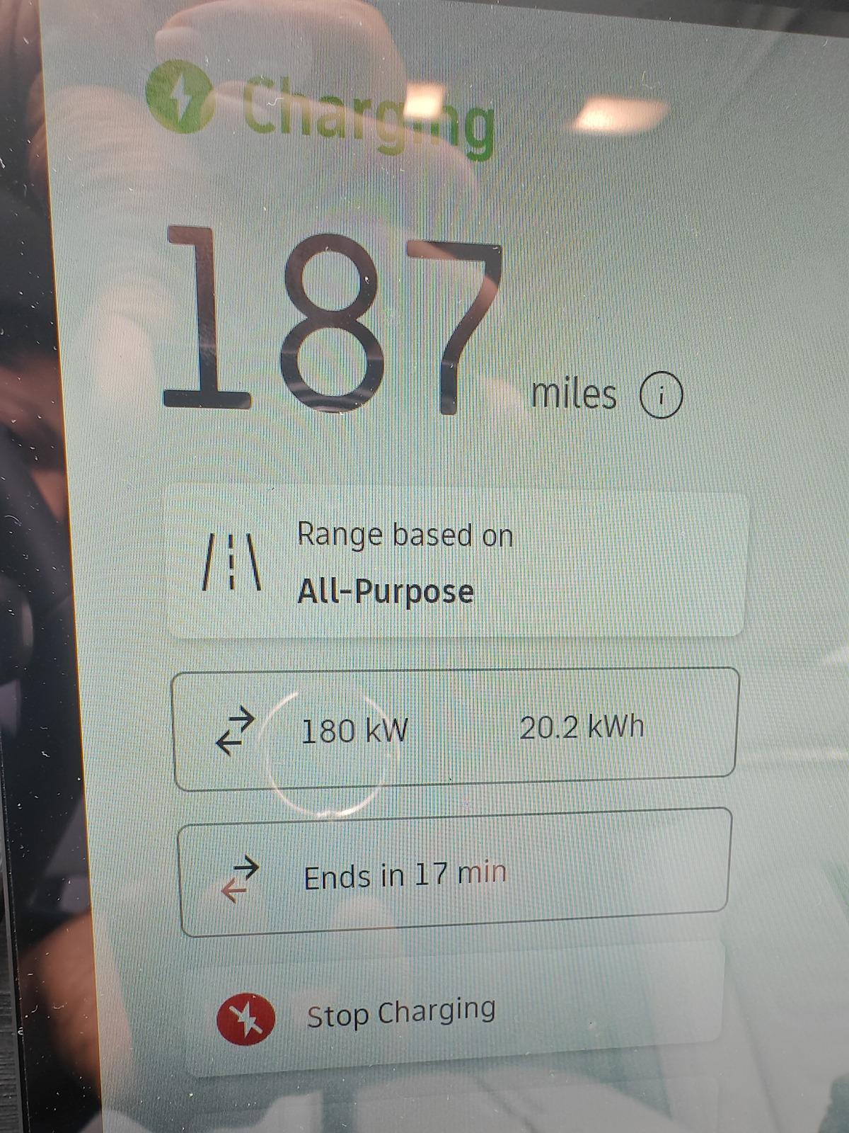

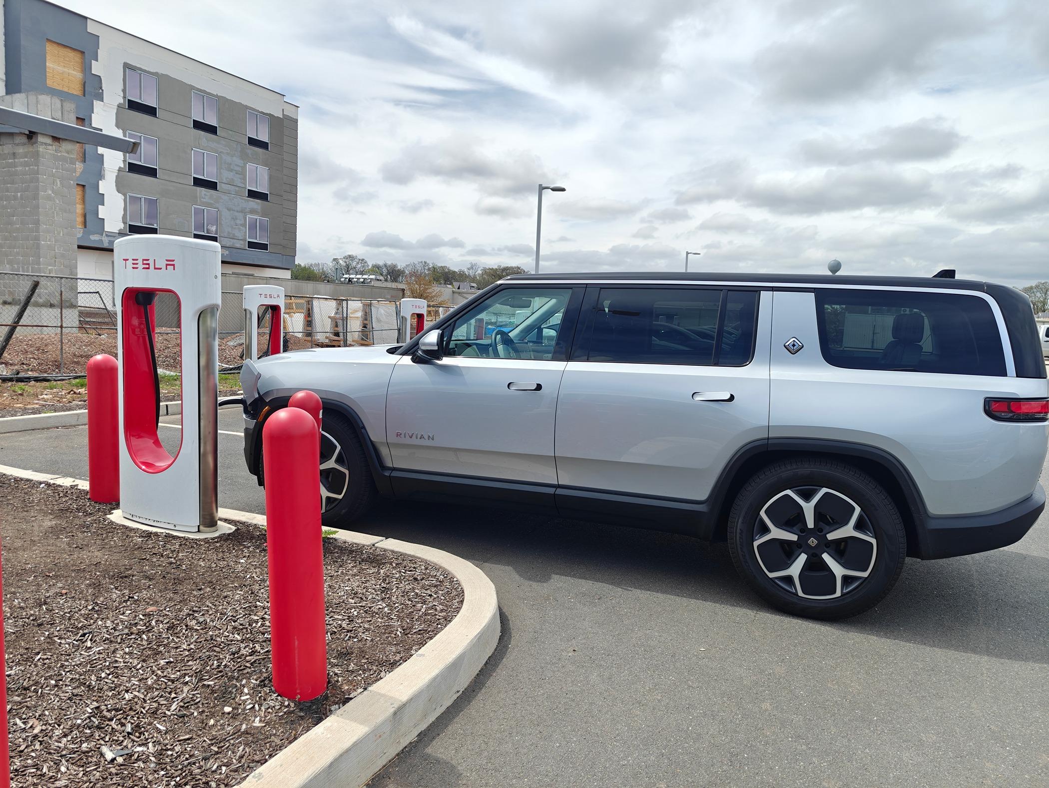

Just tried charging successfully at Tela supercharger here at Union NJ.
Observed peak of ~180kW which is not great (as I have gotten 215kW at the RANs), but acceptable.
Plus I had to use Tesla app to charge.i think due to the other OTA issues on my vehicle (no networkz telematics etc) my Rivian app does not recognize the vehicle and my profile essentially.
I had to park weirdly though.
@A2ZEV - A2Z have been great to work with. They shipped me second adapter when we confirmed (via video call) that the first one didn't work for some reason. Great team there.
