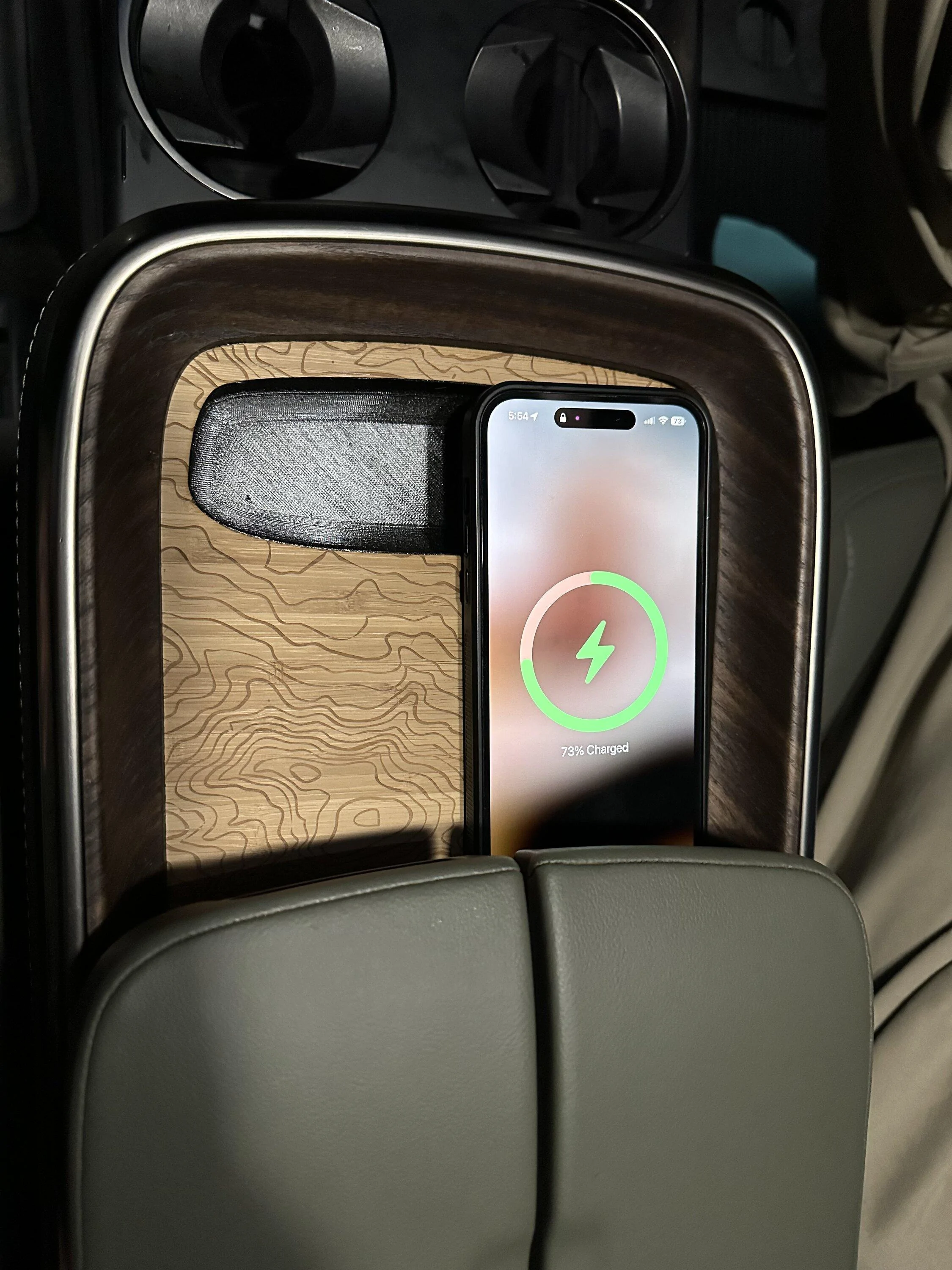

Was also team flush - but I'm currently rocking this plate in my truck and am loving it. Would I still love a rubber mat that was completely flush like the OEM one? Yes. If that aesthetically was 10/10 for me, this is a solid 9.5. The lip is a non-issue once you get it plugged in. I will say that getting this installed is DEFINITELY a more involved process than "remove rubber mat, drop top plate in" - but the fact that my USB-Cs are totally available now for whatever else in the center console, plus I have this rad topo map wood plate instead makes up for that more involved process and means that I'm using that area for my phone essentially 100% of the time I'm in the truck, as opposed to 5% of the time before.
Rivian R1T R1S First Look at Premium Charging Plate IMG_3767

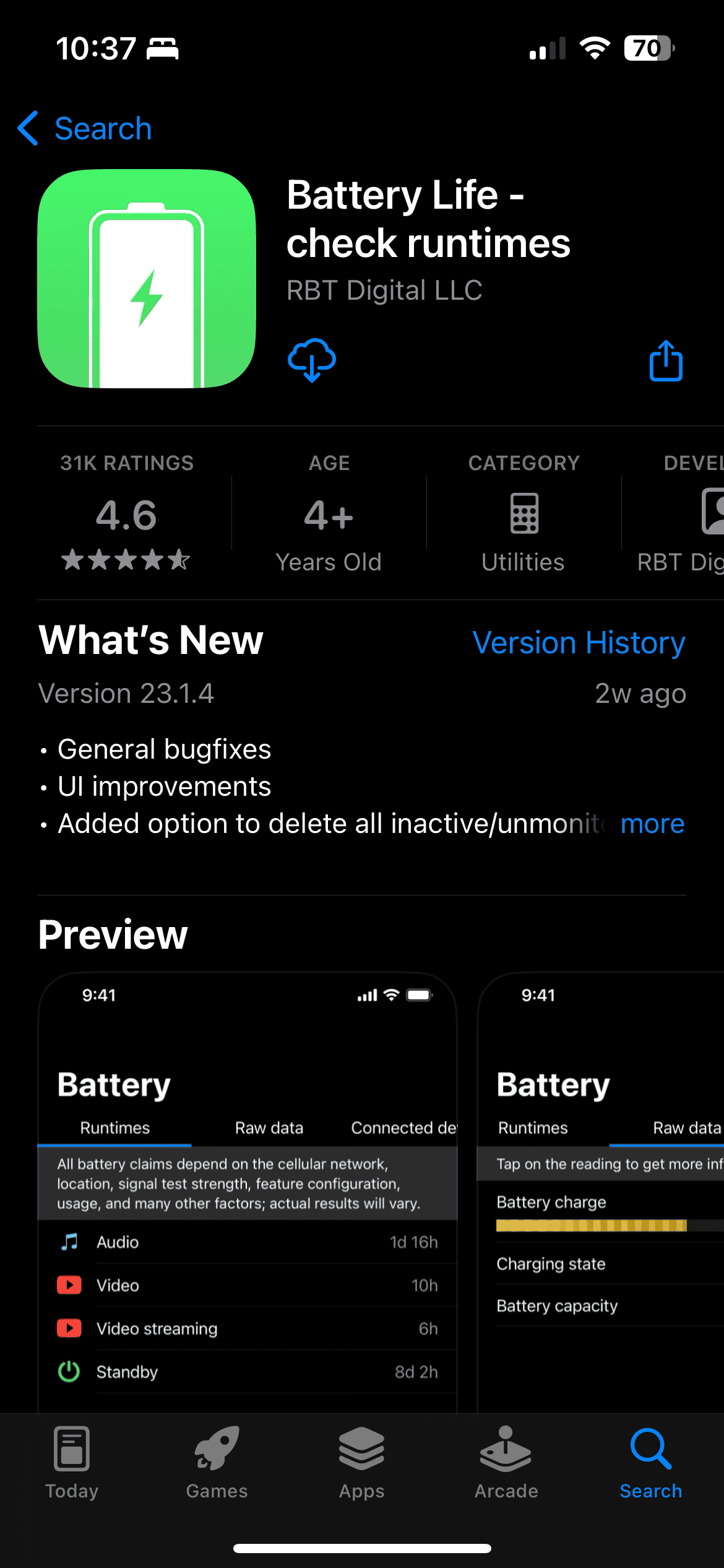

Ok, I was assuming the same as all of you. Maglock works well through the veneer. Charging: Seems to be working similarly as exposed.
Oh I meant to tell you there are apps to run on the phone that show you the approximate charging speed, I say approximately because I recall it gives you a different spec that’s not 15 amps or 30 amps so you have to do some math, but, essentially I recommend testing with the phone under 30% in airplane mode, run the test with exposed puck then let the phone run back down to the same starting % and run test again.
This is the app I’ve used before to test charging speed
Rivian R1T R1S First Look at Premium Charging Plate 8BFCC36E-C8EC-46AD-A8C1-547ADF757BE9
