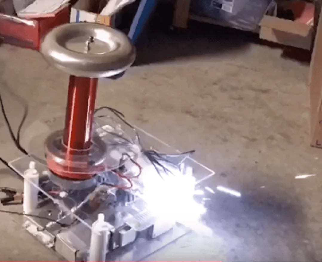

One thing is certain - someone will try extended flat towing at speed - "What could go wrong, hold my beer!". And then we will find out what really happens. I expect *boom* and "magic smoke" from the inverters. I've seen the results several times in automation systems VFDs. Here's a picture and video of a small hobby IGBT (Insulated Gate Bipolar Transistor) failing. Rivian's inverters have much larger and expensive IGBTs.
