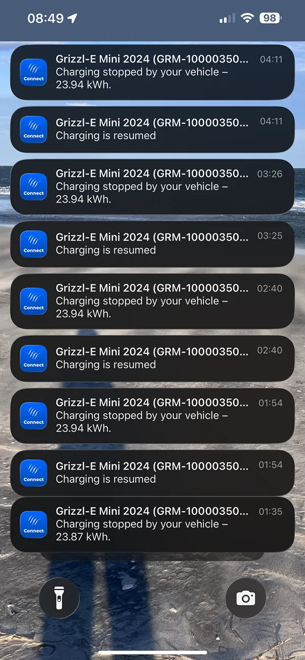

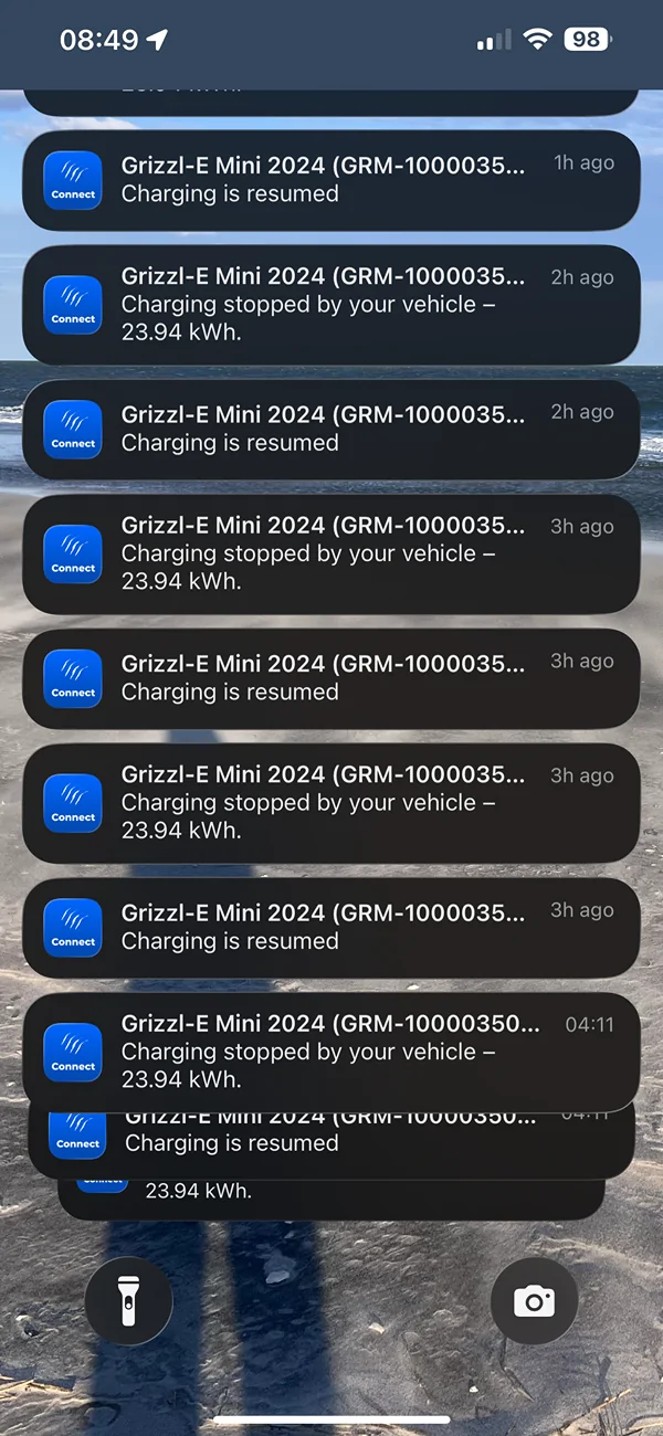

My R1S gen2 max pack is charged with Grizzl-E mini at home. I noticed there are frequent resume and stop cycle after schedule charging session is completed. It’s about 1 to 2 times an hour. The schedule is set on Rivian and amperage 40A. Which device could be at fault, car or charger?
Now I am writing this and an idea occurs. Next time I’ll set schedule with Grizzl-E to see if it will stop the cycle. Anybody has similar experience?

Just to provide some more information as context when this happened.
*Gear Guard is off
*Home proximity is lock only so PAAK not an issue.
*Climate is off
*Average 24 hr battery usage is around 2.3 kWh as reported by Rivian app
It seems a slightly more self draining might be the cause? BTW my 2023 Ioniq 5 on same charger does not have this behavior.

I don't experience this with my Chargepoint. I find it interesting that yours tries to start charging every 45 minutes like clockwork. And if I'm interpreting the messages correctly, it's not actually adding any charge. It just wakes up, attempts to charge, realizes it doesn't need to and then goes back to sleep for 45 minutes. that would seem to rule out a vampire drain issue. perhaps the grizzl-e unit is just logging things that Rivian and Chargeepoint do not?

If you are losing 2.3kw a day then there is something wrong with it, usually it is due to the 12v battery not able to hold a charge long enough thus keeping the truck awake and draining the HV battery trying to keep the 12v charged. Stick a trickle charger on the 12v and see if the excess drain stops. If you have HomeAssistant or RivianRoamer or similar you can track the sleep cycles there. On a healthy truck the average drain is about .5 to 1.5kw a day.
