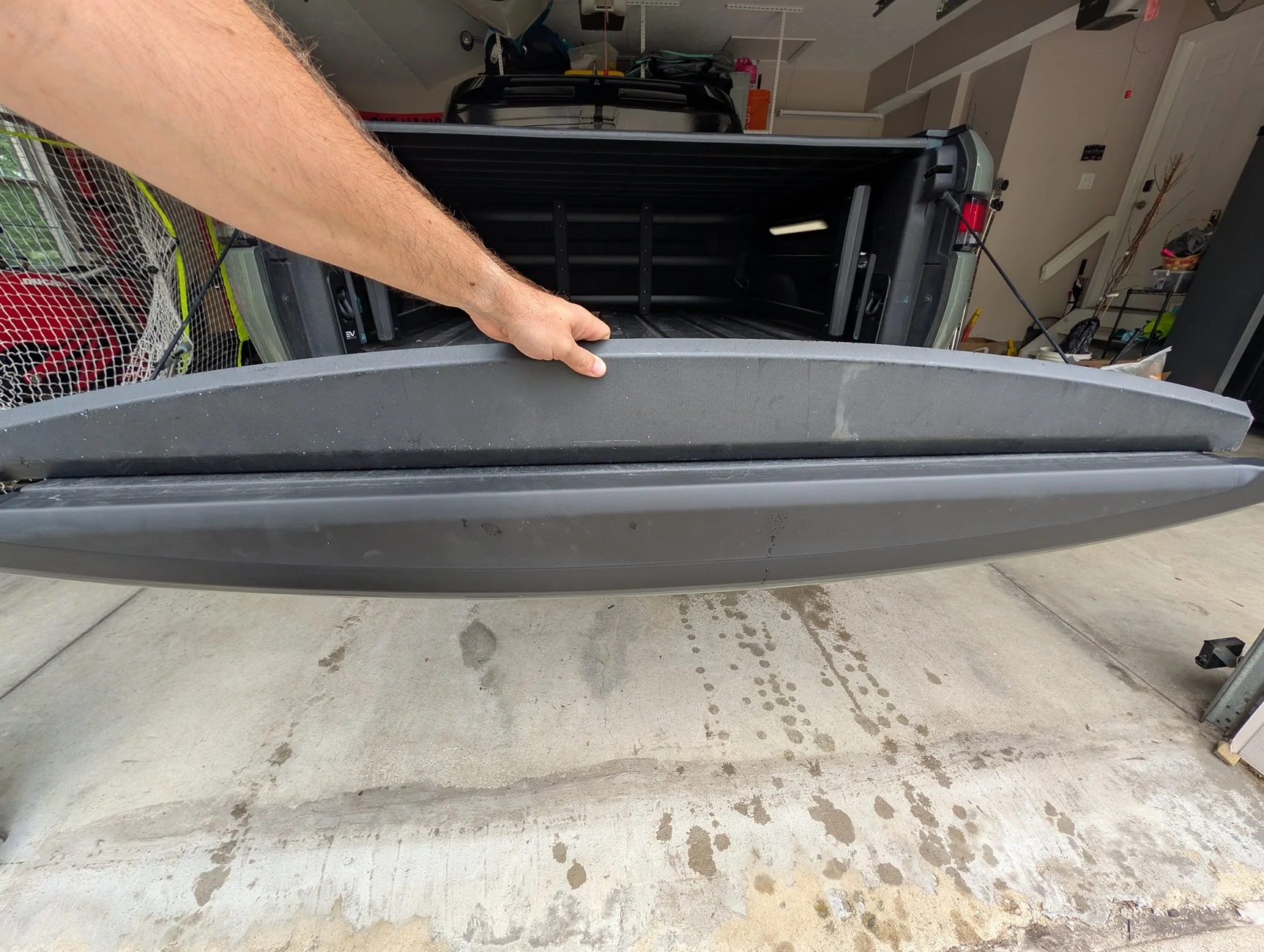

On the plus side, they replaced my tailgate trim under warranty and seems they've updated the piece. It's now a tacky/rubberized front section, seems nicer.
