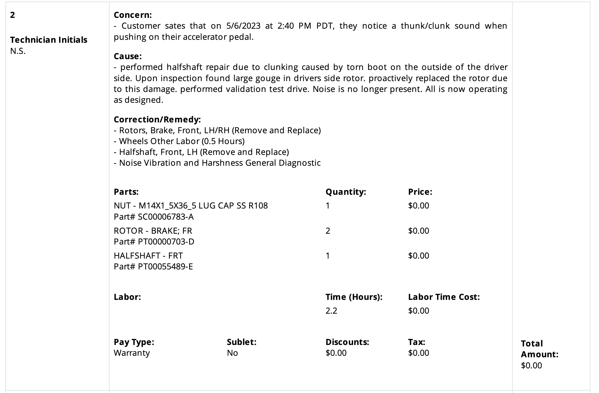

I have had this issue for 6 months. I think I FINALLY have it fixed (for now).
They replaced the front subframe on a previous visit which got rid of all "creaking" at low speed, but not THE CLUNK.
On the latest visit they found that one of my axle boots was torn and was probably under lubricated leading to failure so they fixed that. They also found that one of my brake rotors was damaged and replaced that.

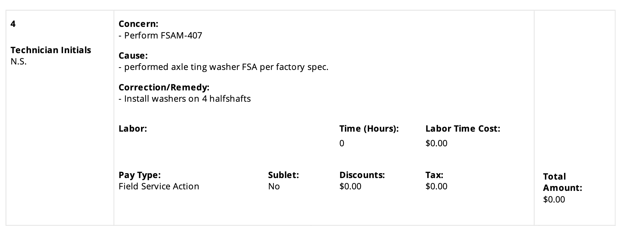

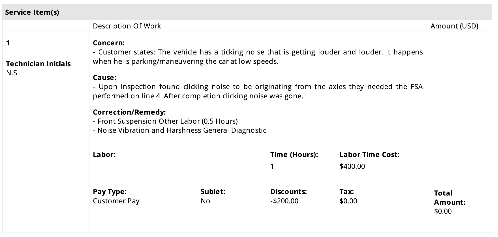

They also completed FSAM-407 which is to add the washers to the front half shafts and re-lubricate.
I just picked up my truck on Thursday from El Segundo and I have NO CLUNK. Hoping it doesn't come back, but the truck is not the quietest it's ever been. I have driven it in all low and medium and high suspension (not highest or lowest yet) and the noise is gone.
I'm including the items from the work order with the service FSA bulletin numbers so you can inquire about them.
