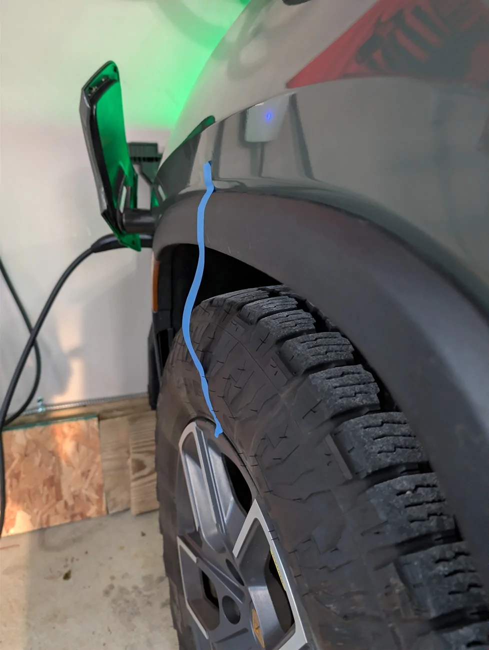

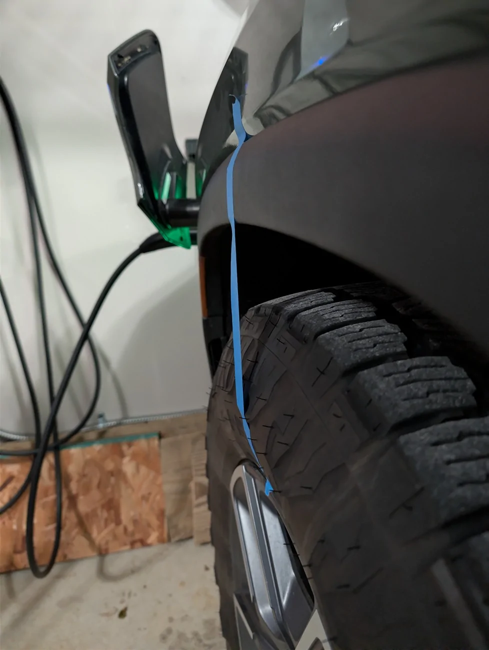

I had a mobile service appointment to change my 12V battery for the 3rd time yesterday and mentioned to the mobile tech that I am seeing my suspension drop over time. I hadn't pulled it out of the garage and he said that it did look low. He gave me a good idea to use some blue painters tape and tape it taught between the fender trim and wheel (he said that's what the service center did). I drove the vehicle a bit (In-n-Out run) and went back home and applied the tape so it was taught. In just 24 hours, I can see that the tape is no longer tight and the vehicle is dropping. I'll give it the weekend to document and submit a ticket. See attached pics for 24 hrs of droop on the front end with the vehicle in kneel mode.
That's a great tip

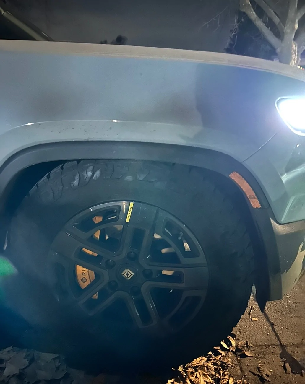

This was my front wheel back in 2024. I showed the service center this picture, and said the height setting was on Standard. I got my front dampers and other components, eg jounce lines, replaced.

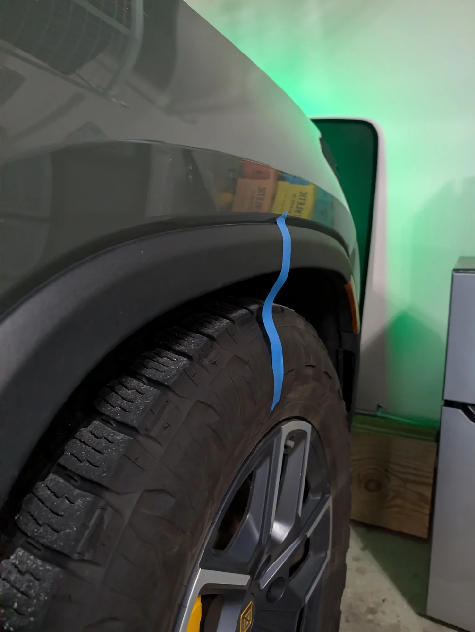

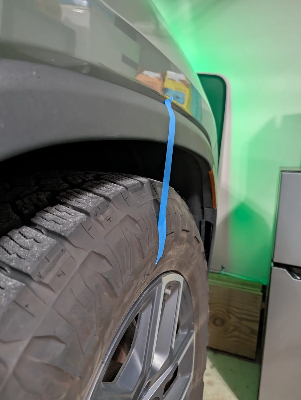

Tried the tape method overnight. This is a 9 hour change in an insulated garage. It dawned on me I probably should do all 4 wheels tonight so I can show the rears don't do the same thing so they can't say this is a temperature issue or something that would affect all 4 wheels

Ok so I threw tape on all 4 wheels to ensure it's truly a front suspension issue and not a temperature drop as all 4 corners should be impacted if it's just the air springs cooling down and PV=nRT causing the drop. 13 hours later front is sagging and rears are still where they were. Not an ambient temp issue.
