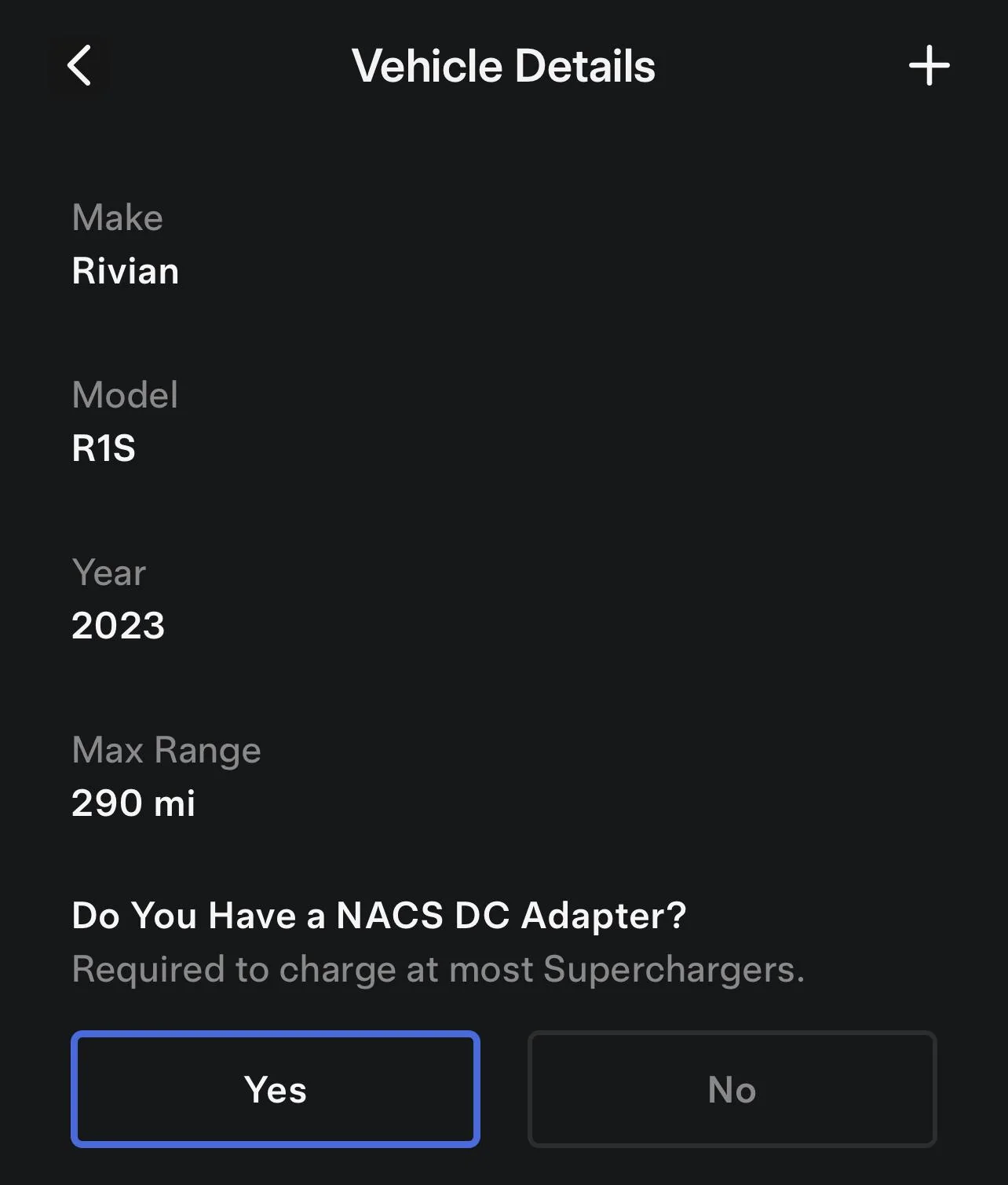

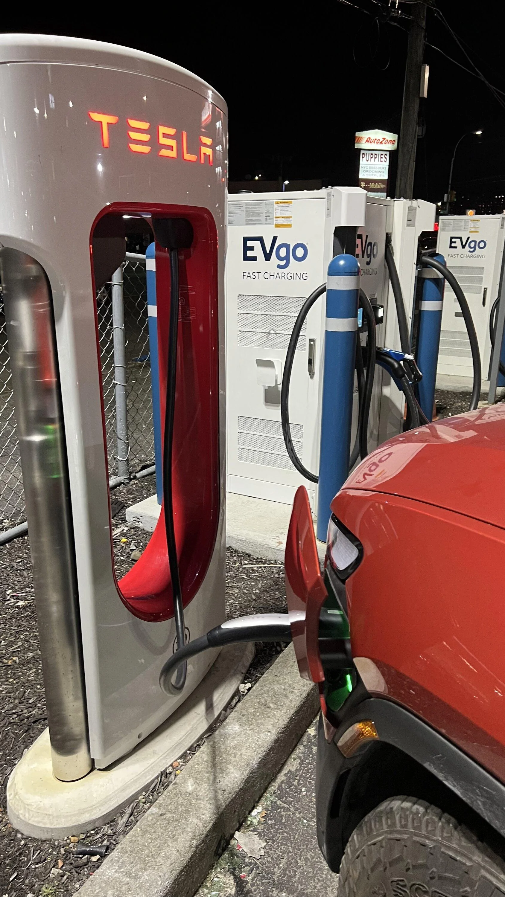

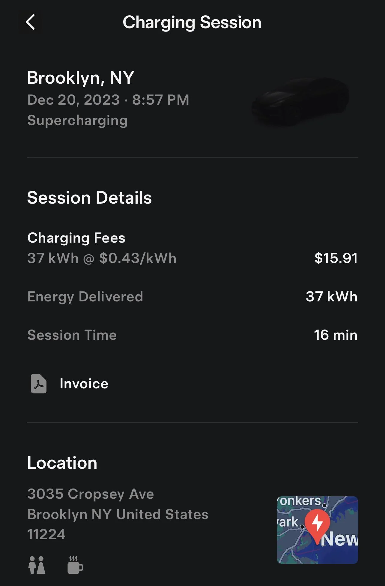

Yeah, I’ve been charging my my Rivian on Tesla superchargers for months now. Here’s a picture from December. I also include an image of the session details.
Rivian R1T R1S FYI: Tesla Supercharges will not work with Rivians until officially announced as compatible. IMG_4044
Rivian R1T R1S FYI: Tesla Supercharges will not work with Rivians until officially announced as compatible. IMG_5064
Only ones with a magic dock. Not all the ones open to Ford now.
They do If you have your own NACS adapter.
You just fill in the vehicle information in the Tesla app. Otherwise, the app will only let you go to magic dock, equipped stations.
Can’t wait till it just works with out the Tesla app.
I'm confused (which can happen very easily). Are you suggesting that all you need is an adapter and the Tesla app to use any Tesla Supercharging station? We keep reading how we can (1) only use Rivian supplied adapters and (2) have to have an sw update.
Tesla blanket added the configuration but it doesn't work for anyone but Ford vehicles today. You can't activate a charge on your Rivian even if you had the Ford adapter today.
Rivians will not work until they are officially launched on the Supercharger network regardless of you having an adapter. There is an authorization process that validates the type of vehicle at the dispenser prior to the start of charging. (excluding Magicdock sites)
It might look like you can do this in the Tesla app. You cannot. :(
Hence my confusion. The consensus appears to be what you're saying but @baker appears to be indicating otherwise. Not trying to muddy the waters-just looking for clarification from @baker. Cheers.
