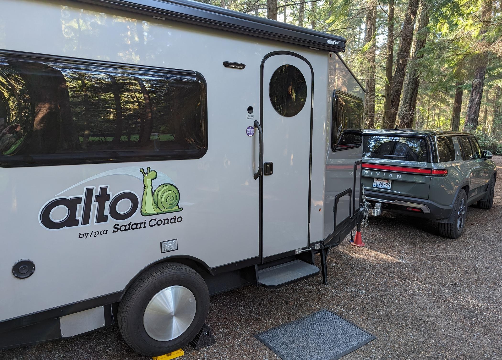

And we just took a fourth trip towing the Safari Condo Alto A2124 [...] we did a 152.7 mile round-trip that used 74% of the battery. The R1S claims 1.5 mi/kWh.
Conditions: dry, with temperatures in the 50s. Some light winds. Fairly flat for the PNW. We went just over 60mph on the highway which was most of the trip; but even though traffic was good it says our average speed was 45mph...I'm not sure if it's counting stoplights.
We just took a fifth trip. This one was 180 miles under similar conditions to above (a few degrees warmer, a little more traffic), and similar results: 1.5 mi/kWh. The Rivian says our expected towing range at 100% charge is 194 miles.
