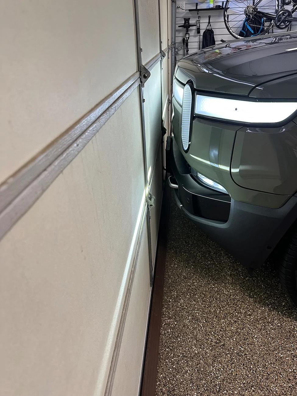

I have a very tight garage, I have found with a very light touch I can move my R1S in very small increments. Sometimes it takes a beat to move so patients helps.
Try practicing in your driveway, I think you will be surprised at how little you can get it to creep. I’m usually in all purpose pulling into the garage.
Picture with garage door closed.

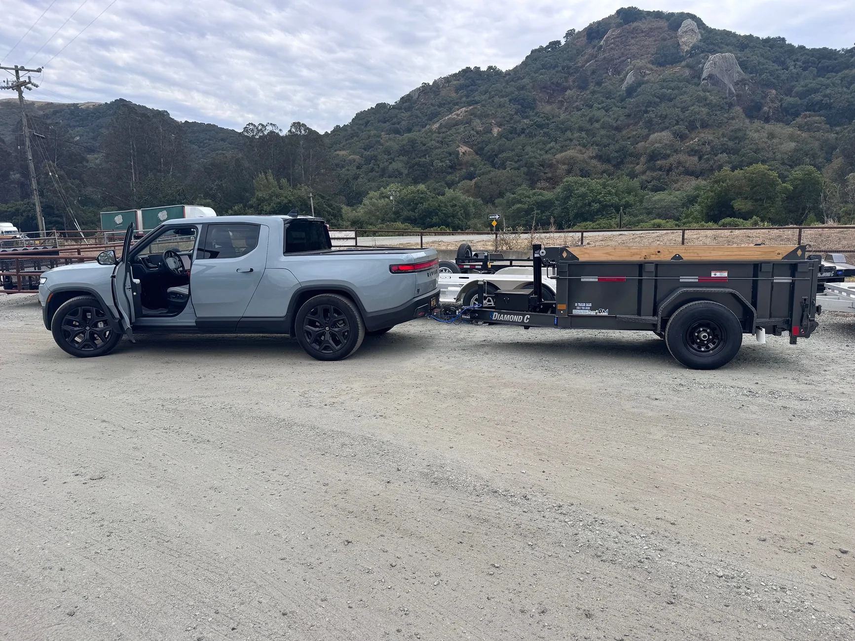

Here’s probably the dumbest question posted here so far so feel free to flame away!
Is there a technique or setting I can change to let me move the truck an inch or two smoothly? When I’m backing up to hook up a trailer, I find that it’s very challenging to move the truck a tiny amount smoothly and slowly to get it in just the right position to hook up. Maybe I’m just a towing dummy but it would be interesting to know if there are tricks you use. Thanks!
So even if this is the dumbest question posted here, I have it too so thanks for taking the heat. I have what’s called an essential tremor in my hands and feet. I shake like a chihuahua which makes that last 2 inches of backing my R1T tricky and stressful To connect our jetski trailer or dump trailer. I almost wish I could just monitor the brake pedal to ease back to the hitch like old schoo.
