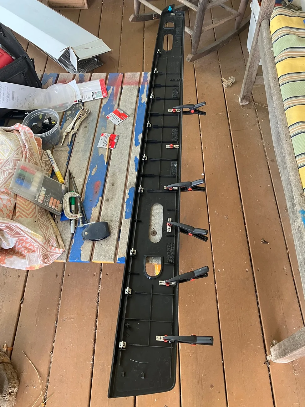

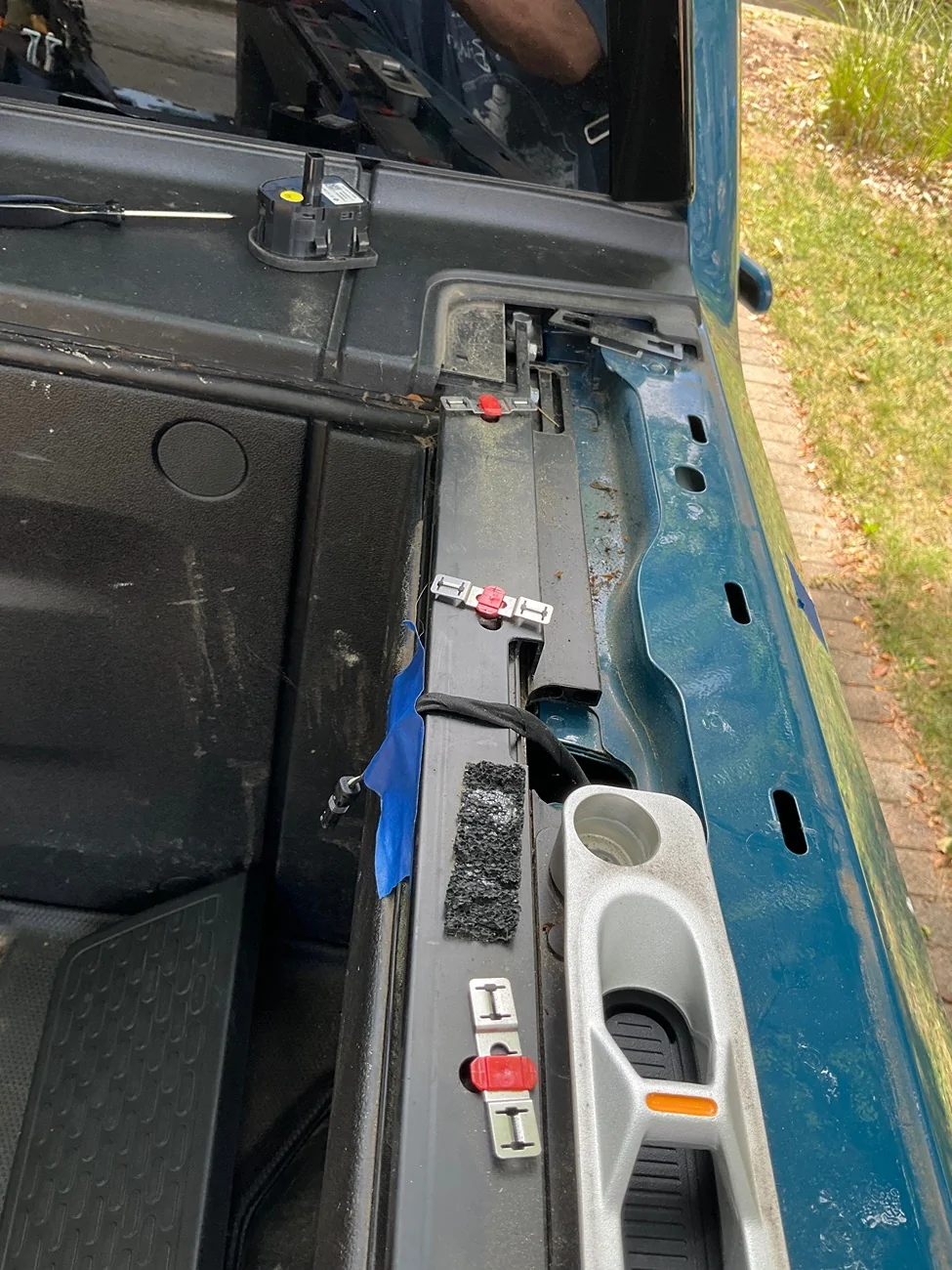

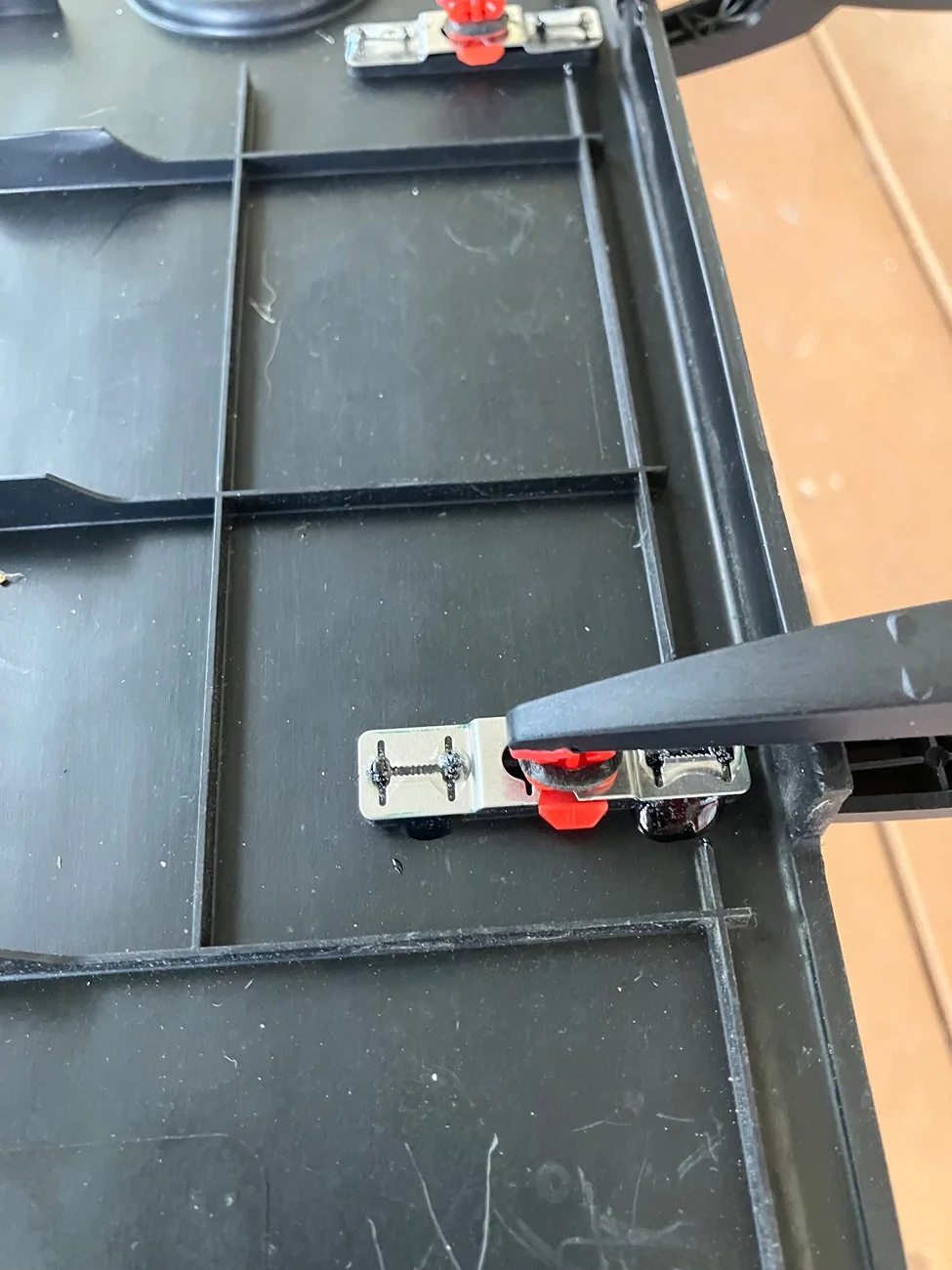

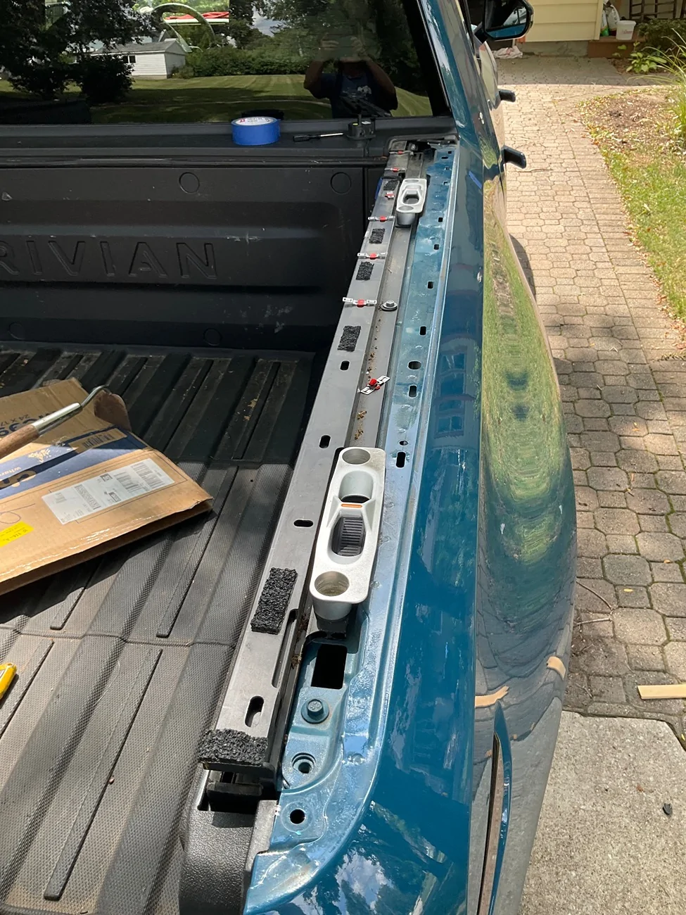

I had almost this exact situation when a push broom fell off the rack in my garage. My PDR guy, Maquette, only needed the top trim removed. But I had a few other dents so I ended up removing all three top trims on the bed. The trims remove fairly easily with a rigid plastic putty knife and some nimble fingers. The only real problem is that most or all of a small clip will pull loose from the trim. You can purchase the top trims on ebay. When I looked, they were about $300 each. so I decided to try to re-attach the clips . Of course, i had lost two of them but rivian sent some to me. If you need any, I think that i have a couple left and would be glad to send them to you. I reattached the clips with some JB Weld. Assembly was fairly easy. I will try to attach some photos. Also, I think that i made some posts in thi previously, so you may search for them. Good luck. Be patient.
