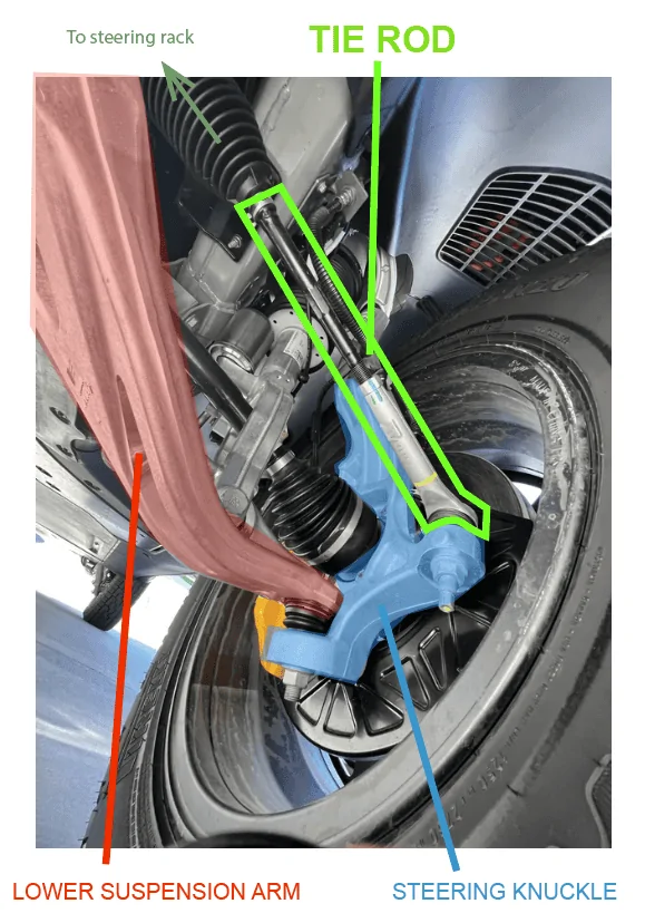

The tie rod is an adjustable-length link in the steering. Without it, you can't turn the wheel. With incorrect length set, you can't track straight while steering wheel is dead center. It's an intentionally weak link in the system, like an electrical fuse. A tie rod that is too strong, could transfer force to and cause failure in other less accessible and/or more expensive components.
This guy has nailed it....you don't need a beefier TRE, you may very well like to have access to a lower cost (than OEM) TRE for an on-the-trail replacement though...
I am NOT a mechanical engineer (or better yet not a Mechanic) but couldn't you design the long straight "rod" that is the "weak point" to be detachable at BOTH ends so the week link is easily field servicable? I understand for alignment you probably only want adjustment on one end of it, but could instead of the interior side being a bigger piece with more parts, just "unpin/unscrew" long straight "rod" replace and be on your way. For an offroad vehicle the weak link should be cheap and easy to replace in the mud. Not a $500 part that is less than simple (not saying exactly difficult, just involved)
