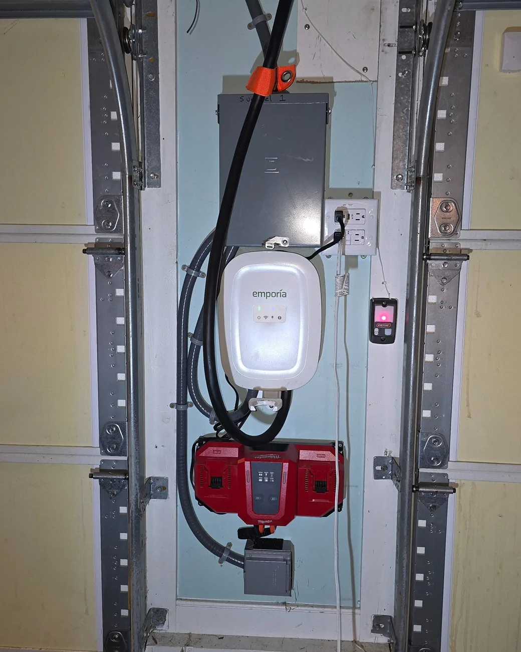

Here is what I did.
Rivian R1T R1S Home charging plan 1000003068
The subpanel is on the top.
The EVSE is directly under it.
And then under that is the Milwaukee Tool Super Charger, plugged into the 120V outlet to the right of the subpanel.
And below the Super Charger is the 14-50 outlet.
Do the subpanel!

Nice looking rig! I have two garage doors, but the spacing between them would be too tight to do something like that.
Between the doors is a good location for reaching most of the garage, and the driveway in case I need to charge there (I have a few times). The problem for this location is the bay to the right of the charger (the left bay when standing in the driveway and looking at the house) for vehicles with the charging port where Rivian put it in the R1.
The R1 charging port is on the driver front corner (as you know) so the EVSE cord barely reaches when I park in the left bay. I have to drape it across the truck, which isn't viable for daily use. I got an extension cord from A2Z and routed the longer cord through hooks in the ceiling. Now it reaches just fine but is a little janky with the routing.
I would park in the right bay (like I did with the Mach-e), but it is harder to fit over there because of the position of the water heater in front of that space. The R1 fits (barely) but then I cannot walk behind the truck with the door closed, which is a huge PIA for my wife when she parks in the left bay.
First world problems. LOL.
Our garage is JUST deep enough that I can walk around the back of the R1T when the doors are closed. Having to navigate dangling cords would be problematic. I got the charger / splitter used for both vehicles center / rear in the garage, with the charging cord to the Rivian along the foundation wall to the left side of the truck (stays out of the way), and have a cord hanger near my rig for the Model Y cord. It reaches the rear charging port on the Tesla. But I am always looking for ways to improve on the layout...
I think a ceiling mount in the center of the garage would be best except, well, it is on the ceiling.
If I get a second EVSE, putting both in the center of the garage on the ceiling may be what I do. The drawback then is reaching the cord into the driveway...
Right now we are a one BEV household. My wife has so far refused to consider a BEV. So my setup is probably the best location. I may see if I can replace the cord with a longer one instead of using an extension.
