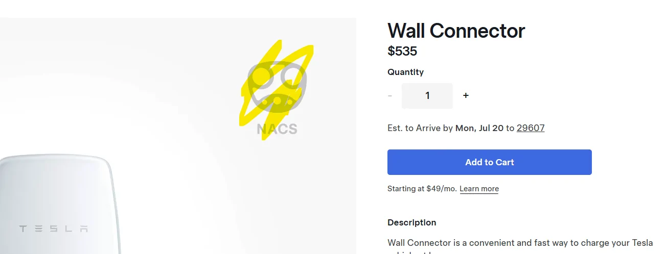

Home Wall Charger
R2D2TOO
Bill
Apr 1, 2025
196
254
4Runner, Stingray
$535 for NACS only
That appears to be the Tesla only version. The description reads:
Description
Wall Connector is a convenient and fast way to charge your Tesla vehicle at home.
Features
  • Up to 44 mi of range added per hour at 11.5 kW / 48 amp output depending on vehicle1
  • Auto-sensing handle to open charge port
  • Monitor and manage your charging schedule and usage from the Tesla app
  • Wi-Fi connectivity for over-the-air updates, remote diagnostics and access controls
  • Versatile indoor / outdoor design
  • Minimize install costs and maximize charging speed using Power Management features
  • 24-foot cable length
  • Four-year warranty for residential use
No mention of non-Tesla support. The Universal veriosn spells it out:
Description
Universal Wall Connector is a convenient and fast way to charge your electric vehicle at home, whether a Tesla or non-Tesla.
Description
Features
Description
No, it's NACS. The universal wall connector has a built in J1772 adapter and a NACS plug in case you have both types of vehicles.

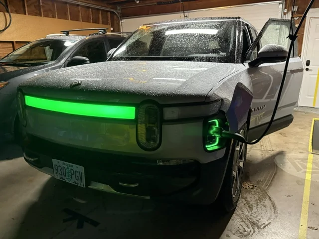

SourJellybeans
Jul 15, 2026
Portland
Tesla Model 3
For AC, there’s not really “Tesla only”. I charged an R1S for a month on a 2022 era Tesla mobile connector on a 14-30 outlet using a cheap (~$40) Tesla(NACS) to J1772 adapter, and it worked fine. When you’re talking J1772/J3400/NACS/Tesla connector for AC charging, they’re all the same.
Also, FWIW, if you keep your eyes peeled, you can get used EVSEs for cheap. I found a Gen3 Tesla Wall Connector for $75 at a thrift store and it works perfectly, even added it to the Tesla app just fine. All it needed was $4 in hex bolts that were missing. Re-wired my 14-30 outlet to it and during commissioning it prompts you to select the max amperage.

SourJellybeans
Jul 15, 2026
Portland
Tesla Model 3
The older Tesla chargers that were made before NACS was the standard are not compatible with Rivians.
What are you considering that? My Tesla mobile connector was included with my March 2022 Model 3, and NACS wasn't a standard until March 2023. Tesla didn't even announce NACS until November 11, 2022, so my mobile connector was clearly from before NACS. And yet, here I am in March 2025 charging a Gen 1 R1S on that mobile connector:

Jeremy3292
Jeremy
Apr 27, 2026
1,224
2,226
South Carolina
R2
You’re not using NACS. You’re using a J1772 adapter. Gen 2 mobile and wall connectors don’t work natively on NACS. R2 is NACS.
