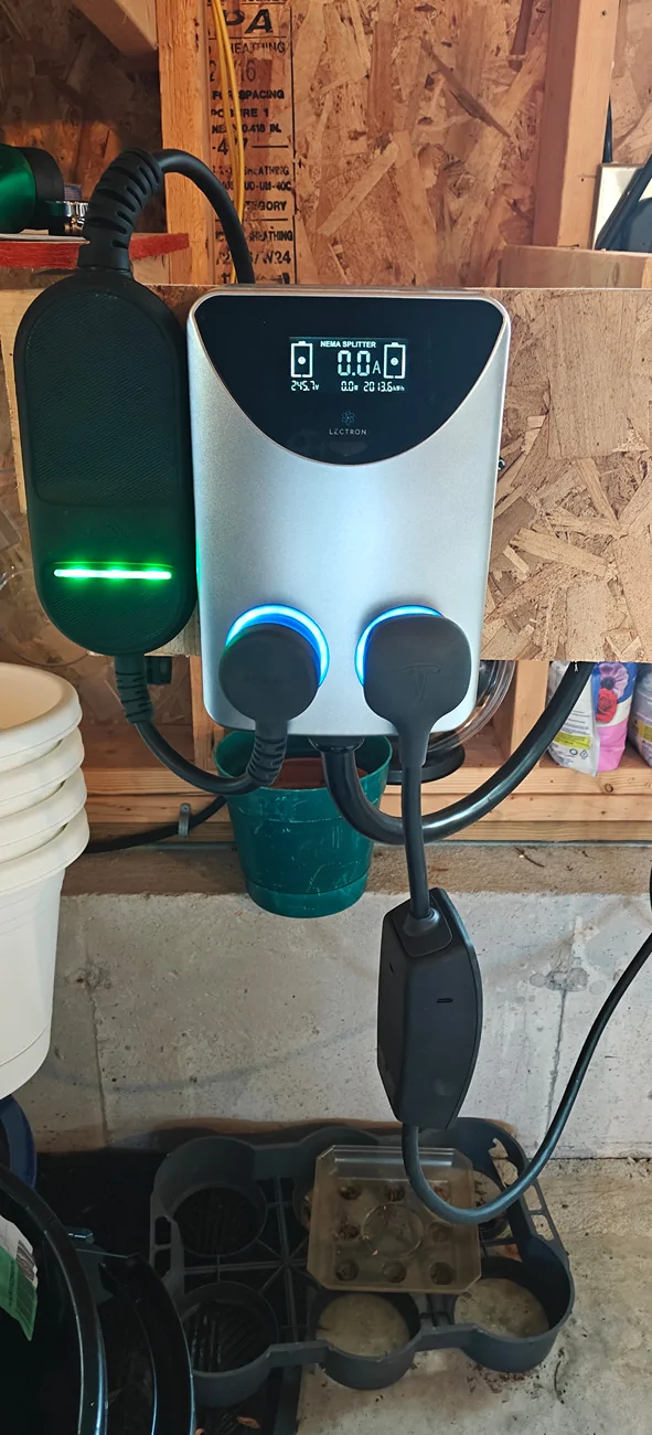

Hello!
Answers to the above questions.
This is a photo the NEMA splitter I am using with the Rivian L2 on the A side and the Tesla L2 on the B side. The splitter plugs into the NEMA 14-50 socket on the wall behind. This wiring (splitter to outlet) never gets hot, nor does the Rivian A side when in use.
The NEMA 14-50 plug was selected and installed by an electician based on the Rivian L2 home charging requirements guide (attached).
I bought this particular splitter because it has an overload circuit breaker built into it.
The heat comes from the plug going from the splitter to the Tesla L2 charger, the charger, of itself, and the cable going from the charger to the car when plugged in. Very warm to the touch; more so than I was expecting. Consistent heat through the whole Tesla charging assembly.
The maximum amperage is 32amps. Both vehicles are set to 32amps through their respective charging settings. Only one circuit can charge at any given time; the splitter will not allow for both to charge at once.
The garage is not heated / cooled and the ambient temperature is around 80 degrees at the moment.
So... is it that the Tesla L2 charger is just... getting overworked? The Rivian unit never gets warm.

IIRC Tesla uses higher temperature rated cabling than is typical, and takes advantage of it based on wire size. It will run hotter in identical situations. As long as it's not so hot that you can't handle the cable anymore, you're probably okay.

Two issues that i see. First, the tesla charger is dangling from the plug. If that's the normal position, the connection with the plug will loosen over time as you've reported. I recommend going on amazon and getting a holder for it so the plug is not supporting the weight of the unit.
Second, the rivian unit is right next to the splitter. Is there heat coming from the splitter that warms up the Rivian unit? I'd also be concerned that the bend angle of those wires going into the Rivian was too extreme. Over time that can cause wires to loosen even though there is strain relief there. Loose wires = heat.
Last time I used my Rivian unit it was in the winter, but it was cold to the touch even after charging for several hours.
Are you getting errors or reduced charging? What is the actual temperature taken with a laser thermometer?

Your setup looks fine. As another person said, supporting the Tesla charger would be good to keep pigtail from coming loose (although they fit pretty tight), but it's not an issue as is. The Rivian cable is cooler than Tesla because Rivian has 8 guage wire, while Tesla uses 10 guage (Less resistance) which is the minimum size for 32 amps and will warm up as it runs for a few hours. What you describe sounds normal, but the question is how warm is warm for Tesla. Do you have a way to check the temperature of the components? 100 degrees is fine. 120 degrees maybe hotter than it should be. Since the entire Tesla system is warm, my guess is its normal heat and you are pushing the components at their high end. Drop the Tesla side to 24 amps and it should be a lot cooler.

Have you tried swapping A and B plug between the Rivian and Tesla chargers? If A gets warm still with the Tesla charger, then you know for sure that it's the charger, and not the splitter B problem. Conversely, if the Rivian charger gets hot plugged into B, then you know its the splitter B issue.
