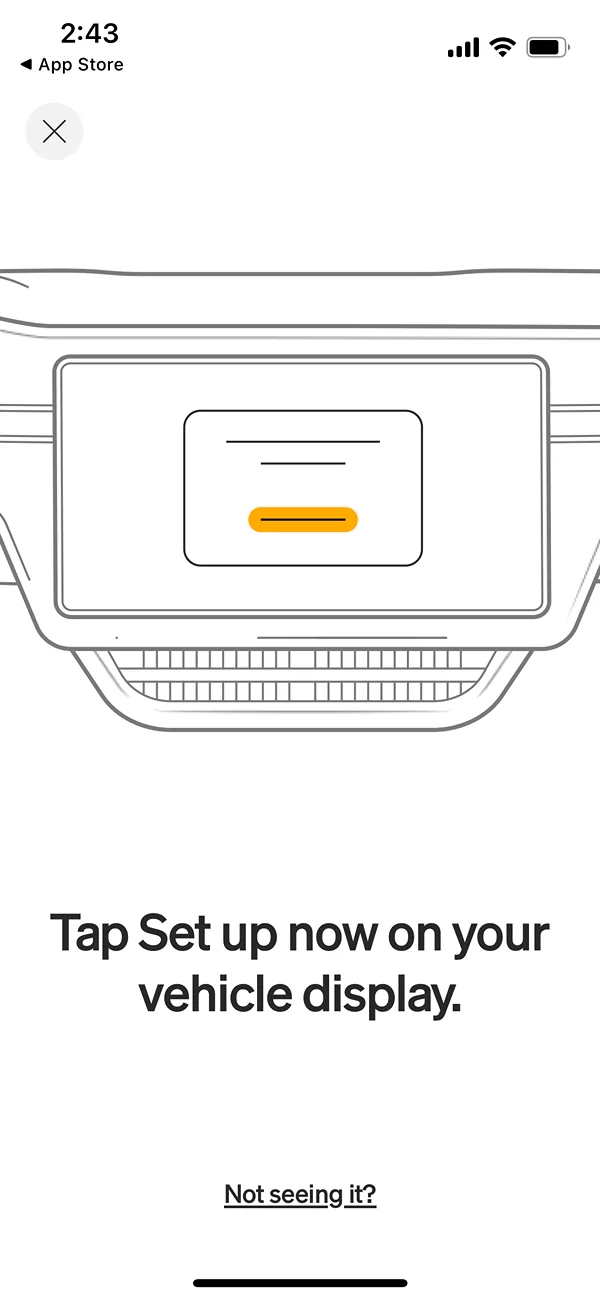

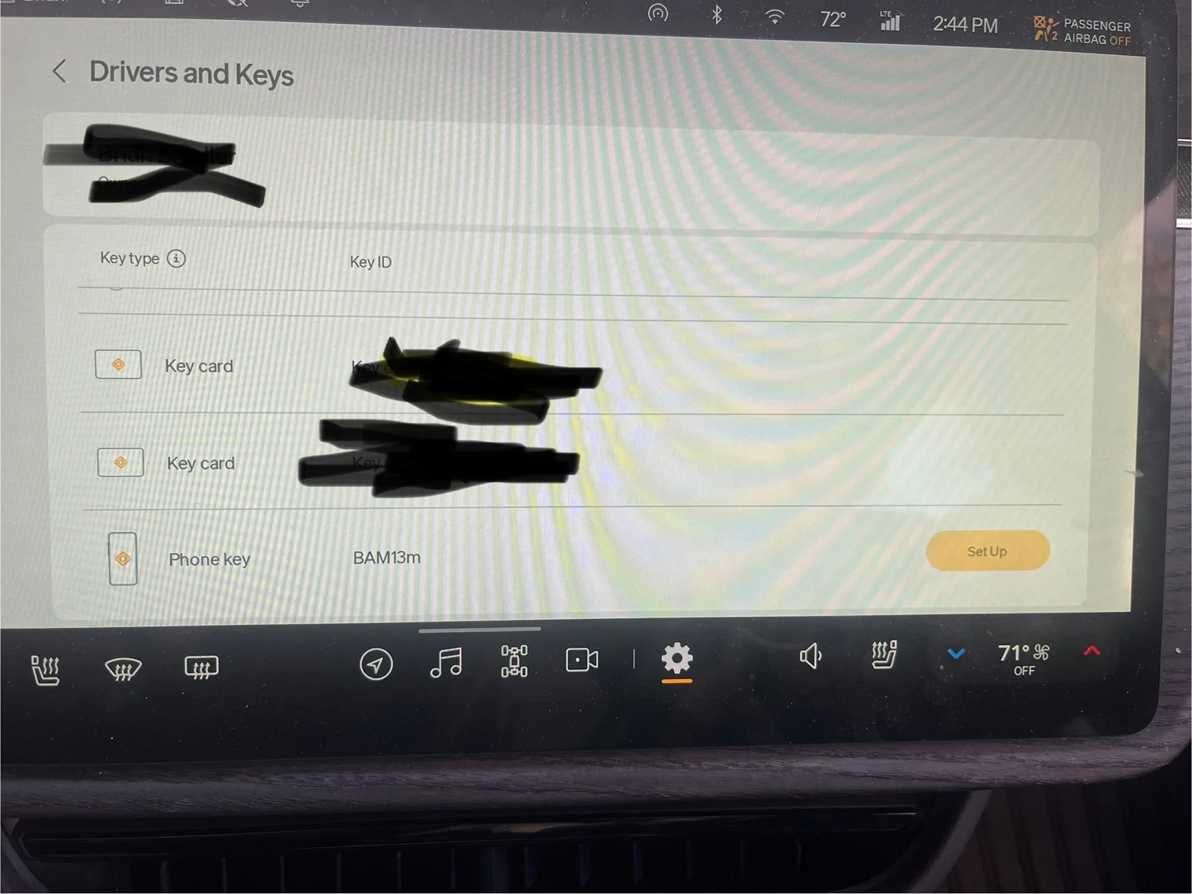

I really appreciate your idea and mentioning this. I did leave that step off my list. I tried it again to be sure, but unfortunately the vehicle will not pair any phone now (as key) (I've tried multiple phones). It gets stuck at this step and if it's not clear in the picture, the Set Up button is "greyed" out and cannot be pressed.
UPDATE: After a few hours I checked and I could then press the Setup button. It then adds it and the phone app and vehicle thinks the phone is added as a key. However, it does not work as a key to start. I still have to use the key card or the FOB to start the vehicle. I think the Rivian phone support was accurate that the module was damaged.
