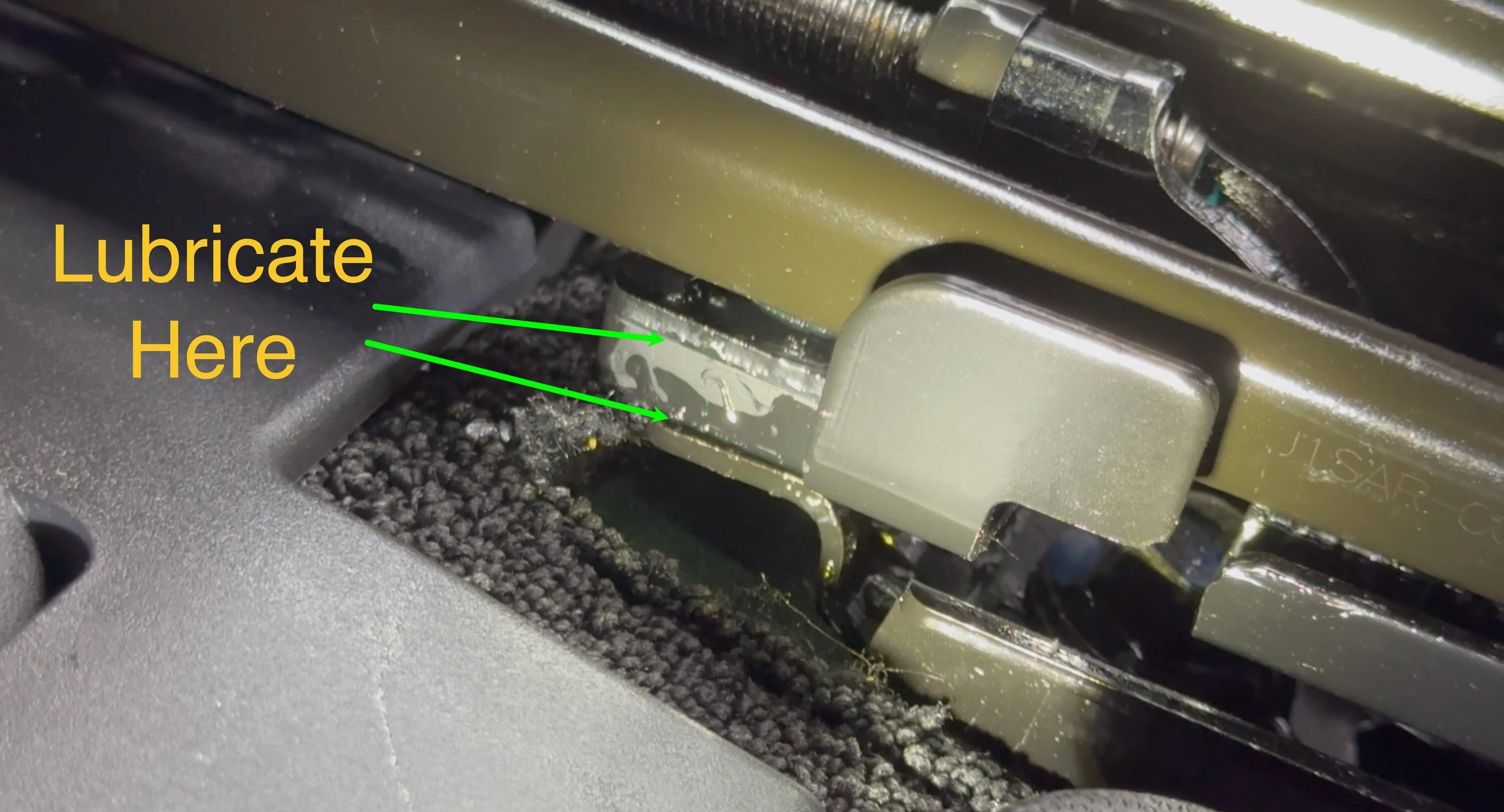

Does this sound like the same ticking/rattling?
I brought it to the Council Bluffs (Omaha) service center and - despite the tech telling me on the ride along that he had never heard that noise before - they told me that this noise is not any worse than any of their other vehicles interior rattles and it is "in spec".
My passenger seat was ticking away when unoccupied. SC re-tourqed bolts but it didn't help. Investigated on my own and found the sound was coming from what appears to be a metal/rubber/metal damper or bushing under the seat. I applied some WURTH HHS Plus lubricant and the noise has been gone for weeks without reoccuring. I'm not a materials engineer, but I'd suggest against WD-40 as that's more of a cleaner than a lubricant. You probably want something plastic/rubber safe and I've always found the WURTH HHS to work well (again, just what I use, not sure if it's the "best"). Hope it helps!
Example and how to:
