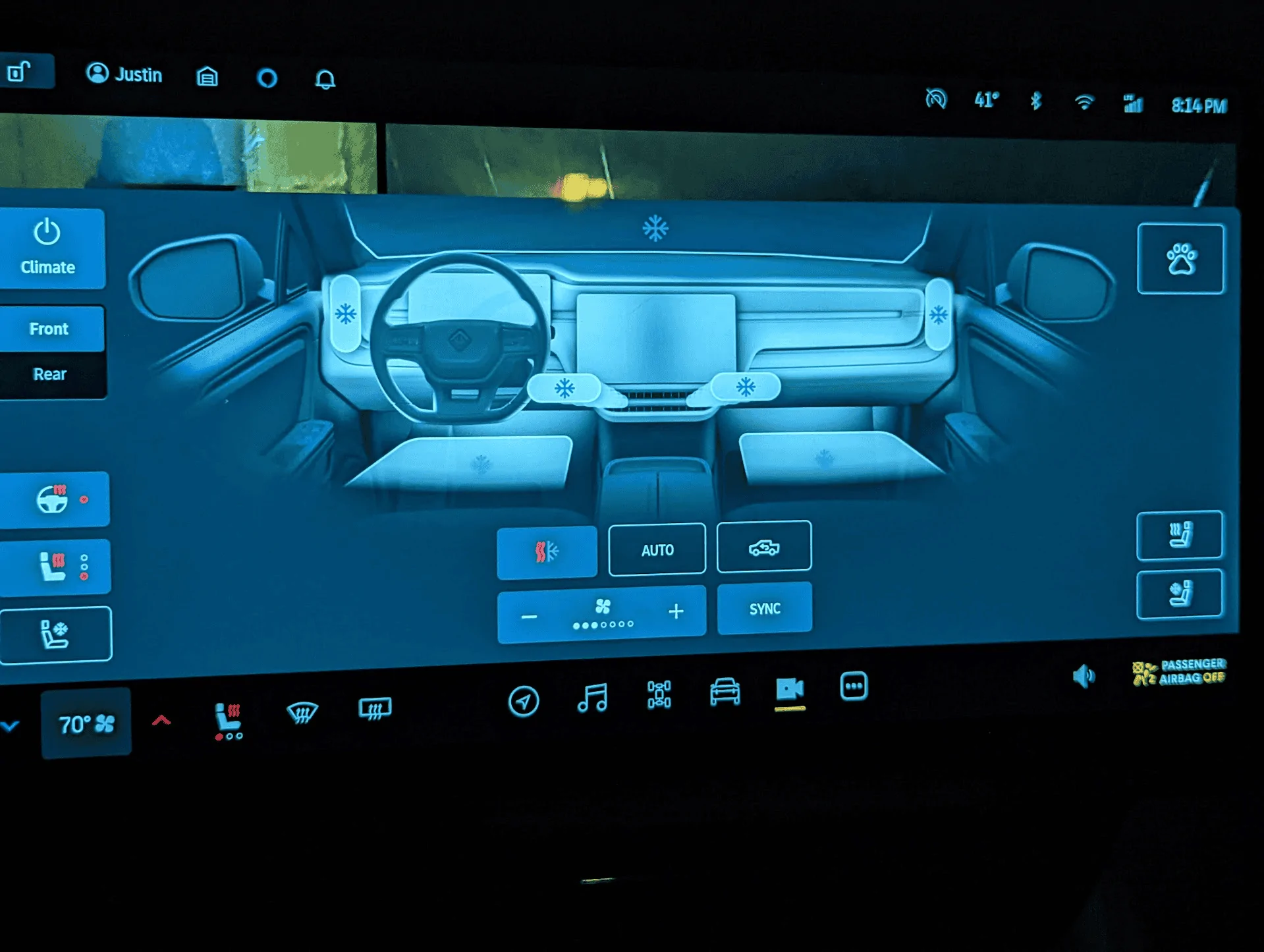

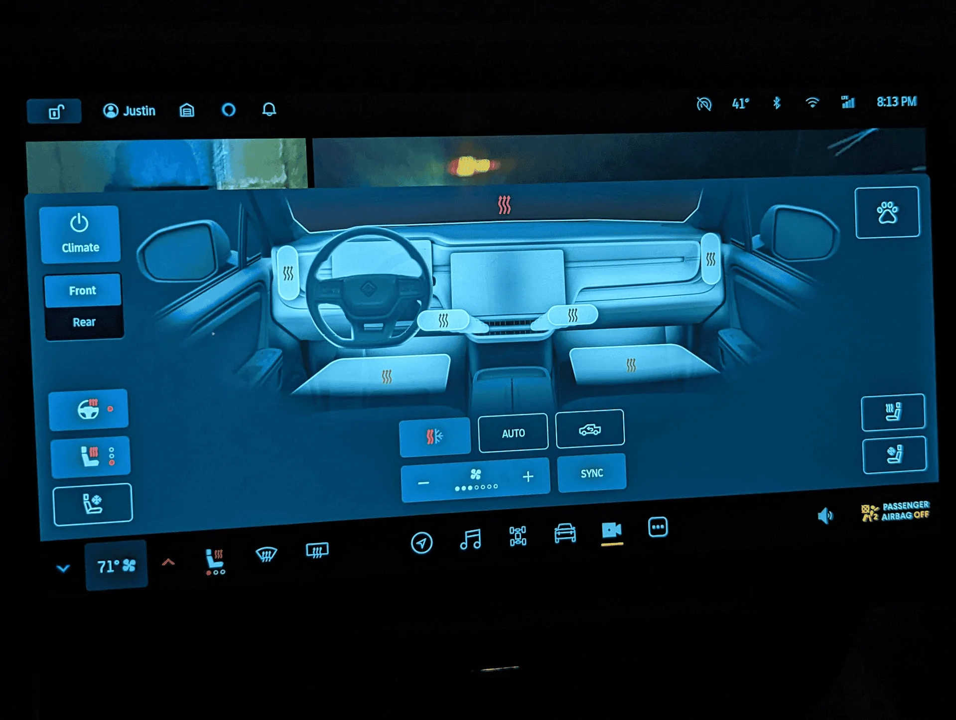

User Interface:
I find the user interface for the HVAC a bit confusing and counterintuitive at times. See the two images below. In the first, I show that the interior temp was set to 71 degrees and the vents show red heating lines. In the other, I show the interior temp set to 70 degrees and the vents switch to snowflakes. It was 41 degrees outside and it definitely was not running the AC. Are these displays just based on the temperature setting? Would seem more intuitive to me if they were based on what the HVAC system is actually doing at that point.
