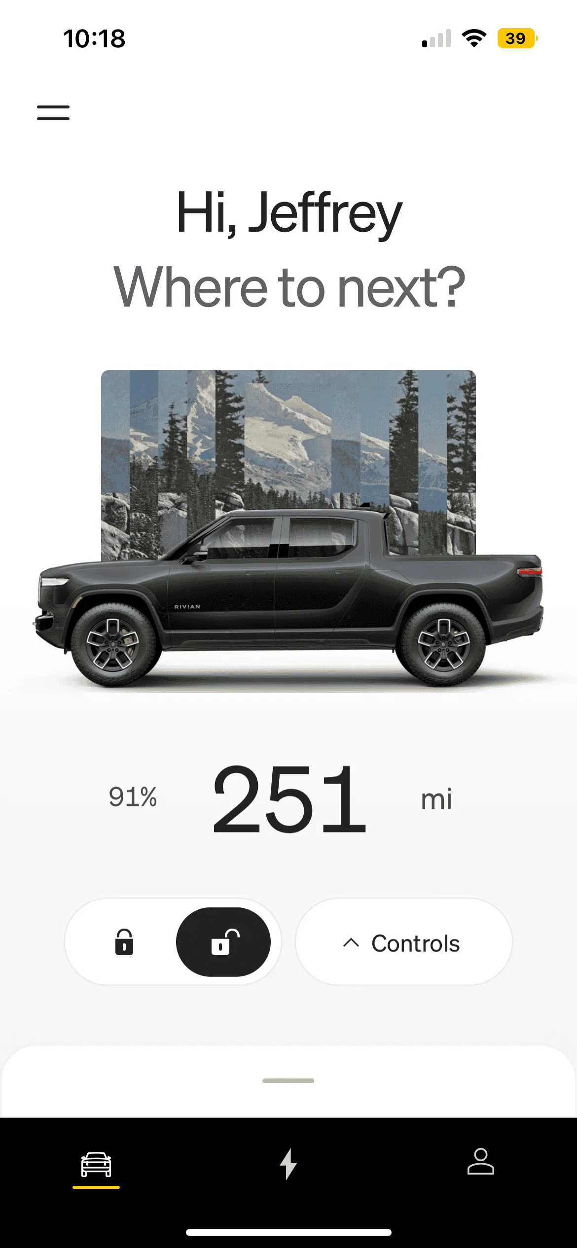

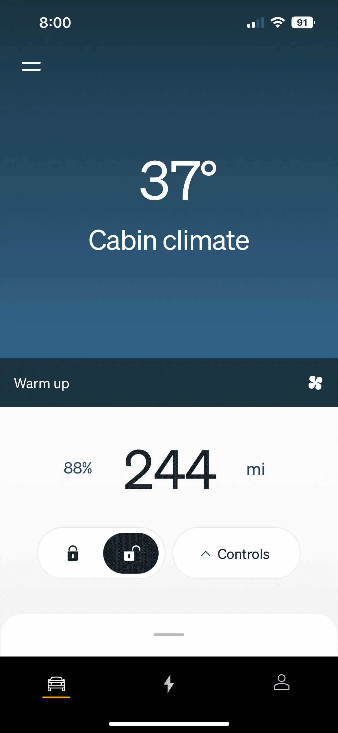

First pic is this morning. 88%. Second pic is night before, 91%, so only 10 hours earlier. Yeah it' sa little cold, but I really hope it doesn't lose 3% every 10 - 12 hours. Imagine going camping for 2 nights, that would be 12% just sitting there.

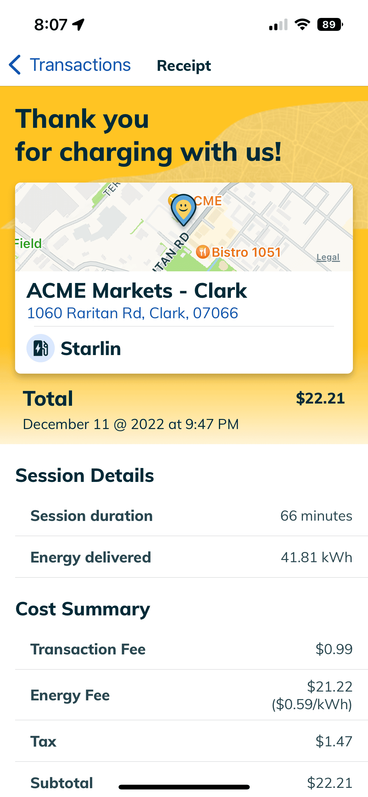

Haven't gotten wall charger installed yet and the only "fast" charger near me is an EVGO spot, which has 4 200kwh chargers. Great, I thought. I tried 3 of them and the 'best' one delivered the results in the last pick, which is about 40kwh. I pulled in with 60%, left with 95% (I charged to 95% b/c it will be a little while before wall charger is ready).
Any thoughts on either? I called the EVGO customer support and of course they just sounded like the teacher in The Peanuts.

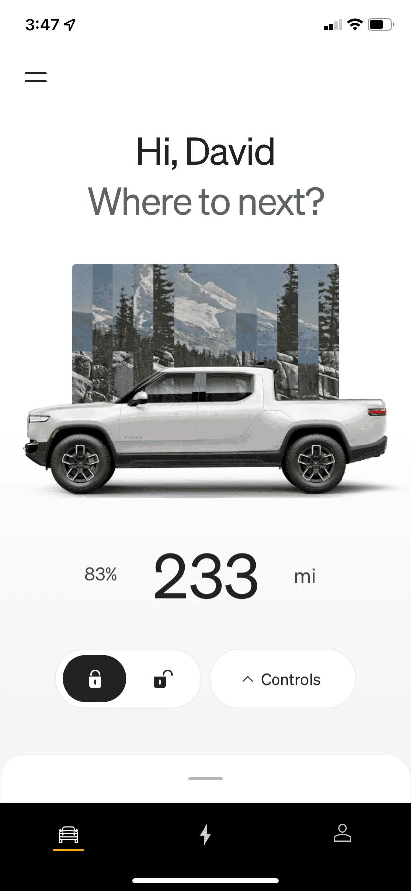

I have owned my R1T exactly one month as of today. I noticed some vampire drain but never documented the loss until yesterday.
I plugged in and charged to 85% yesterday. It’s been sitting idle in my carport and today I decided to document the vampire drain.
In just over 24 hours I have lost 7 miles and 2% of my battery. Ouch!!! This amount of energy loss is unacceptable in my book.
