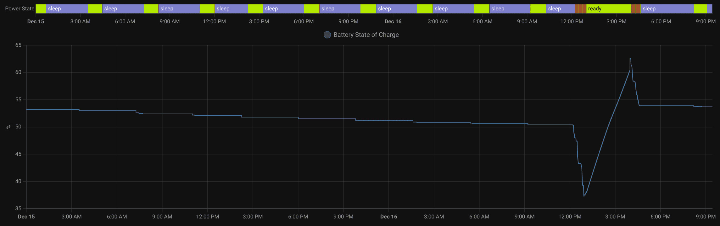

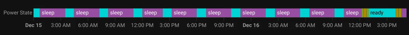

I think there's certainly opportunity for Rivian to improve this, it seems to wake every 3-4 hrs and seems to stay in that state for about an hour each time...
That is a lot of overly long wake cycles for a vehicle not going anywhere... no wonder 24hr loss is so high.
Where are you seeing this data?
Surely the engineers know this....where are you getting this data from?

^ from the poster above me- his post# 17
