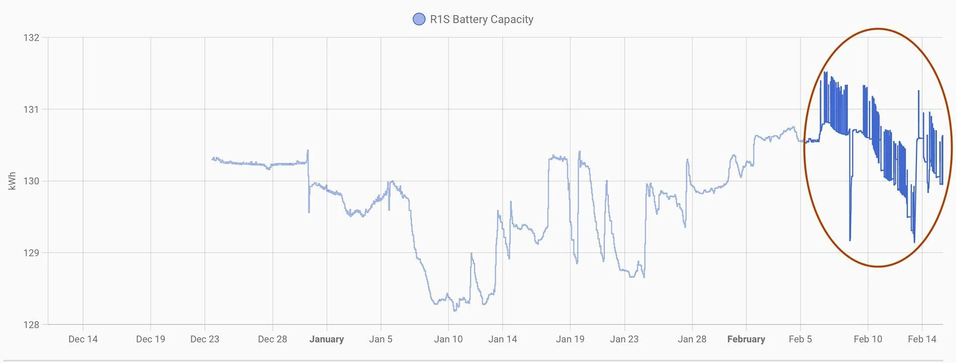

Hello Everyone, I hooked up Home Assistant to my R1S and have been collecting data for the past few months. I noticed battery capacity fluctuating over time. Also, I've seen random spikes (see the pic). I was wondering what these spikes represent? I noticed these during charging (home) as well as idle states (not charging).
Thanks!

These spikes have started with firmware 2024.47.01 and seem to be more calculation anomalies than anything real. Seeing the exact same. Before that firmware the capacity of my R1T was an almost constant flat line.
Regarding the drop in capacity: it seems to ‘help’ the vehicle show less phantom drain, especially in the first few days. It means that a lower capacity rating shows less drop in SoC, so much so that in many cases the charge % of the vehicle shows little to no loss, when in reality a single battery Gen 1 will always consume a baseline of about 1kWh per day in best case.
It gets reset when charged.

I can’t explain the spikes - I’m not seeing them to anything like the level you are, but if you graph temperature against capacity you should see a loose correlation with that (when accounting for thermal mass etc) at least that’s what I’ve observed on my R1s - i keep on meaning to make a pr over in the ha integration to get the battery temp exposed as an entity - which should show a much tighter correlation with capacity.
Yes battery temp is really missing. Did not see it in the API docs in the underlying GitHub repo that the HA integration uses. If it is simply missing and you have the details, I’d be happy to help with a PR.
Would be great to do an inventory of other missing sensors that might exist in the Rivian API.
Don’t think the spikes correlate to temp though. Had the R1T stored in our garage at a near constant 55-60F over the new year for 40+ days. The moment 2024.47.01 rolled in the spikes started - just like others have seen.
Battery capacity seems to move more with amount of power draw (or lack of) from the HV battery than temp. Aka in the first 12h of parking the car the battery capacity gets derated no matter what the surrounding temps are. More API sensors would be super helpful to validate.

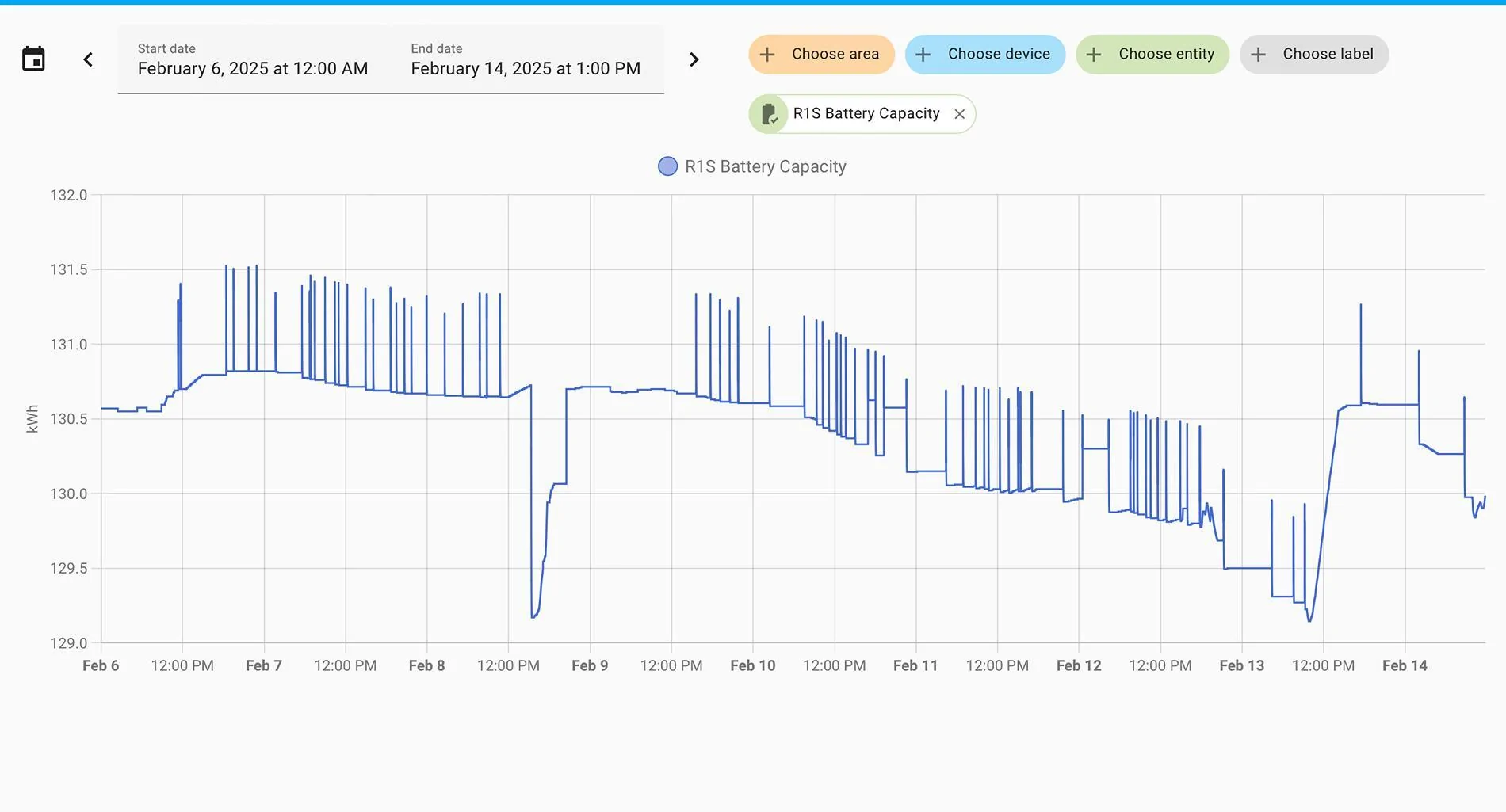

I only had my HA working since late December and have just few months of data to work with. What I observed with these spikes is that they started after the installation of hot fix (2024.51.02) version for me (around Feb 7th or so). My vehicle is always garaged when not in use and similar to yours garage temps are fairly constant and moderate.

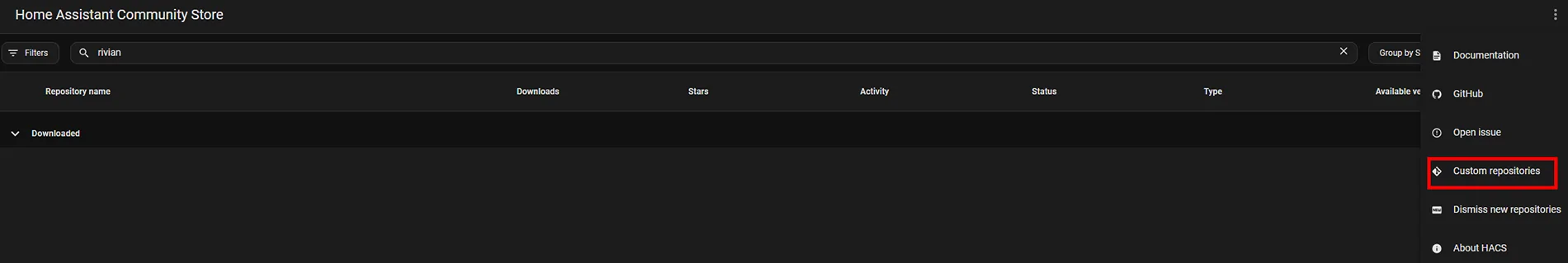

I must be blind, not seeing the Rivian integration when I search HACS...
