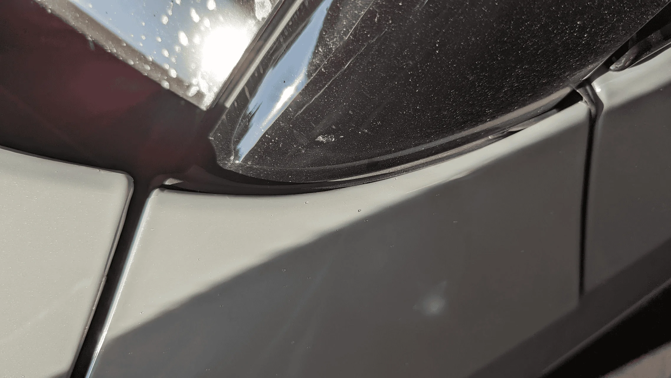

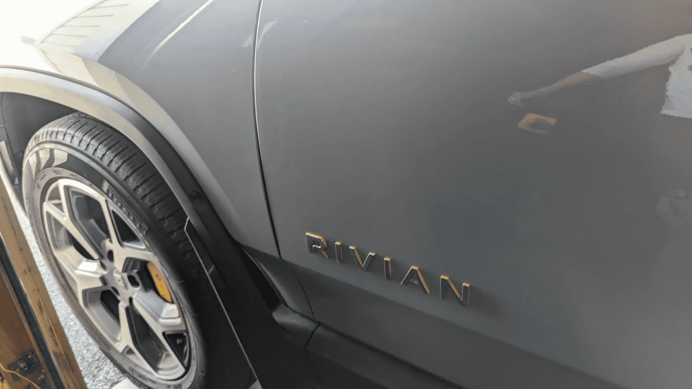

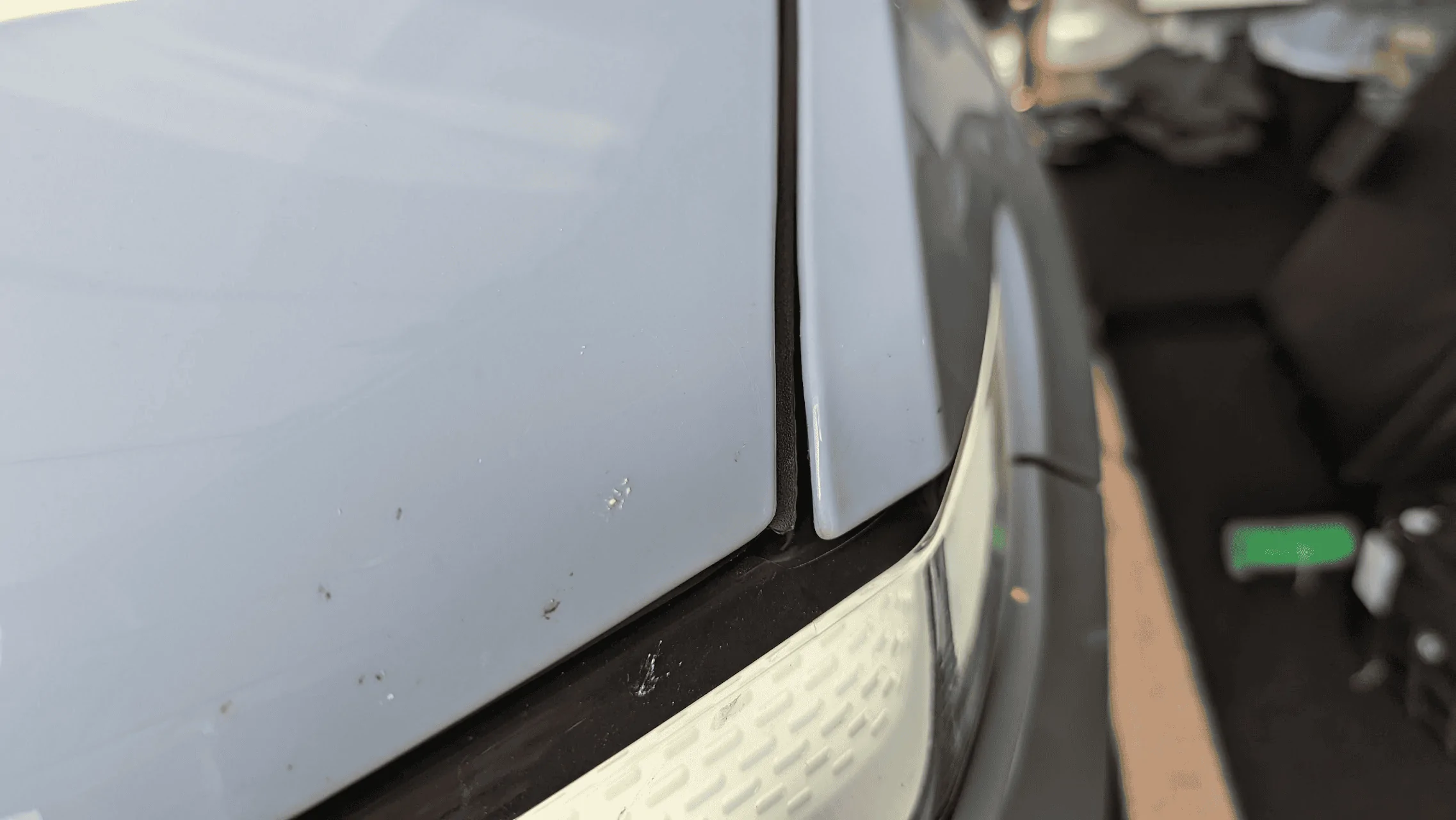

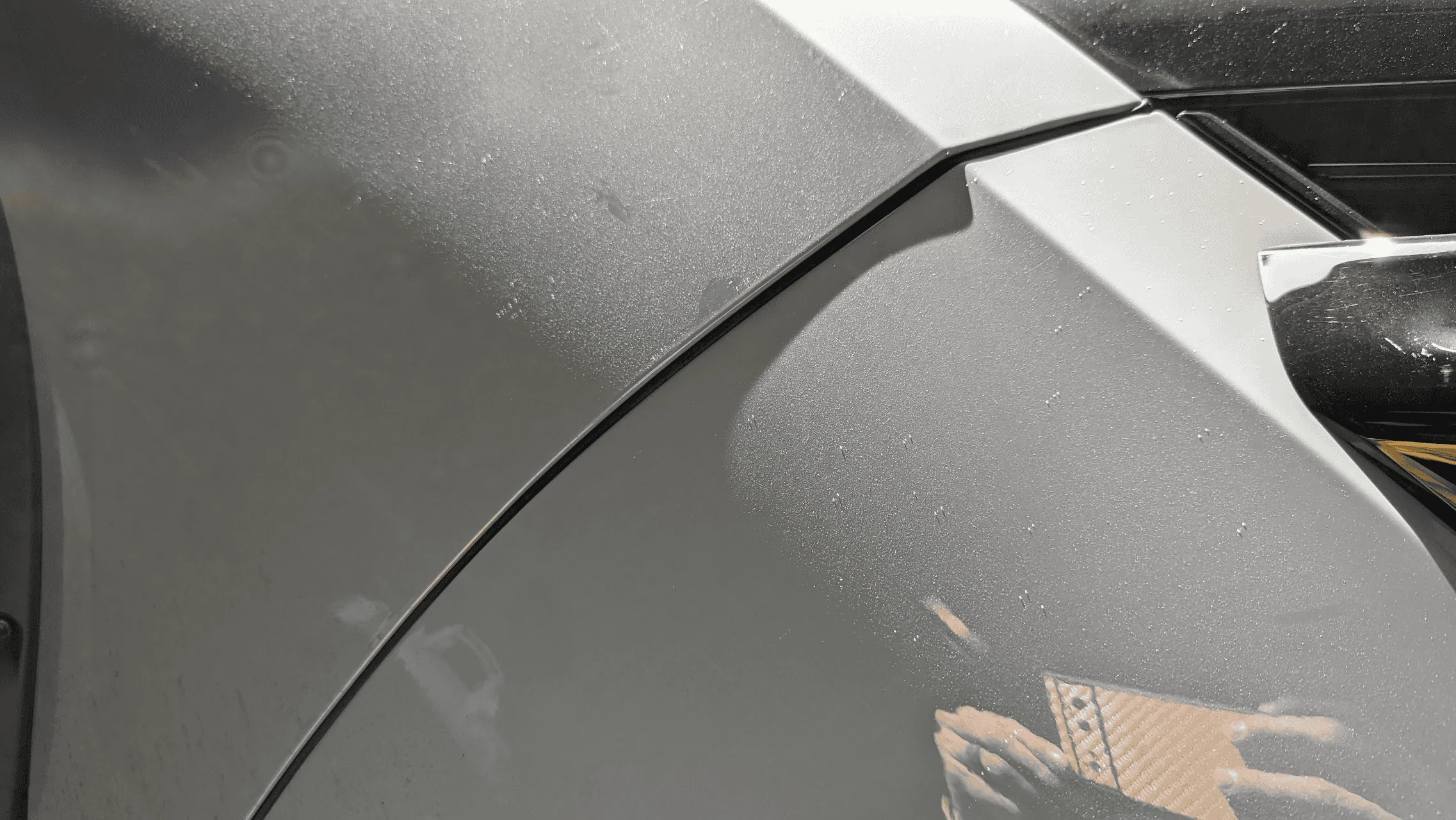

Do you think it's something behind pushing on it? Or just flex from the metal being so thin?
I don't necessarily think the metal is too thin--I think there's something pushing on it from the underside. I could be wrong, about this, but given how this is temperamental and not consistently doing it, I feel like there's some type of gasket (several, likely) that are swelling due to this being non-uniformly heated at times. Because the easiest way for me to 'reset' this is to leave the car back in the garage for a few hours without the influence of direct sunlight and/or air movement.
Oof. That sounds like quite a lot. I'm sorry. ? Let us know how it works out for you / how they treat you there.
I'd be idly curious to see what you mean about the "drivers front quarter panel swelling out" (you mentioned having pictures)?
Again, to emphasize, it doesn't look like this all the time. Right now, it looks completely normal:
This is one instance:
Rivian R1T R1S Interesting comment about tire tread wear 1699037189067
Here's another:

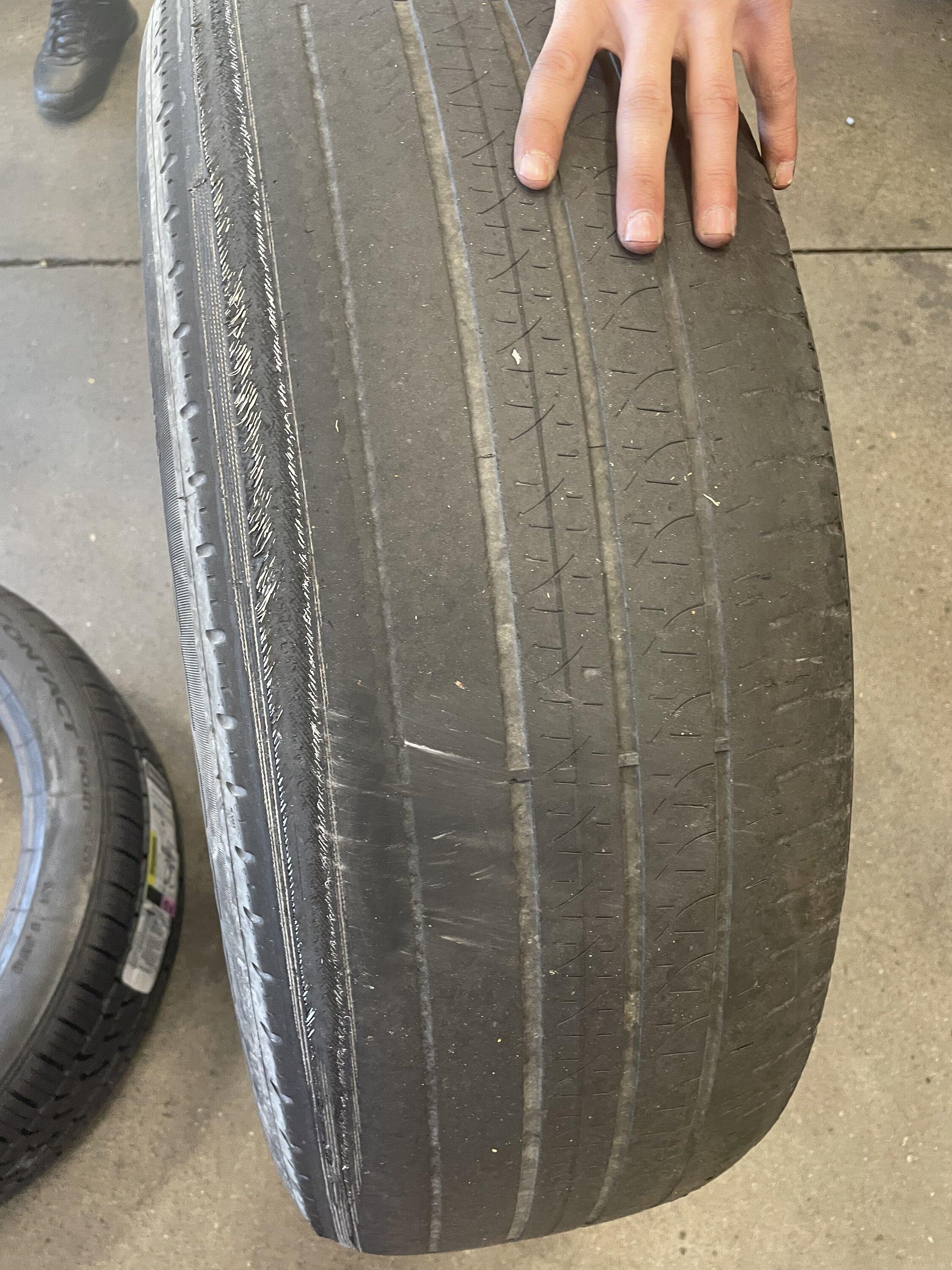

I hope Rivian is paying attention. I really don’t want to spend $2600 on tires every year (29k miles. 2 rotations. 11 months).

Well, they can’t make the vehicle lighter. I guess they could reduce the torque?
I agree those could help but I don’t want that.
I’m more concerned about the toe wear. I’ve done a lot of highway miles and feel the auto “low” adjustment on the highway has been the culprit. Maybe some guidance as to what the vehicle is aligned at for toe and what the other settings will do in contrast.
I’m fine with even tire wear. Even if it’s fast. I completely get that. Taking the inside of the tire to the metal bands when there’s still 5k of tread is no fun.
That and maybe give folks a heads up if projected expected tire ranges of less than 30k miles.
