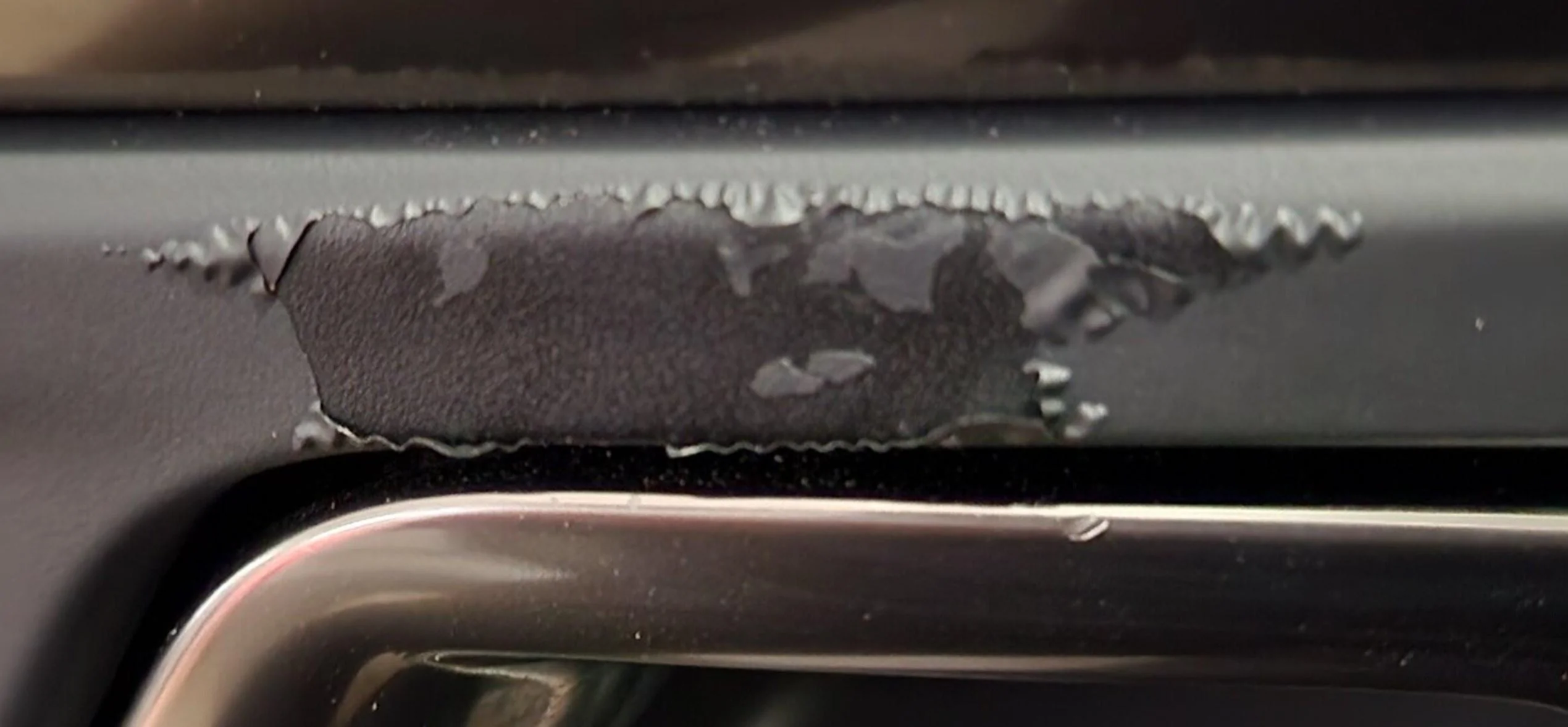

hadn't noticed? how can you not notice that?
Actually not that noticable with the door closed, pretty dark there. The photo with my phone has the flash on and much easier to see. It is much more noticeable with the door open.

There is damage to the handle itself, isn't the handle made of metal? Seems like a pretty serious impact on the handle then.
That is a great observation...a tiny ding on the metal below the peeling area. This makes me wonder that whatever was wrong with the door handle that required repair prior to me taking delivery... MAYBE that caused a problem and that also caused the peeling.
This very thin layer peeling off only 6 months since delivered makes me think there will be many others reporting problems soon.

Almost looks like something insect repellant could cause or affect. I’ve had the deet stuff take paint off my glasses and watch bands. I’m on board it’s a Rivian issue but…always a fan of tracing steps.
During the heart of COVID I was using hand sanitizer every time I’d get into my 4Runner and the plastic/vinyl on my steering wheel started to peel. Toyota said…that’s a bummer but not a warranty item.
Good Luck OP!

This is a coating peeling that is used because it gives the hard plastics a soft touch. Ask any Ferrari owner from the 90‘s-2000’s about sticky plastics. something reacted with it likely a lotion on skin based on the OP’s description.

I checked mine and at 11k no signs of this anywhere in cabin. Also checked and I do believe I hit my knee at least now and then in that same area. But no wear in mine.
I wonder if, seeing that damage to the handle, if it is possible this was refinished prior to delivery by a substandard method?

There WAS some sort of repair of door handles done at the service center...the reason my delivery was delayed by over a week. They had to wait on parts and effect a repair. I do not know if this was the exterior door handle, interior door handle, or which doors were affected. They did not reveal any of this detailed information to me. Truthfully, on delivery, I did not carefully inspect the entire interior, and it would have been very easy to miss any tears or defects in this very thin surface covering in this area. Because the color of the coating and the plastic beneath are so close, it would have been easy to miss.
I only use spray on sunscreen, mostly Coppertone Sport, and never apply it until I am out of the cabin getting golf clubs out of truck bed, so any contact of my leg with the door area occurs about 4 hours after the sunscreen has been applied. In addition, there is no evidence of any similar problems similar on my Chevy Bolt or RAV4. Sunscreen did discolor a small portion of the seat in my Bolt very slightly, but that is it.
I am beginning to believe the most likely hypothesis is an initial damaged area, caused by repair technicians at the service center, not detected on delivery, and the rubbing of my leg on this same area while driving, sometimes with shorts and sunscreen on my legs, sometimes not, and this area just disintegrated.
I am awaiting some sort of response from Rivian.

Rivian service is scheduling a mobile visit for the first week in December to evaluate and order repair parts. No mention of whether this will be a warranty-covered repair or not but think he would have mentioned if NOT. Will update the group once more is known!

To chime in and echo sentiments - deet-based insect repellent will do this 100% of the time. It will dissolve any plastic/based material, including vinyl camping equipment, camera grips, synthetic clothing, etc.
Happened to my 1991 bmw, and is common on German interiors with similar finishes. I speak from experience.
I've also had this happen in my 2013 VW from an air freshener.
Similarly, the oils in those tree-style air fresheners have dissolved the same finishes in my friends vw, including radio buttons.

Rivian service called back to schedule a mobile evaluation on December 6th and said they would make a warranty determination at that time.

Prolonged rubbing combined with chemicals in the lotion, against a vegan leather (re: vinyl) surface. I think you nailed it.
Still I wouldn’t have expected that. I haven't seen it on any other plastics or leather finishes. Keep us updated.
Is "vegan leather" a nicer name for plastic?
