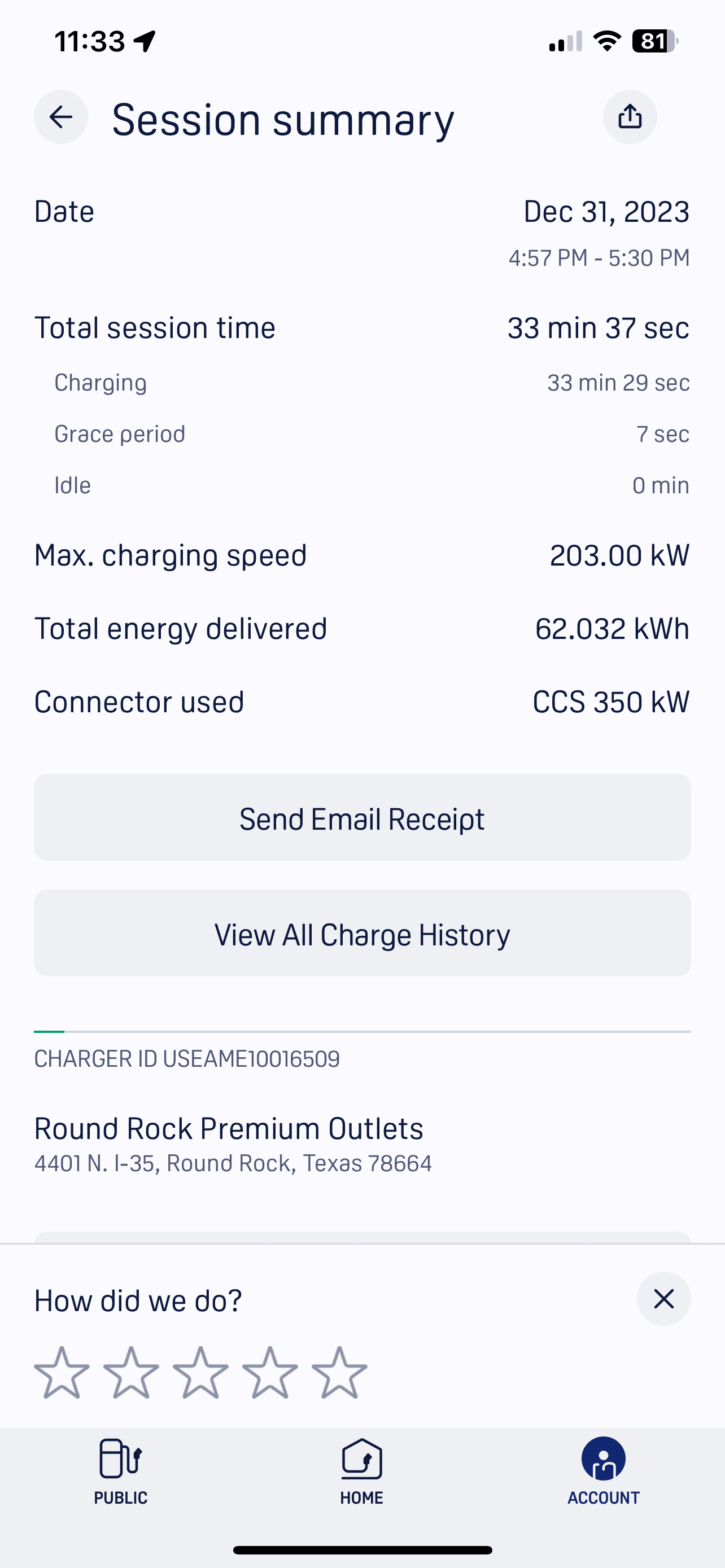

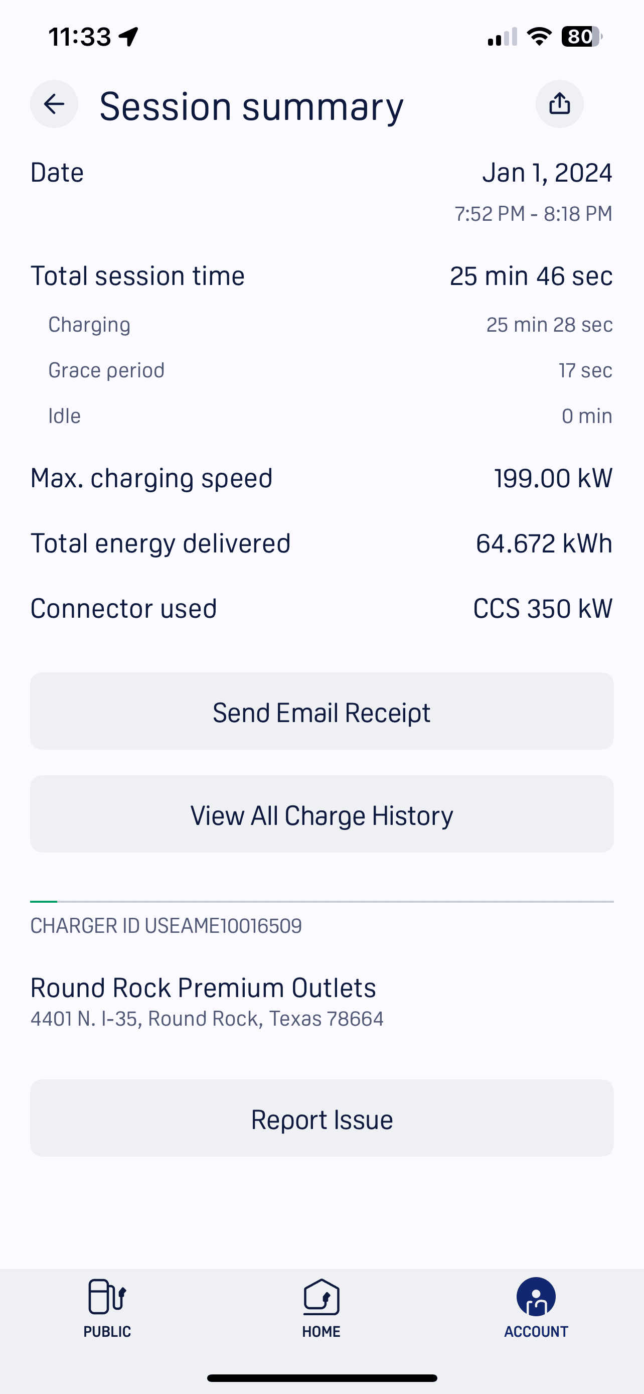

I’ve stopped at the exact same charging station on two of the busiest days and had no issues hitting 199 kW and 200 kW.
One charging station was down and there was a tech on site fixing it. I even gave some nice chocolates for his kids and wife who were patently waiting on their dad to finish working on New Year’s Day so we could have minimal issues with charging.
I’m extremely happy with the performance from the exact EA chargers you used.
I would work with Rivian to troubleshoot your vehicle.

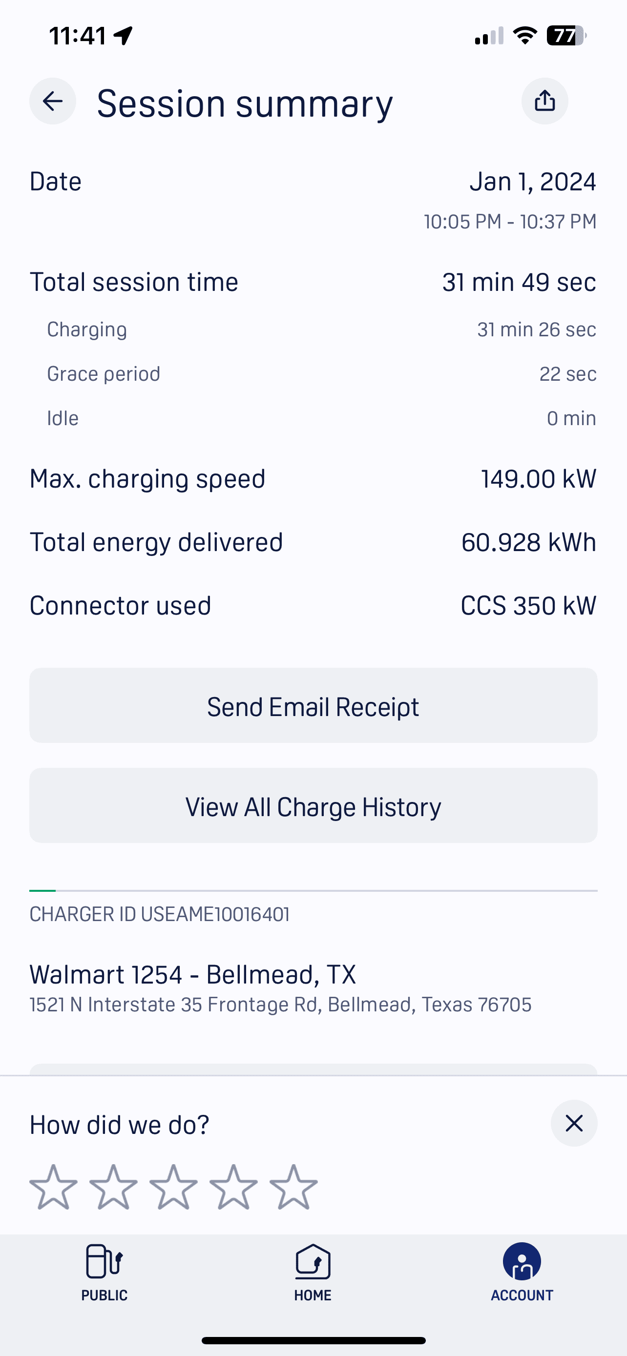

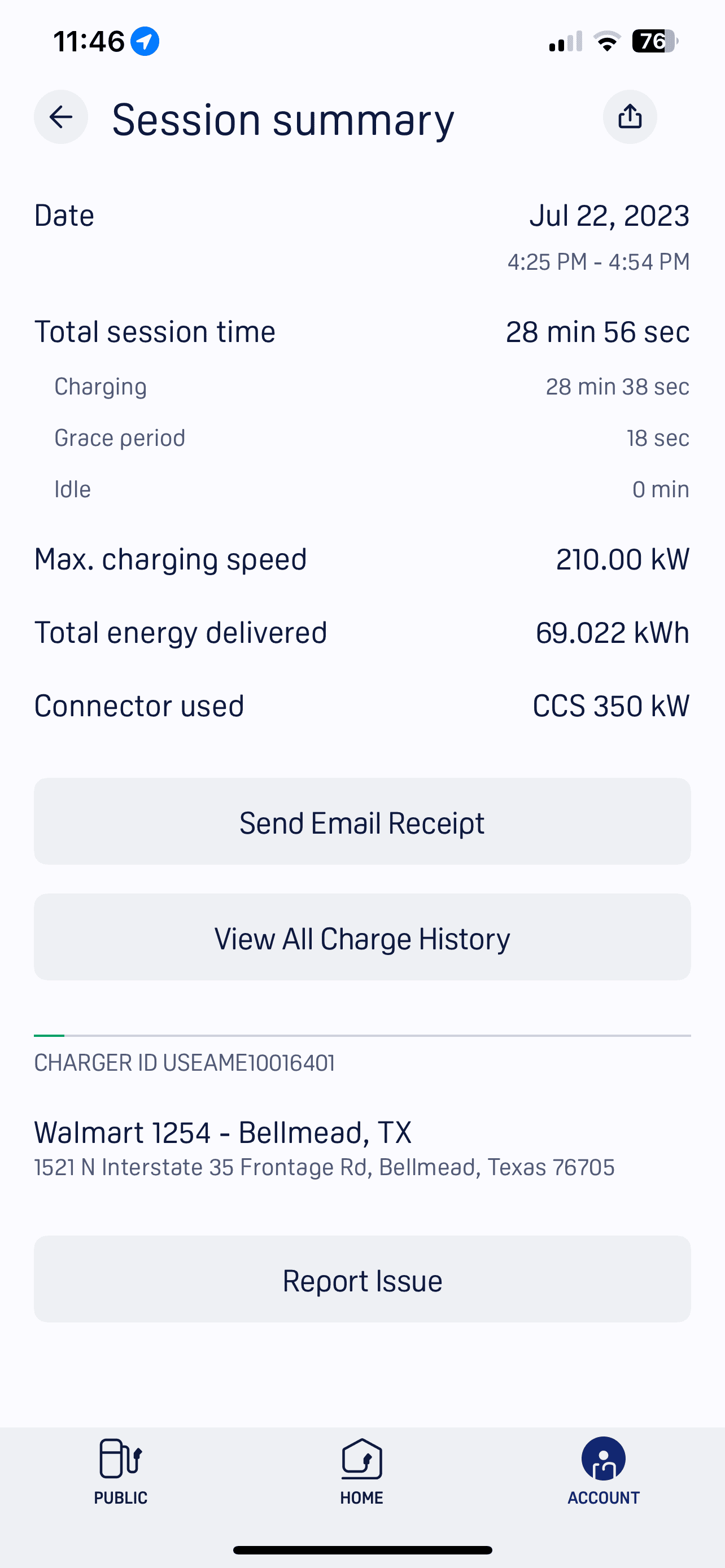

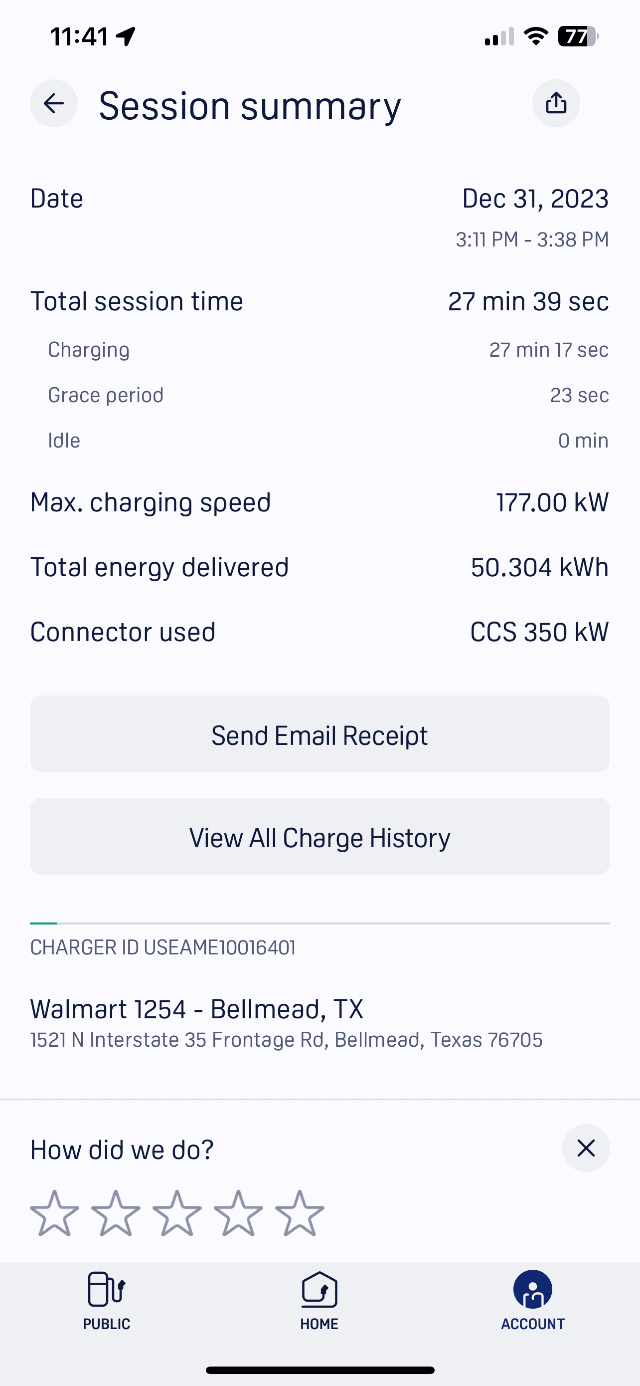

Same story with the Waco EA chargers you used.
I am able to hit 150-210 kW at those chargers consistently during peak holiday times.
No issues at all with any of my sessions. The only thing is one time I had to activate using my Apple Pay EA wallet card. Every other time I can activate using my app.
