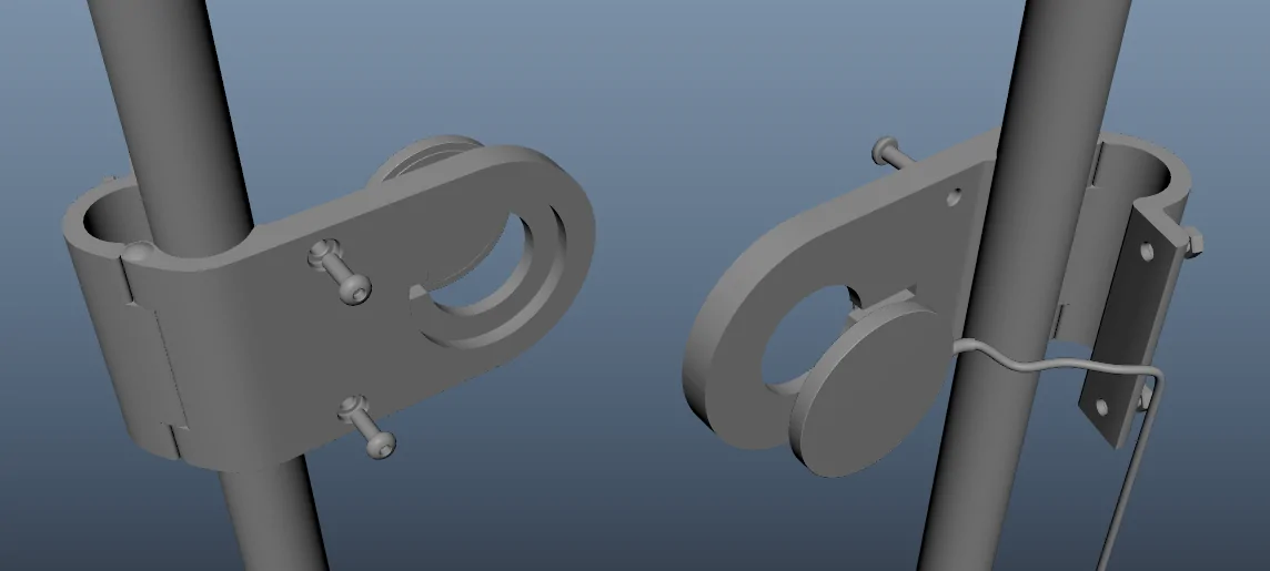

I love 3D printing. I've printed a lot of things for my R1T. Yesterday, I decided to solve my daughter's iPhone charging needs and declutter her desk a little. I built her desk out of gas tubes and wanted to mount a MagSafe puck charger on the tube. Looked on Amazon first and after not finding anything, fired up Maya and 3D modeled this:
Rivian R1T R1S It's Finally Time To Put A 3D Printer In Your Garage 1726662633970-sx
I exported it to my Prusa Mini, and a few hours later, here it is. Works great!
