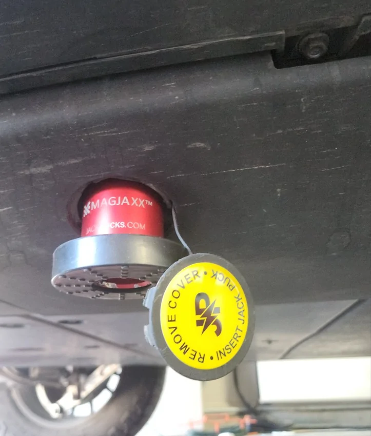

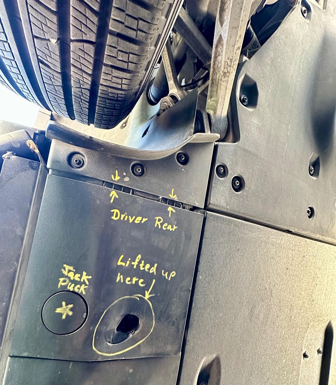

Since many shops still struggle to locate proper jack points on Rivian's (unfortunately), we created these epoxy dome emblems to make them easy to spot and eliminate what happened in the second photo.
Rivian R1T R1S jacking from the front underside? Yellow Emblem 2
Rivian R1T R1S jacking from the front underside? Rivian Incorrect Lifting Location

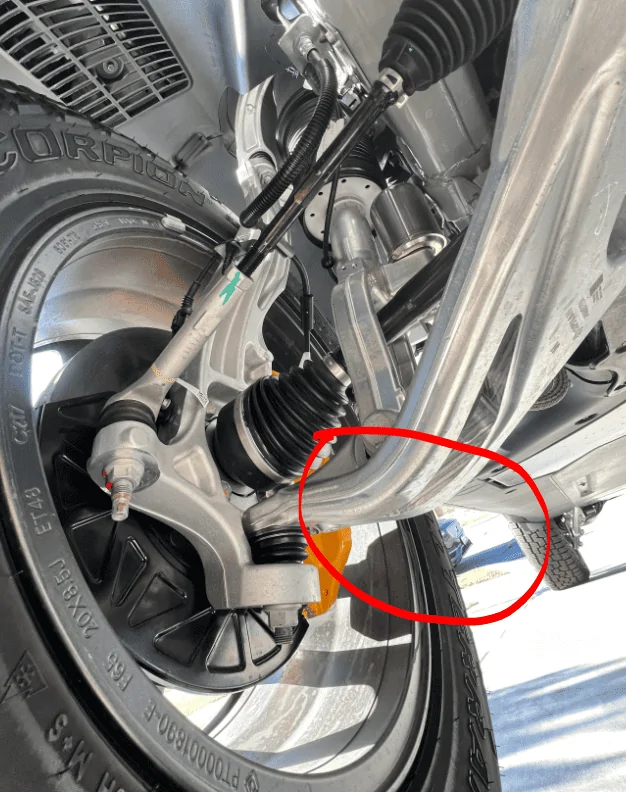

Alternative lift location below
Rivian R1T R1S jacking from the front underside? floor jack on a arm rivian

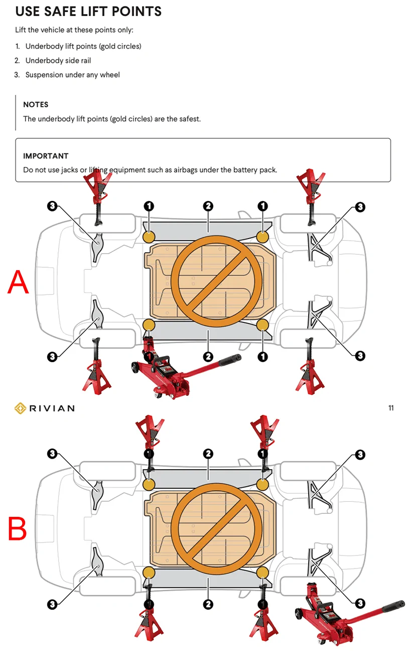

Wait, what is this image from? I can't find it in the R1T owner's guide (2022-2024 or 2025+ versions), R1S owner's guide (2022-2024 or 2025+ versions), R1 Tow Guide, or R1 Tire Change Guide.
I've only ever seen this version in the manuals (plus a separate picture for the jack puck locations):
