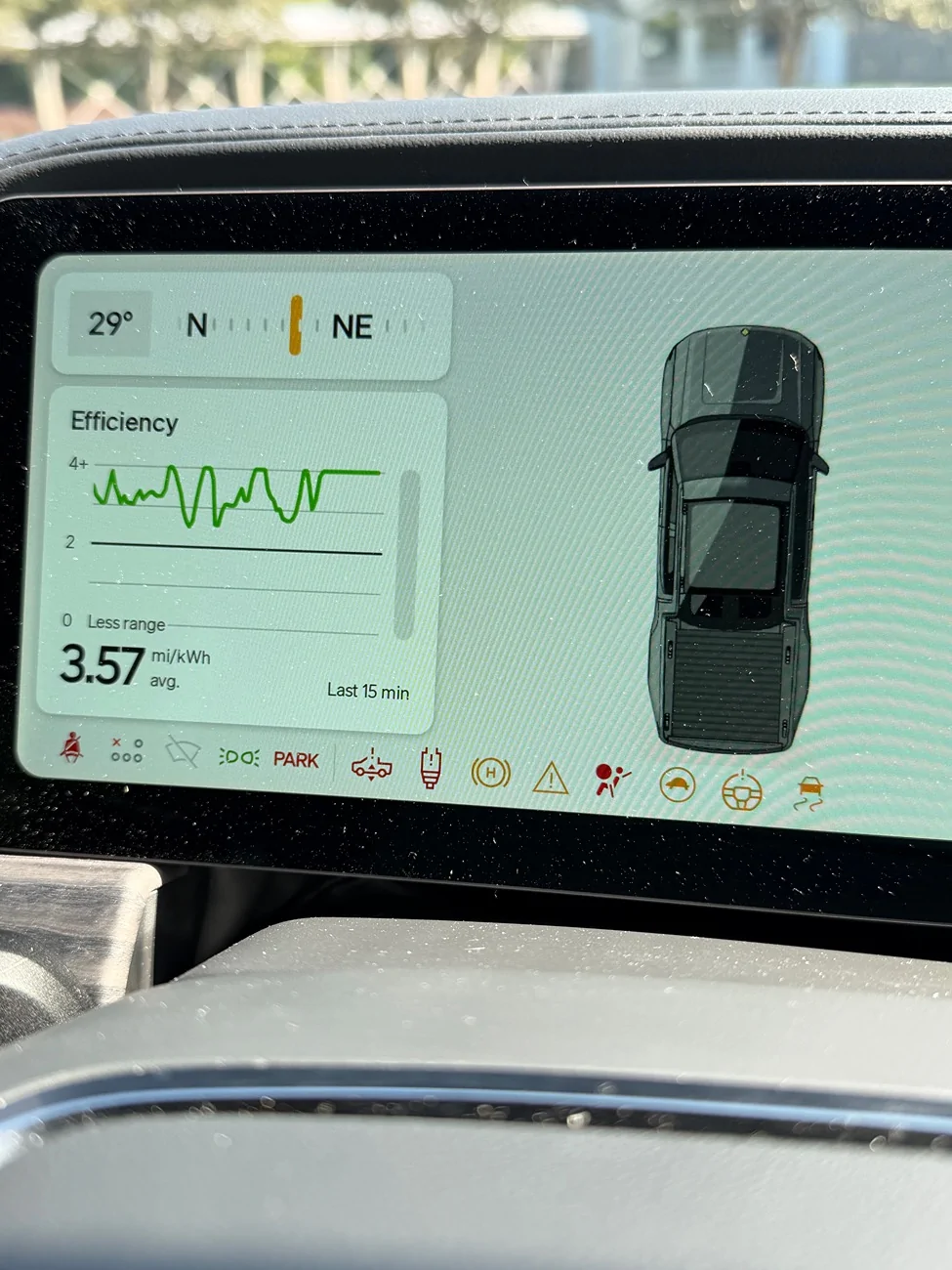

Jackpot! I got all the lights popped up
23R1TFGFE
Mar 12, 2023
104
103
TEXAS
Tesla Model Y; Rivian R1T; Porsche Spyder; Vespa GTS
On the other hand, how the heck are you getting 3.57 mi/kWh — wow!!
#jealous
…in all seriousness — hope you make it home safely and that the problem is a minor one.
#jealous
Relatively easy in city traffic with the Gen2 and street tires. I consistently see 3+ in those conditions.
Downhill helps too. lol

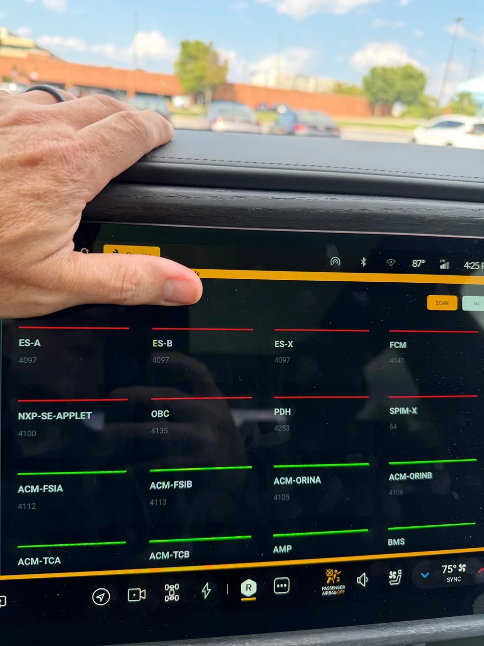

Here is what I have left from 2 resets. Gen2 R1T 2026 Dual Max Perf. 6628 miles.
Rivian R1T R1S Jackpot! I got all the lights popped up IMG_0961
Rivian R1T R1S Jackpot! I got all the lights popped up IMG_0962

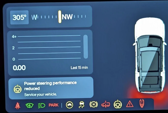

I had the same set of lights about a year ago. They had to replace a safety systems computer module under the front passenger seat under warranty.

I just had that happen yesterday about 70 miles from home. I did a soft and then a hard reset and that seemed to fix it. A little unnerving to see all those lights go on when you are trying to go home. I hope it is something minor for you.

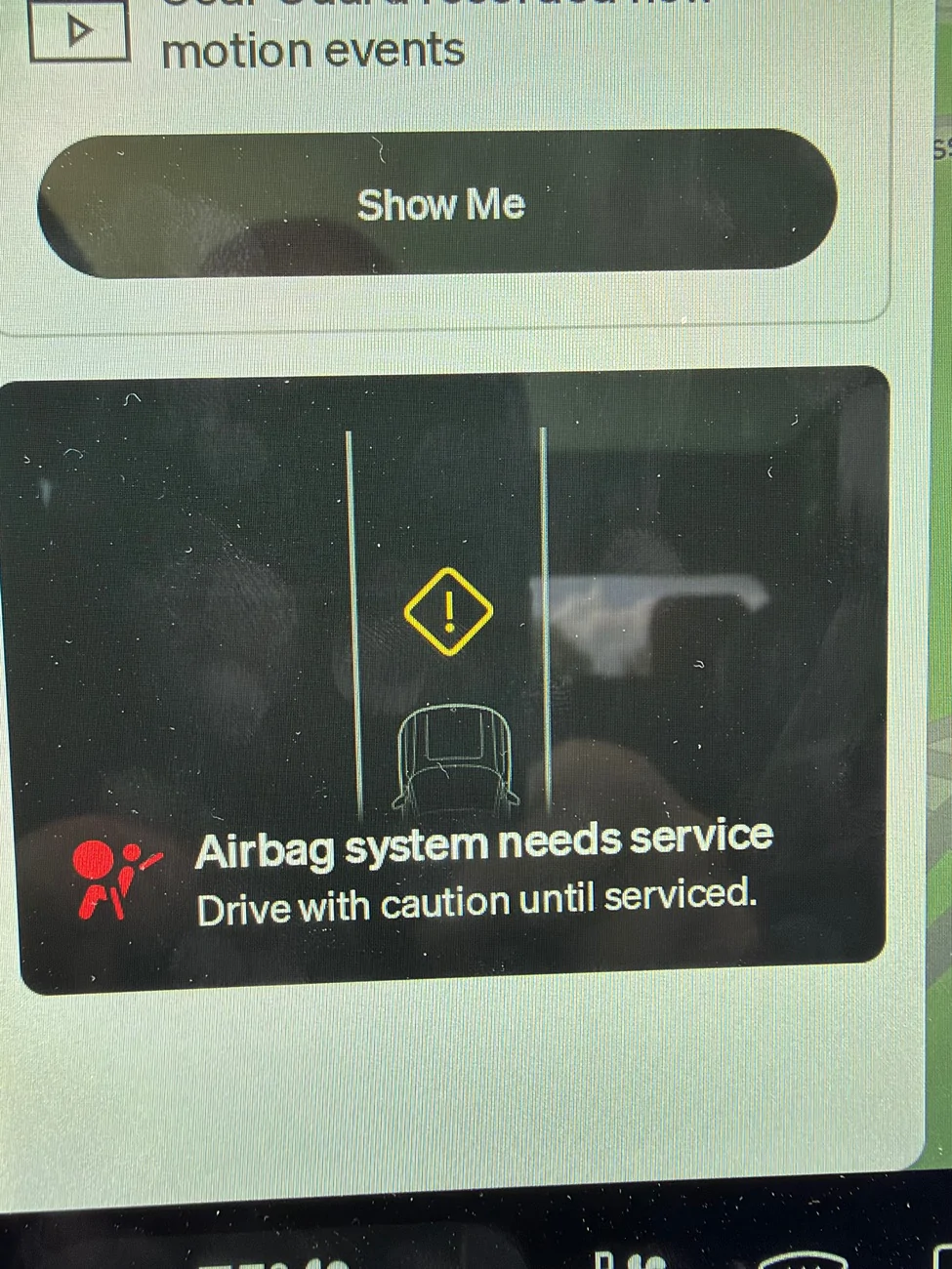

Just drove 1.5hrs from MD to VA and once I stopped to park, I got all the lights. Hard Reset and still have the Airbag System need service lights. Hopefully I can make it home after this meeting.
I had a similar situation minus the airbags. Turned out to be the hydraulic suspension system. Both the pump and manifold needed to be replaced. All under warranty but under 50k miles. Doing a hard reboot made them go away for a little bit, but they always returned. All good now. Good luck.

I just had the same situation last week. I did soft and hard reset, but still same issue. I took it to the service center and they are replacing the Auto Assist module is getting over heated and will need to be replaced. Good thing is they found out the issue (good to click your name on screen to get diagnostic when it happens). Bad thing is that there are quite a few issues with the module, so it will take 10 days to get the replacement part. So I have a loaner luckly.

1 day repair or longer?
It was in limp mode so Rivian arranged a flat bed to tow it to the service center about 60 miles away. It was ready to pick up about 5 days later. The repair itself probably takes less than an hour if they have the part and shop capacity. I was not in a rush because I had a spare car to drive at the time so I didn't push them on schedule.
