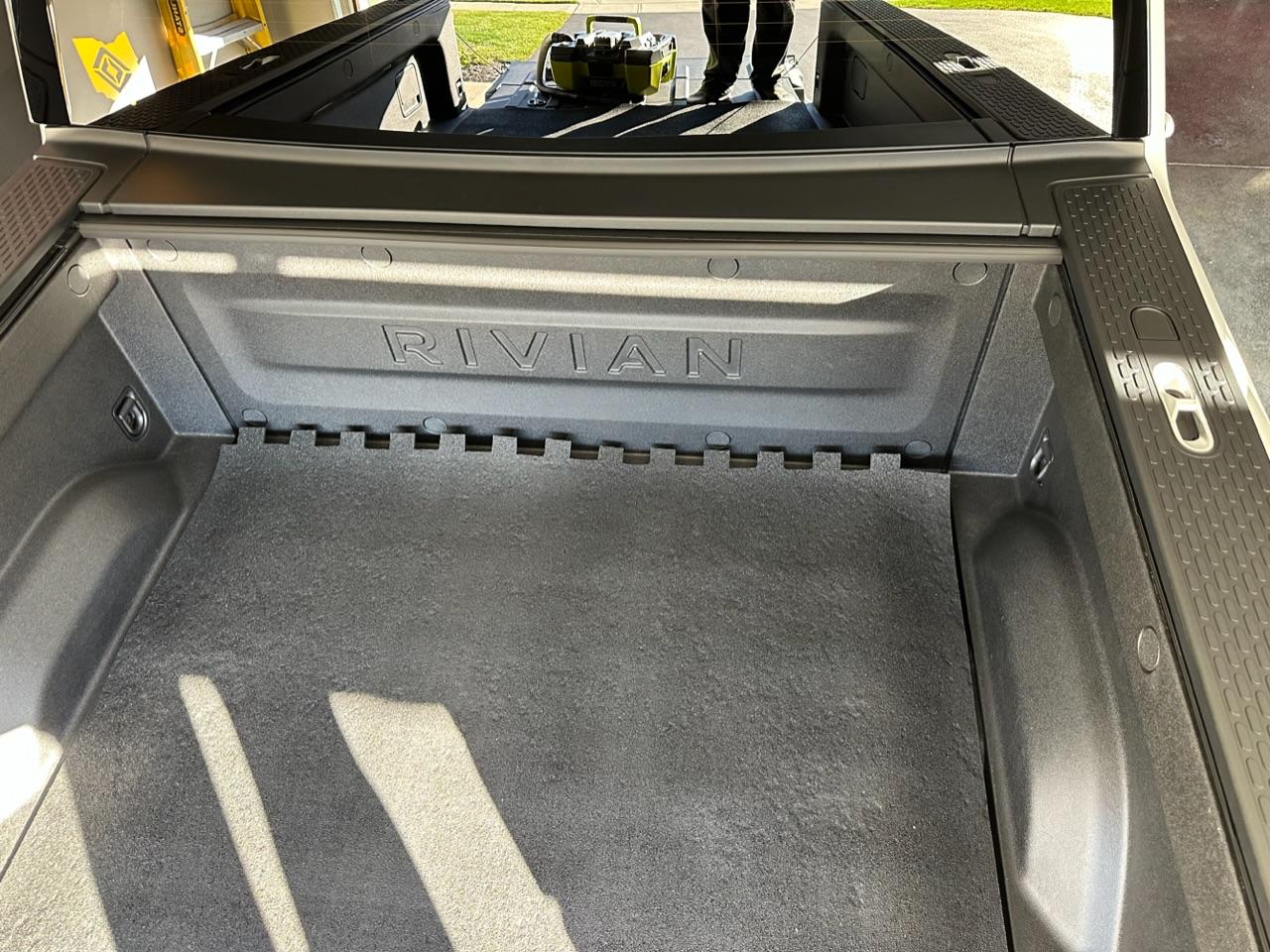

Man, @jebinc, I could not find that matt at any Home Depot anywhere. IN fact, that section of the store I went to looked like it hadn't been stocked in years.
What I found instead was 1/4" rubber stable matting from Coastal Farm and Ranch. I bought 5' for $39.95, trimmed it up and I think it'll work out just fine. Somebody else mentioned using 3/4" stable Matt but jeez, I think that would be way too unwieldy.
Here it is:
Rivian R1T R1S Jebinc’s rubber bed liner mod tempImage0YOXLK
Somebody else mentioned using 3/4" stable matt but jeez, I think that would be way too unwieldy.

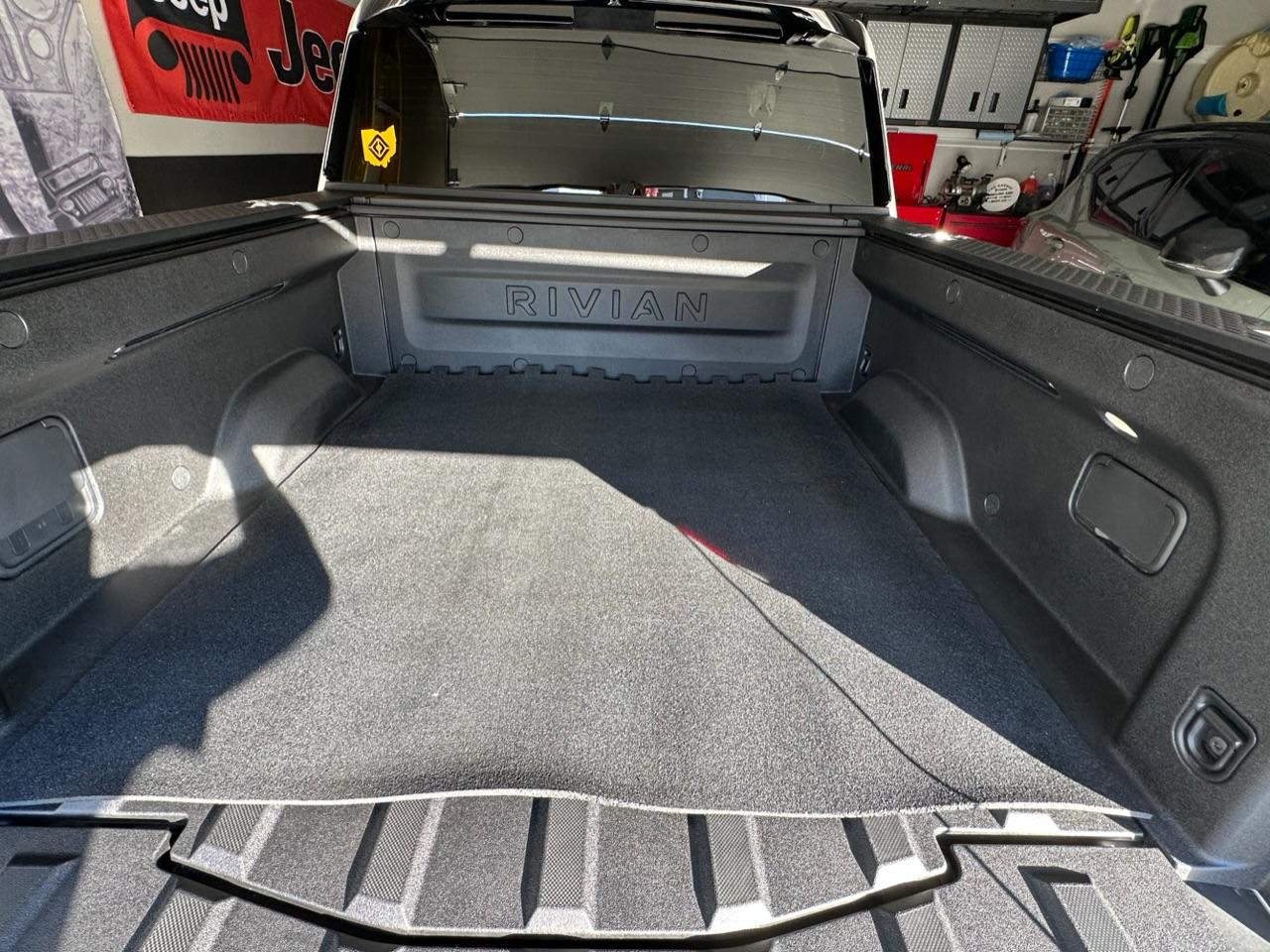

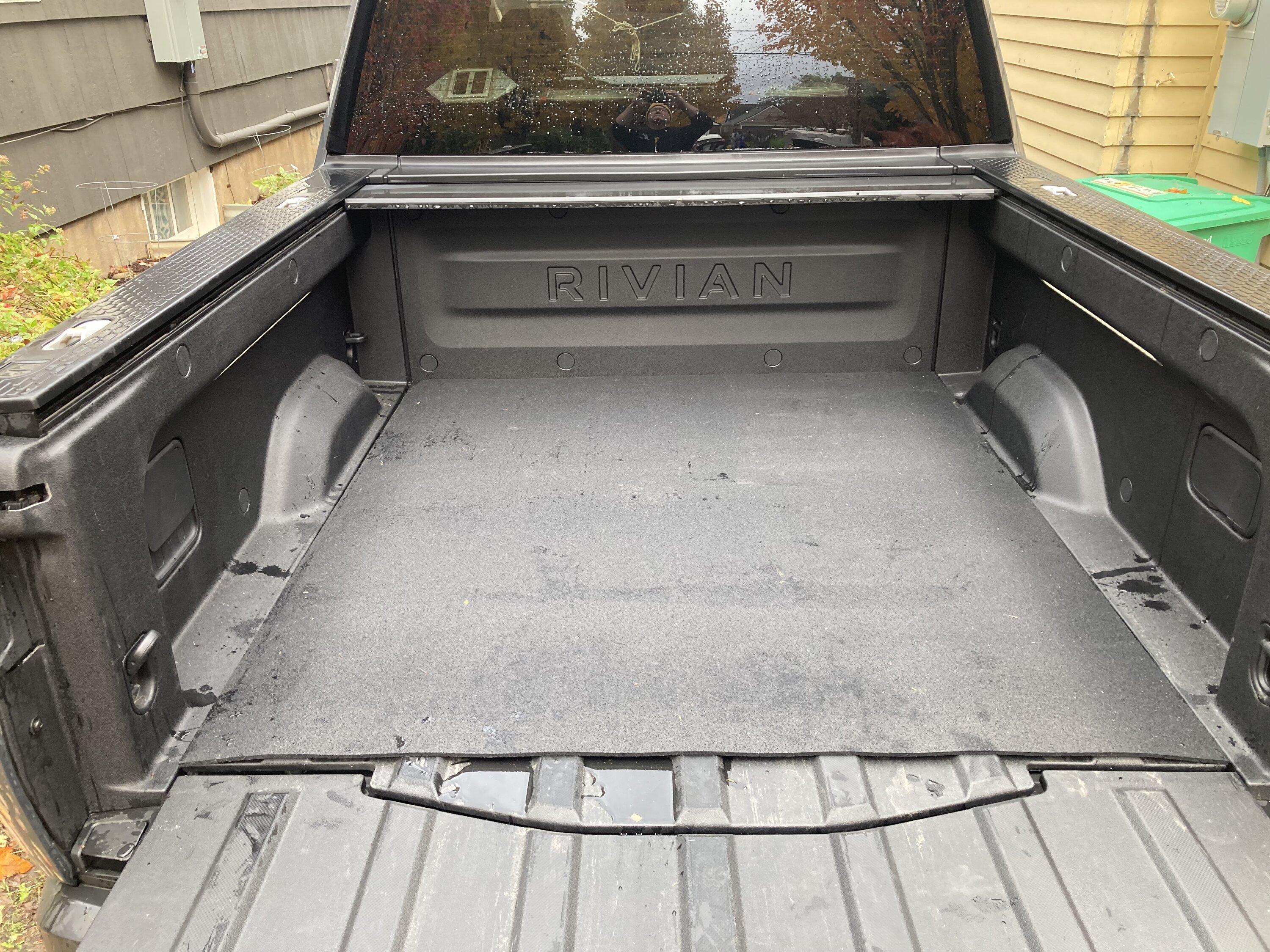

Ok, so I finally cut/installed my mat. I did change things up a little bit to meet my preferences.
I installed the mat originally with the textured side up, but then thought that the cover is not 100% water tight, so I wanted the mat to be able to shed water the easiest to keep water from sitting back there. This is me being OCD and over thinking things. With the mat “upside down” it blends in pretty well with the bed as well.
I cut the mat to length, but wanted all of the factory drain channels fully exposed….again me over thinking things. I then notched the front of the mat so it was still to length, but also left a lot of the front drain channel open.
Once the mat heats up and relaxes, then it will lay flat in the bed.

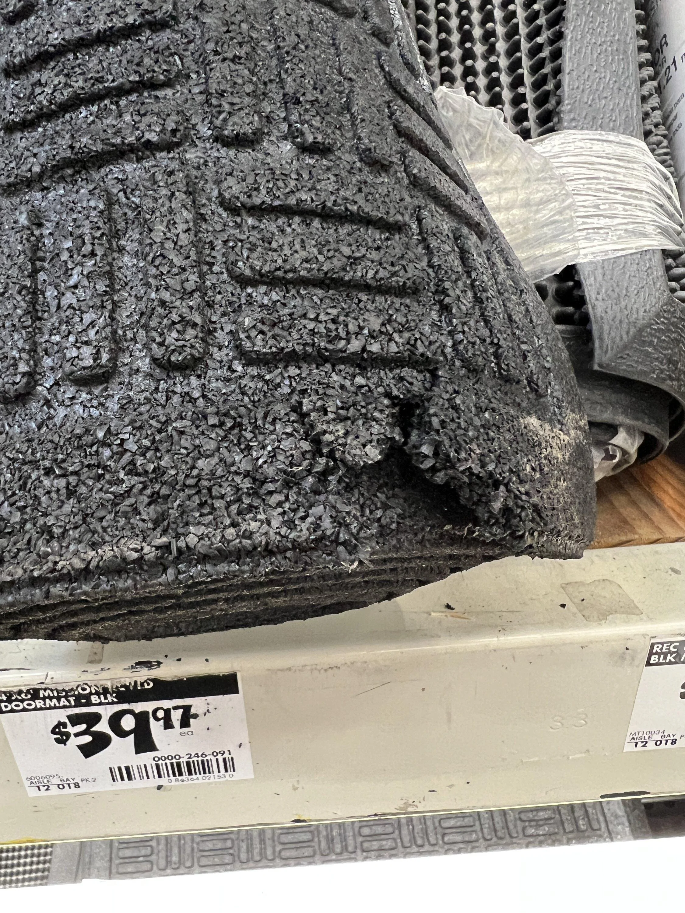

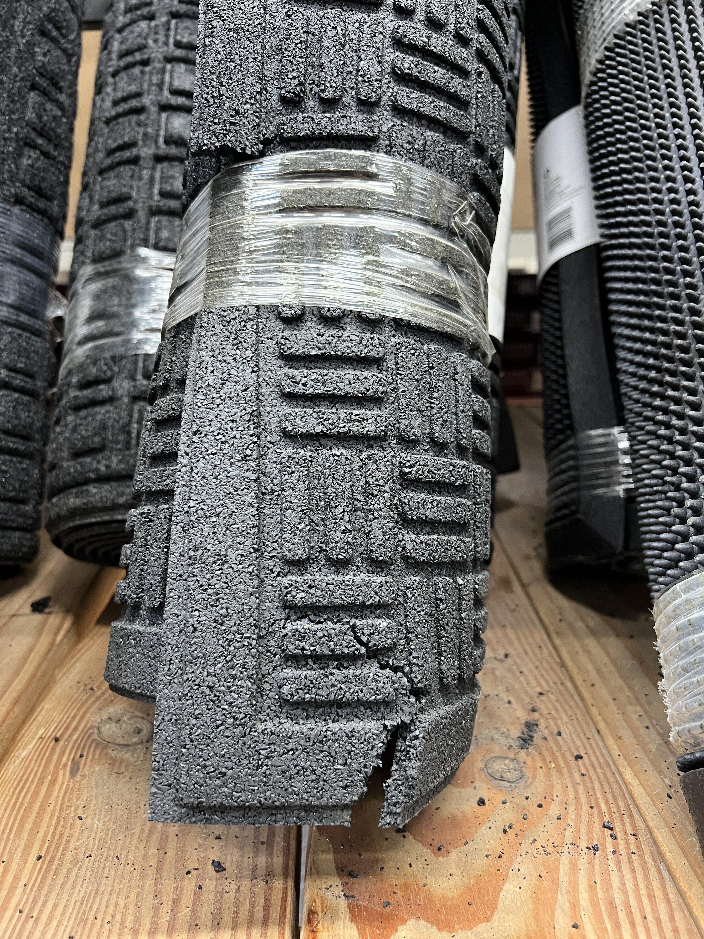

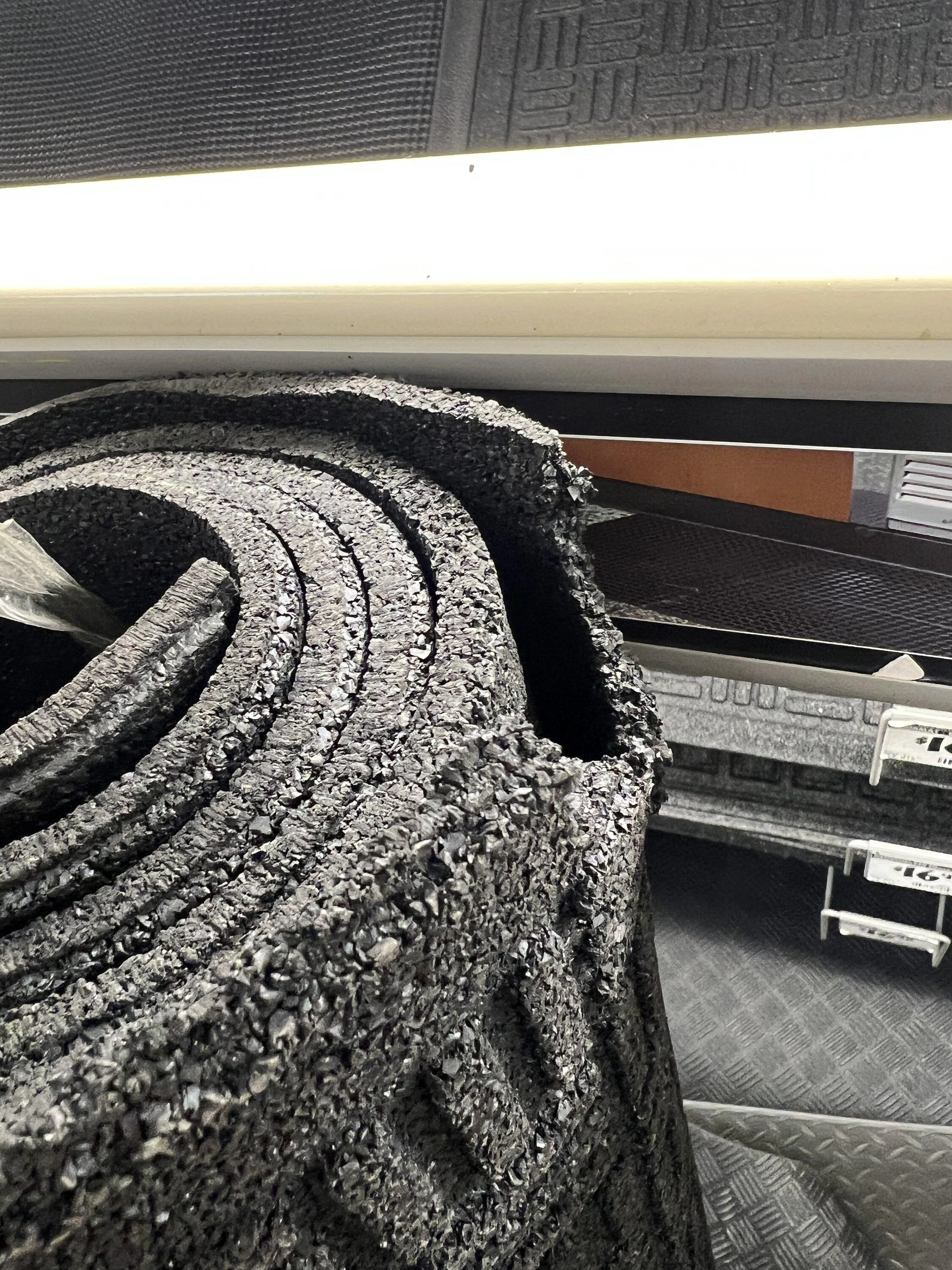

Great item. Just picked one up. Just be careful it’s not damaged. I had to go thru three at Home Depot before I found one not damaged.
So I can explain what's happening here, and what the difference is between the $30 home depot mat and ours. This is a difference between Polyurethane binding and Vulcanization.
Polyurethane binding basically takes the rubber particles and glues them together, in doing this leaves voids and gaps, but a couple of downsides to those gaps. First, you have a much higher chance of exactly what's shown here, not all of the rubber granules got coated and they didn't bond. Another issue is that being porous, these mats will absorb and hold liquids. If you spill oil/water/blood?? :) This mat will hold all of that and you can not get it out.
Now, a vulcanized mat is completely different. We take the same rubber granules and re-vulcanize (melt) the rubber molecules back together. The mat becomes a solid non-porous rubber sheet. You can spill pretty much anything on there and just wipe it up. The trade-off is that we can't go as thin as the polyurethane mats, but.... is that really a bad thing?? ;)
If you guys have any questions I'd love to help answer them.
Thanks for the insight. These mats are designed to be outdoor weather mats. I have had several for many years that have not broken down or look like those pictures. I believe the root cause of that mess is improper shipping, handling and storage. For $29, these mats a great inexpensive bed mat for the truck.
