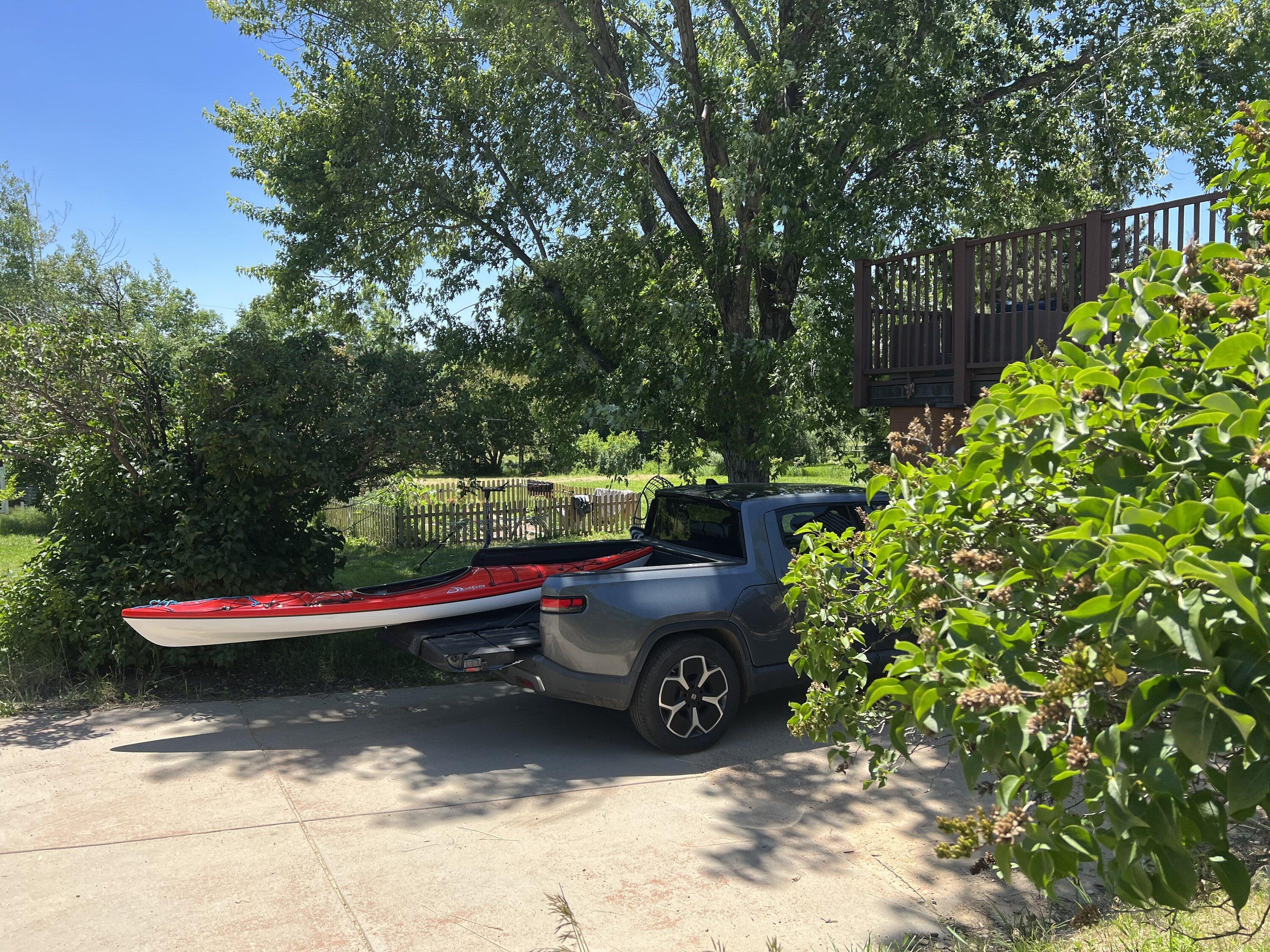

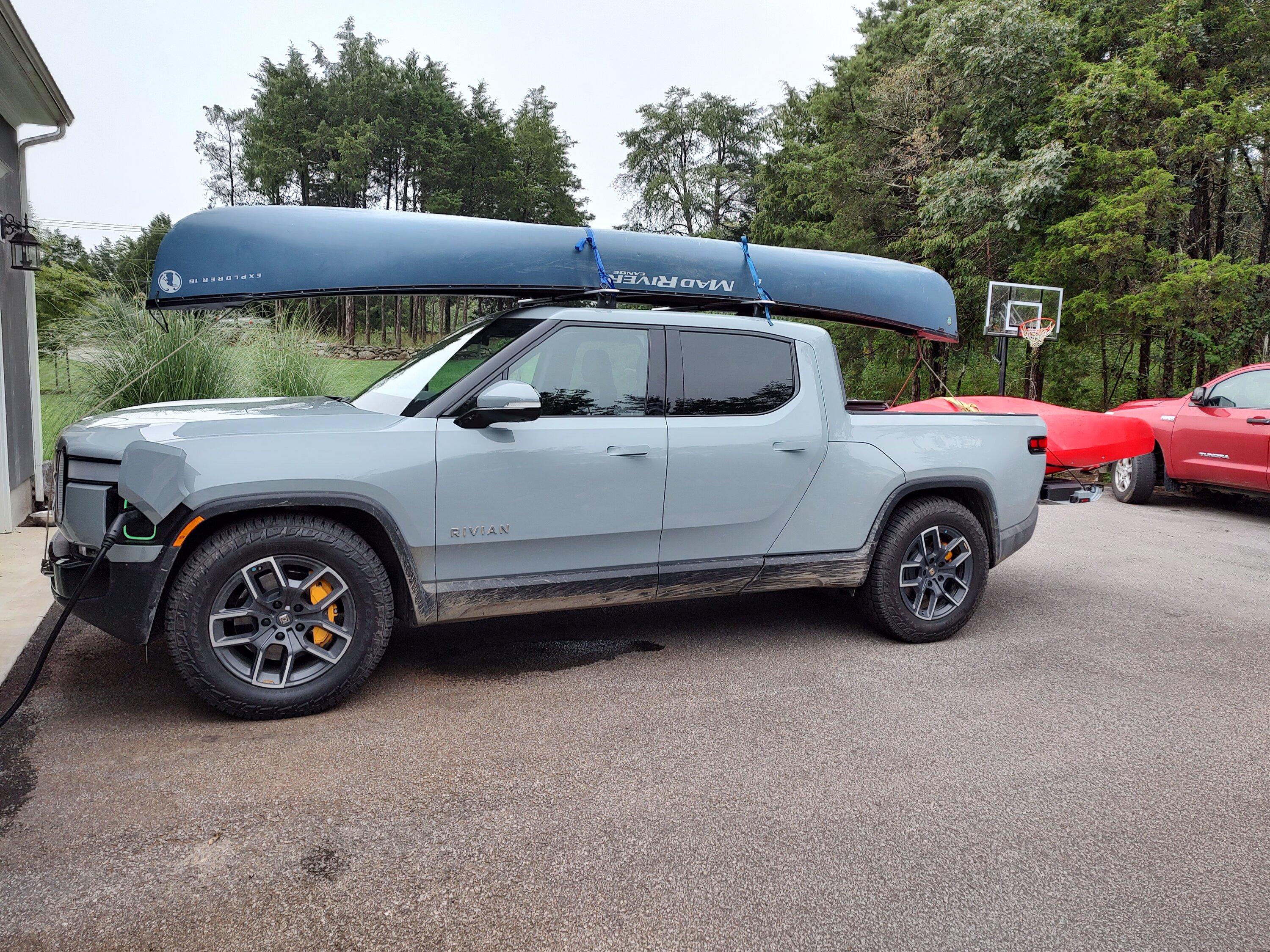

For us kayaks seem to work best laying in the bed, of course these are only 9ft, so anything longer might not work. We tried the roof mounted racks but anything on the roof kills efficiency so we try to avoid that
Rivian R1T R1S Kayak Transport IMG_20220827_091458204
Rivian R1T R1S Kayak Transport IMG_20220827_091513626_HDR

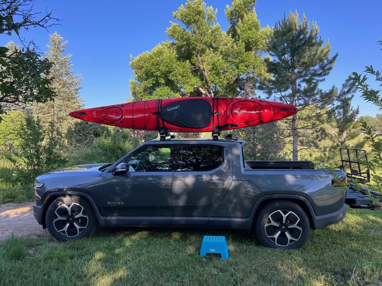

Recent trip with the Yakima jaylow mounts and a Delta 12-10 yak. Trip details in another post.
Rivian R1T R1S Kayak Transport IMG_7280

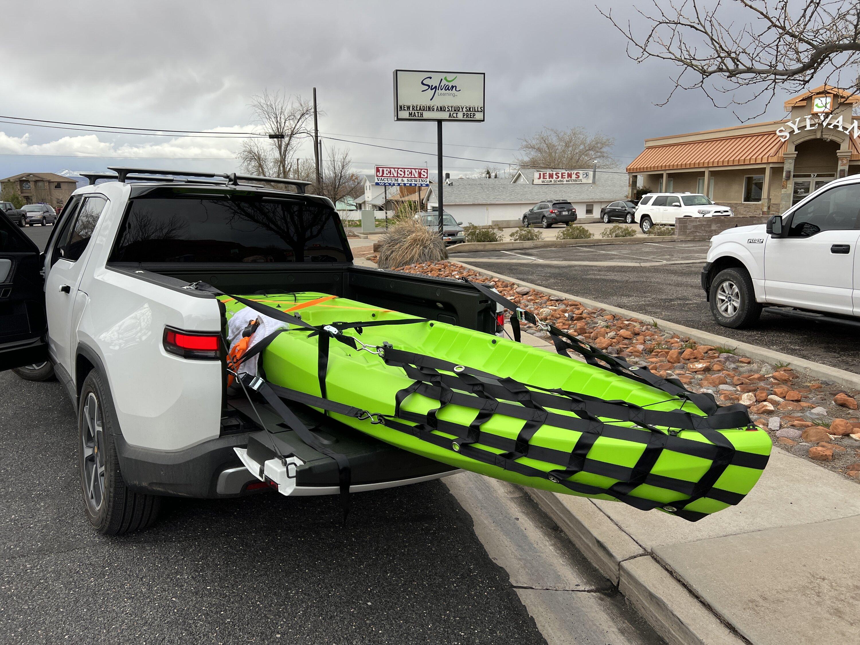

I should take a picture of my setup the next time I'm out. I settled on using the Loadd Sheett with my 12' Old Town Kayak. I have yet to use it with two kayaks but I think it would be fine. My only complaint is that the straps can be a little annoying to tension down unless you feed the bottom portion up through the top well before tightening. Additionally, its a little hard to get the sheett well-centered on the kayak during tightening. Regardless, I find this system takes me about 5 minutes start to finish and is dramatically faster than my old thule roof racks.

How long a kayak do you think this Sheett system would work with in an R1T? I'm contemplating picking up a used adventure kayak (maybe in the 14-16' range) but trying to think about how to move it around is throwing me for a loop. Do you do anything special to secure it in the front, or is it just the tension that holds it in place? FWIW, I have the Rivian bars that I keep on top of the bed with a bike rack that I use several times per week.

I also have the bars in the bed. I just tension it down at the back and let the pressure of the kayak against the front of the bed hold it in place. You can take your hand and shake the entire truck when it’s tensioned down, so I’m confident it’s staying in place.

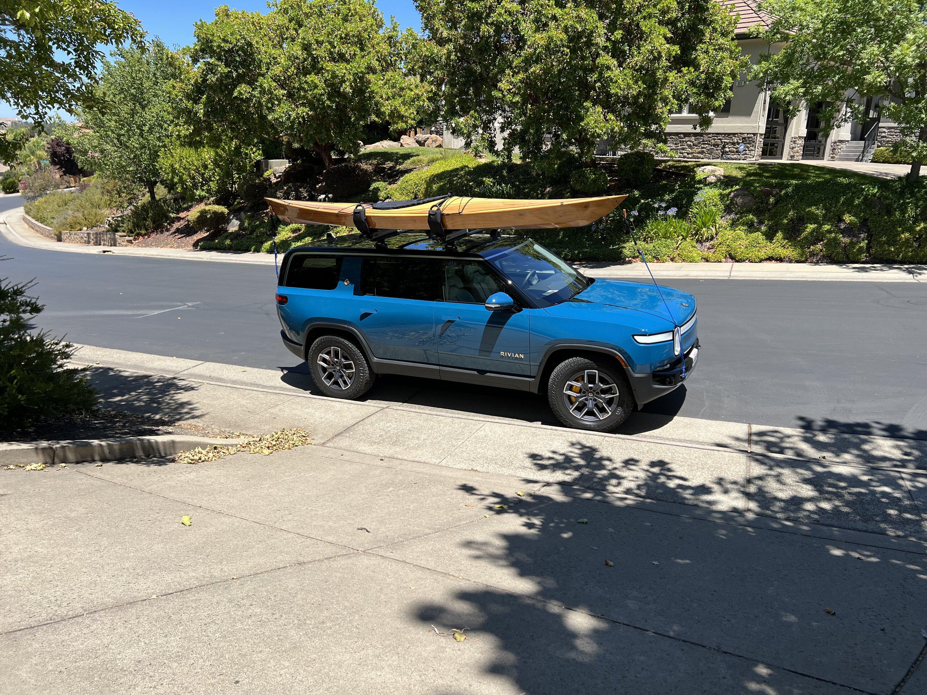

This is my setup. Thule Hullavator carrying my 14’ kayak. Can’t use the factory crossbars though.
Rivian R1T R1S Kayak Transport IMG_1626

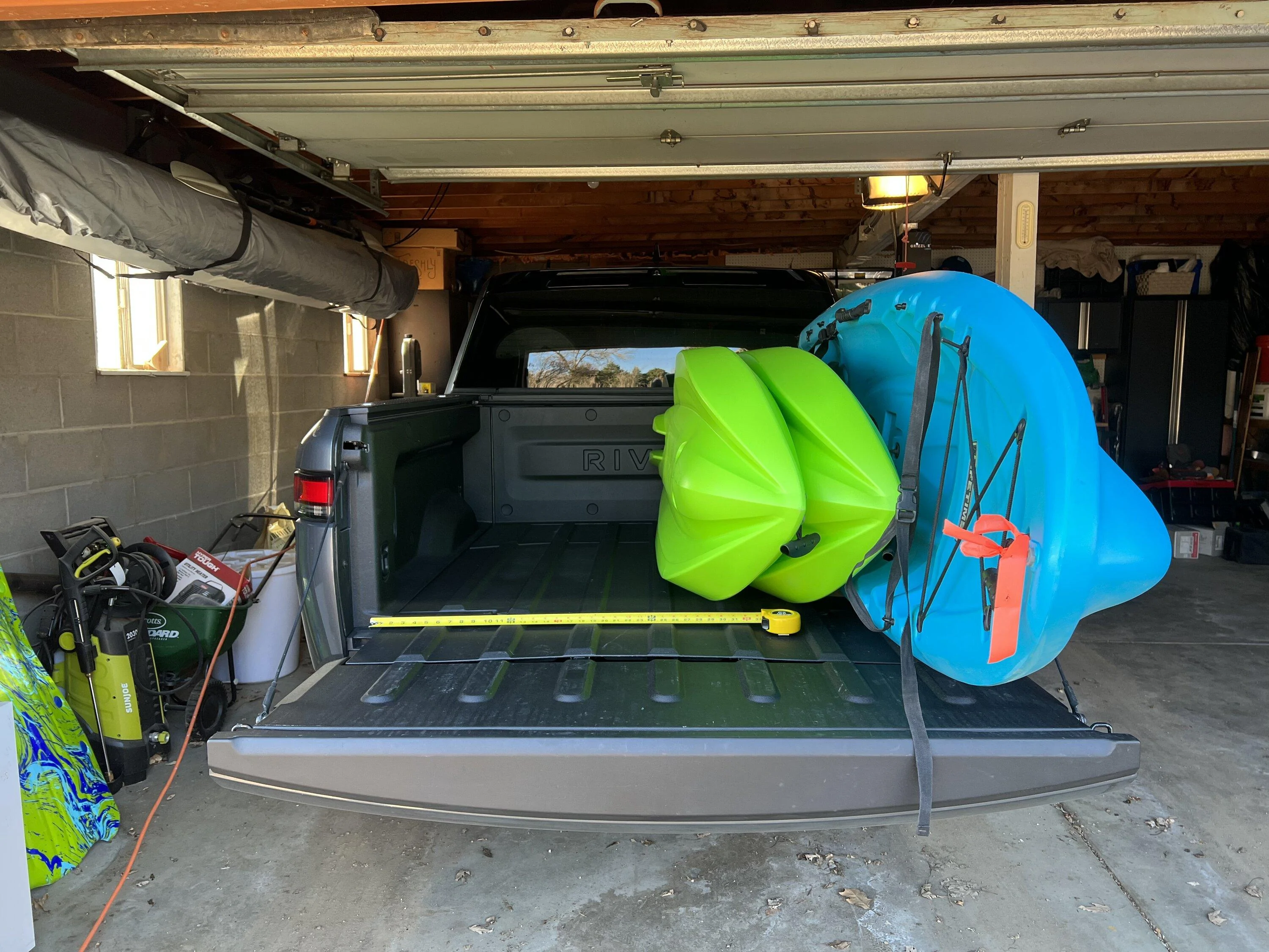

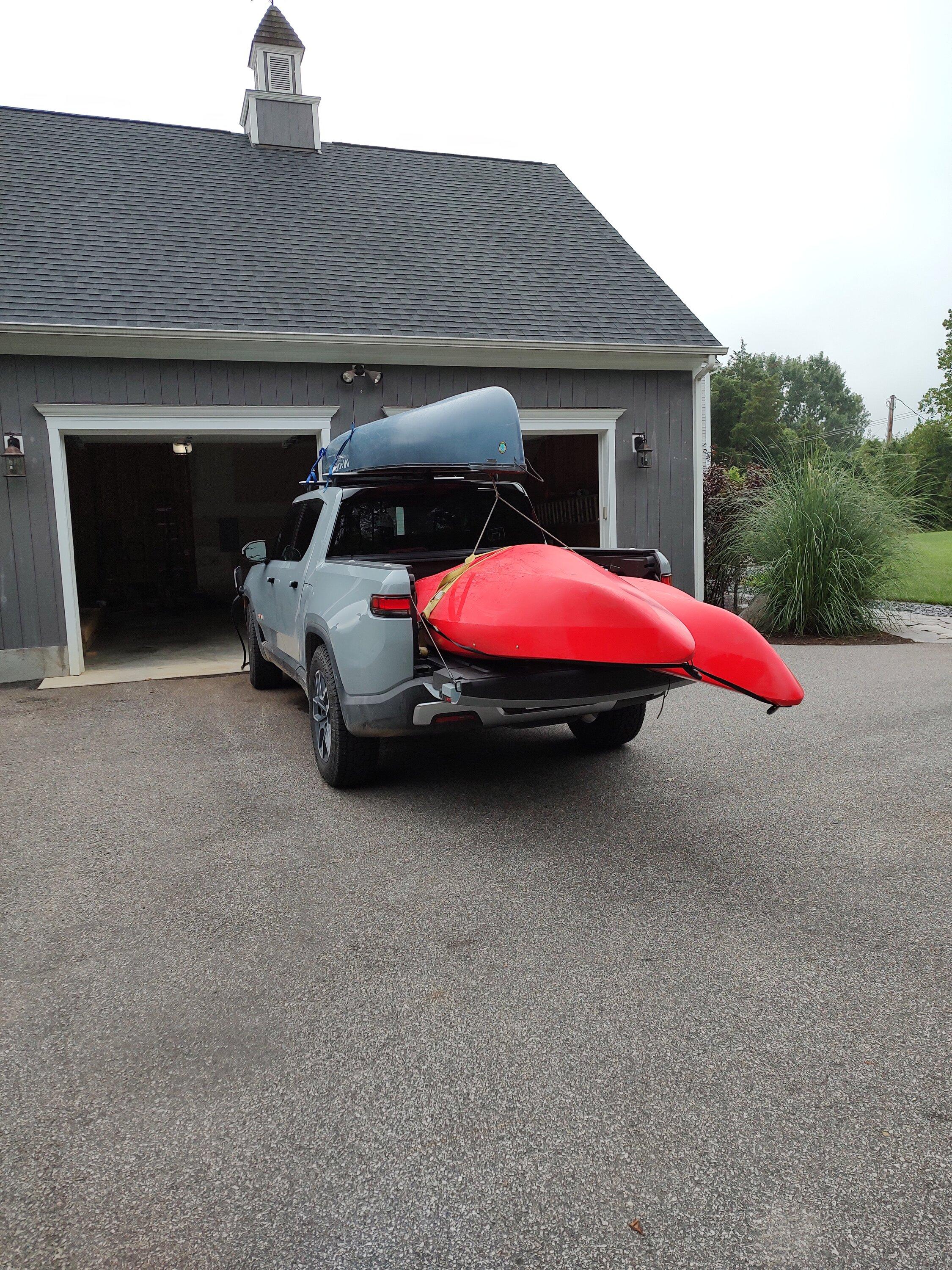

This is 12’ 10” yak in the bed. Looks ridiculous but for a 5 minute trip I might grab the front in a strap loop and then pull back on that with additional straps to the tie downs. Really need to watch out for tail swing though.
Rivian R1T R1S Kayak Transport IMG_7276
Thanks for the reference pic! Looks hilarious but might be sufficient for short drives.

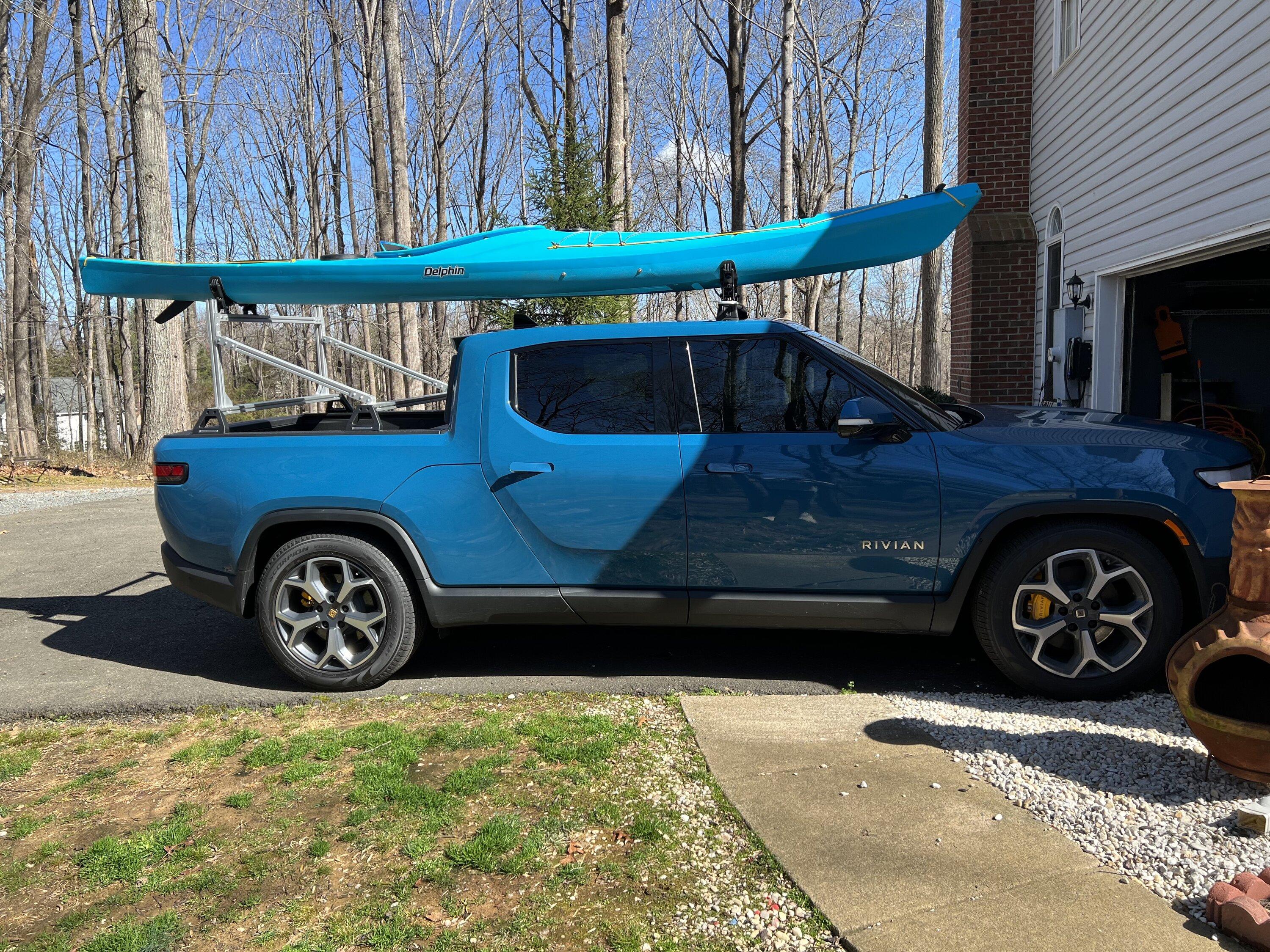

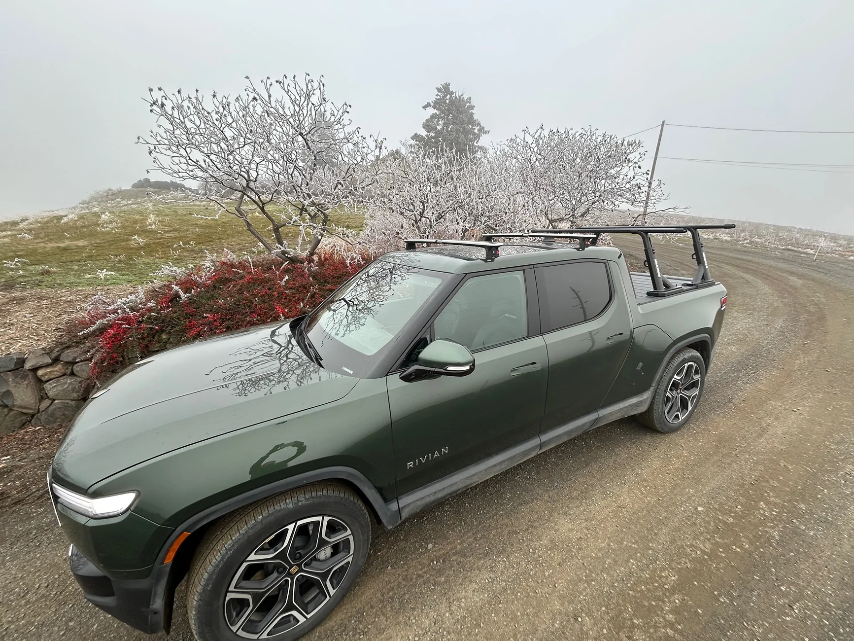

Two of us have developed a way to utilize Yakima HD Overhaul uprights attached to the Rivian attachment points over the bed & truck side rails. Once that is completed (often with the use of Rivian bars over the truck cab, a very versatile 9 foot span, with significant height adjustment available for the back two bars. See attached:
Rivian R1T R1S Kayak Transport IMG_1561
Rivian R1T R1S Kayak Transport IMG_6185

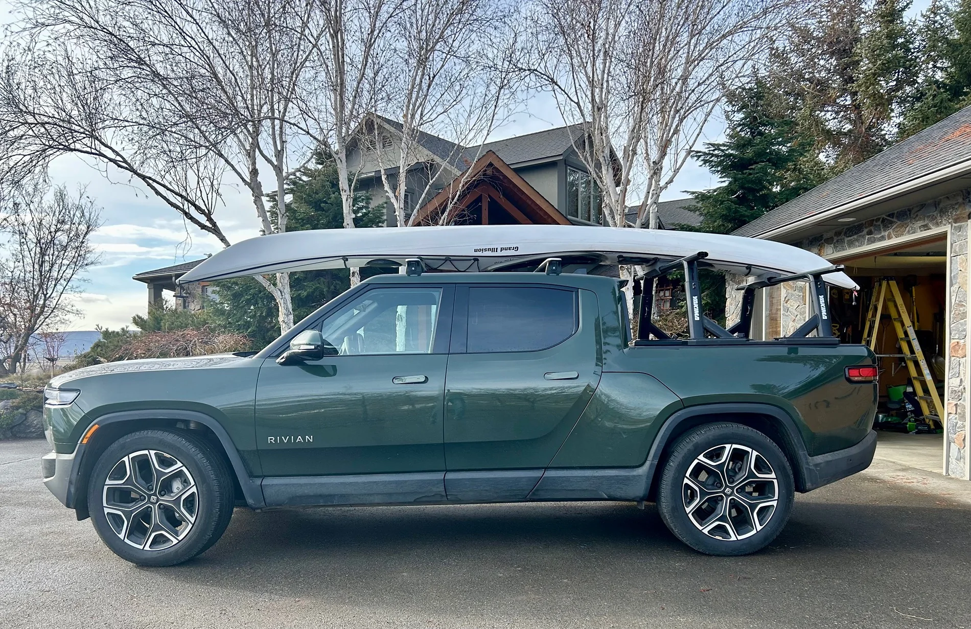

After 8 months of effort, this is what I have come up with … the sea kayak, the towers, the crossbars, the foam blocks and the custom clips to attach the Yakima system to the Rivian side rails all made in the USA.
Rivian R1T R1S Kayak Transport 1770563932898-
