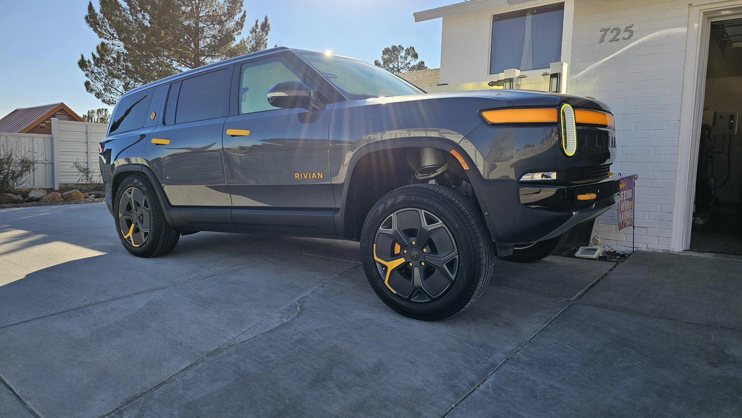

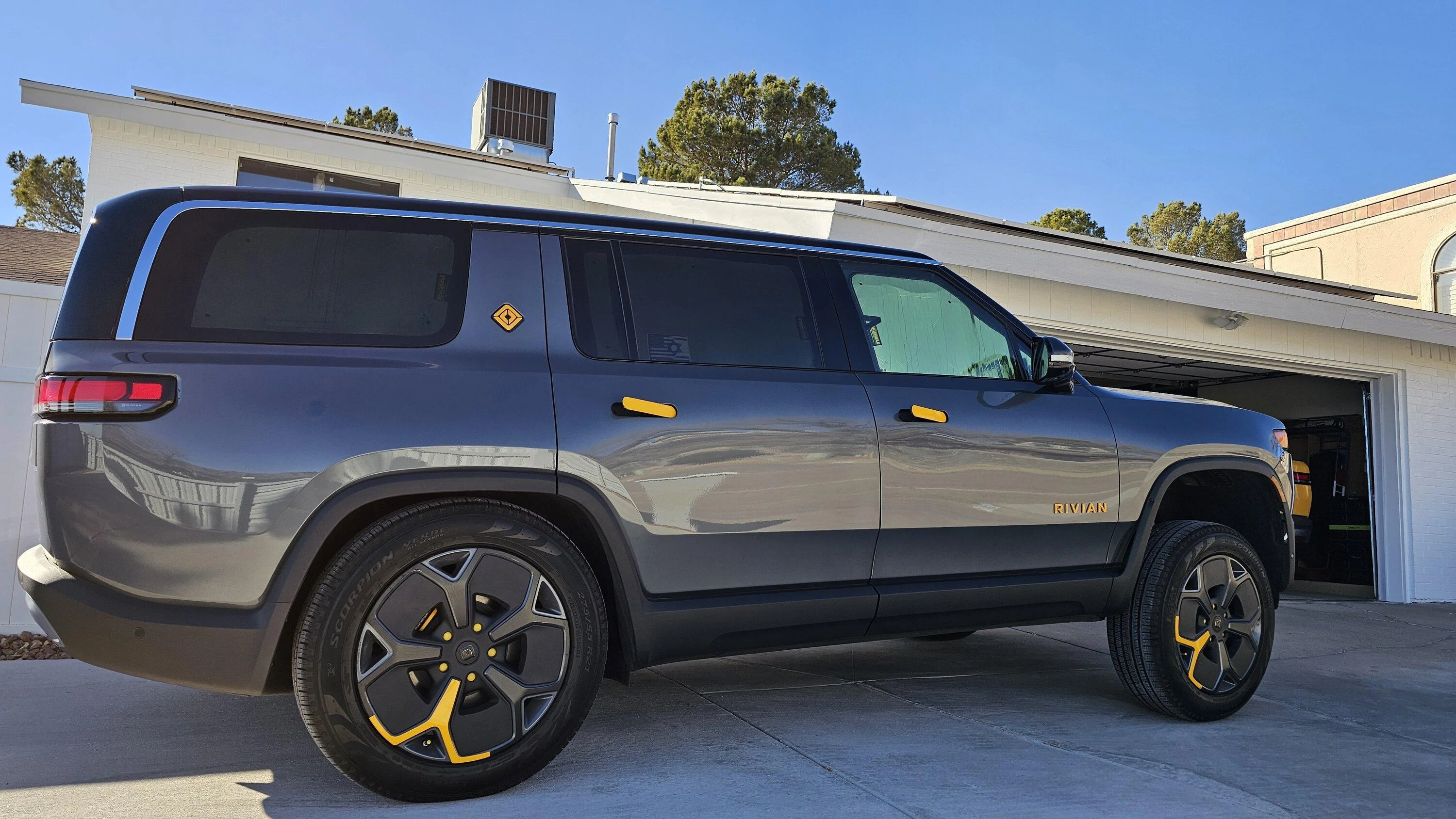

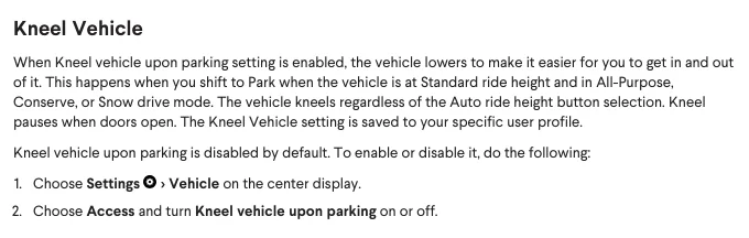

smunro622
Stu
May 10, 2024
38
265
173
United States
2023 Mach E Premium
New R1S owner and had a question on kneelibg mode. Not trying to hijack the thread
I have the slider to the right so it turns yellow auto is enabled in ride mode is there any other reason it will not lower when I put it into park?
I am 6'3" and wife is 5'7" needless to say you hear the comments...no I do not have running boards, and pretty run in all purpose mode...any thoughts on what I should check? May I am expecting some different like the pulsing green across the front while charging and it is only the charging port lights.

CharonPDX
Charon
Jul 12, 2021
2,594
4,384
Cascadia
InfoSec Geek
There are certain conditions that even if you have it enabled, it won't trigger. Some I've noticed:
* You only drive a short distance
* You're parked on a hill, ESPECIALLY where the terrain is uneven. My driveway is both "left-right" sloped and "forward/back" sloped, and the combination means when I park in the driveway, kneel will refuse to engage. But it always engages in my (flat and level) garage.
smunro622
Stu
May 10, 2024
38
265
173
United States
2023 Mach E Premium
Thank you both yes it is enabled. and the driveway is on a slight slope and does tilt to the neighbors house ..in will find a place level to try again...
On the green pulsing front am I understanding this incorrectly it should pulse when it is charging?
5,801
10,199
2022 Rivian R1T LE
Only if you have that setting on and the vehicle is unlocked.
Chayse
Fred
May 13, 2024
SE PA
R1T, BMW X5 MC
My Driveway is sloped as well and will not kneel. It does do it everywhere else I stop. i usually switch to conserve or sport and hit the down button to get it to lowest. When I back out, I'll hit all purpose again.
