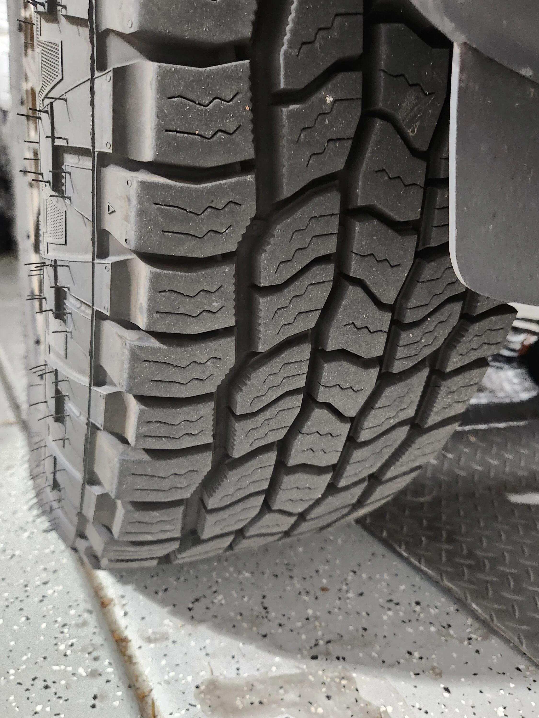

Great tire!! I've run at 65psi on my Cooper Discover AT3's for 21,000 miles already and from previous posts I'm within 1-2% on range of the Scorpions. Road noise is neglible, tire wear is rock solid. Ride comfort is not noticeable to me, as compared to OEM. Load Range E vs D is the equalizer.
Picture below is 10K plus miles. I'm thinking I'll get 30K easy on the Cooper AT3's.

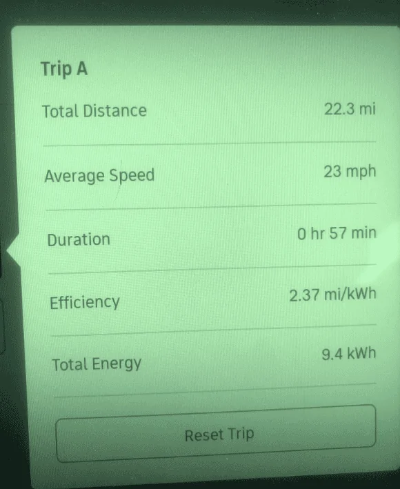

Great to hear! Got the 65psi idea from your previous posts. Still don't have enough miles on them to evaluate. Here's a sample of 1/3 freeway 2/3 city with lots of hills at approx 65F
What psi do you plan to air down to when off-road?
Heading out tomorrow morning. Probably try 35 and see how it goes. Depends on the trail too.
Also how fast did you go on the highway? How does it compare to the scorpions?
