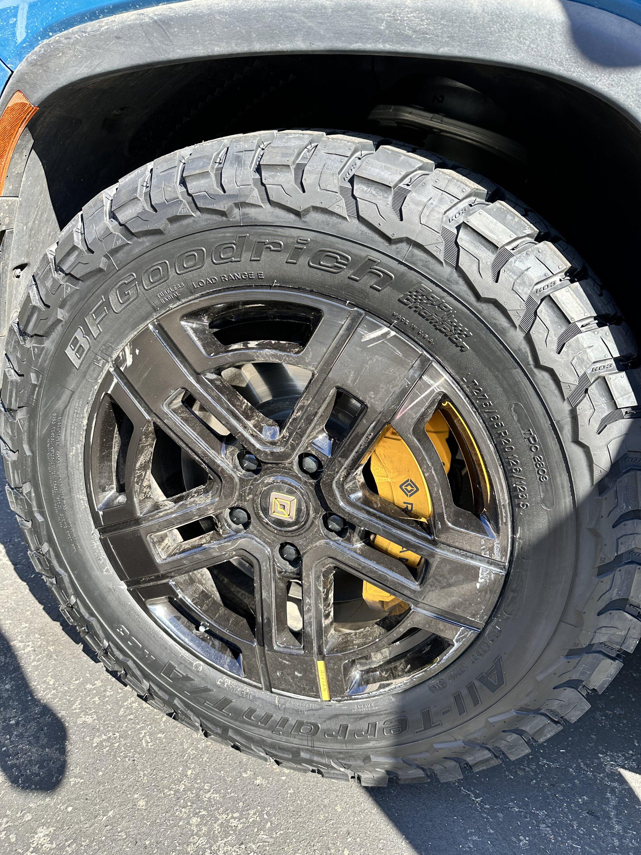

Getting the KO3s installed now at Discount Tires. They signed a deal with Rivian and this was the first Rivian done at this location. They had the pucks and put it up on four jacks as well.
Yeah I tend to agree...was a bit surprised. I confirmed they had worked on Rivians beforehand

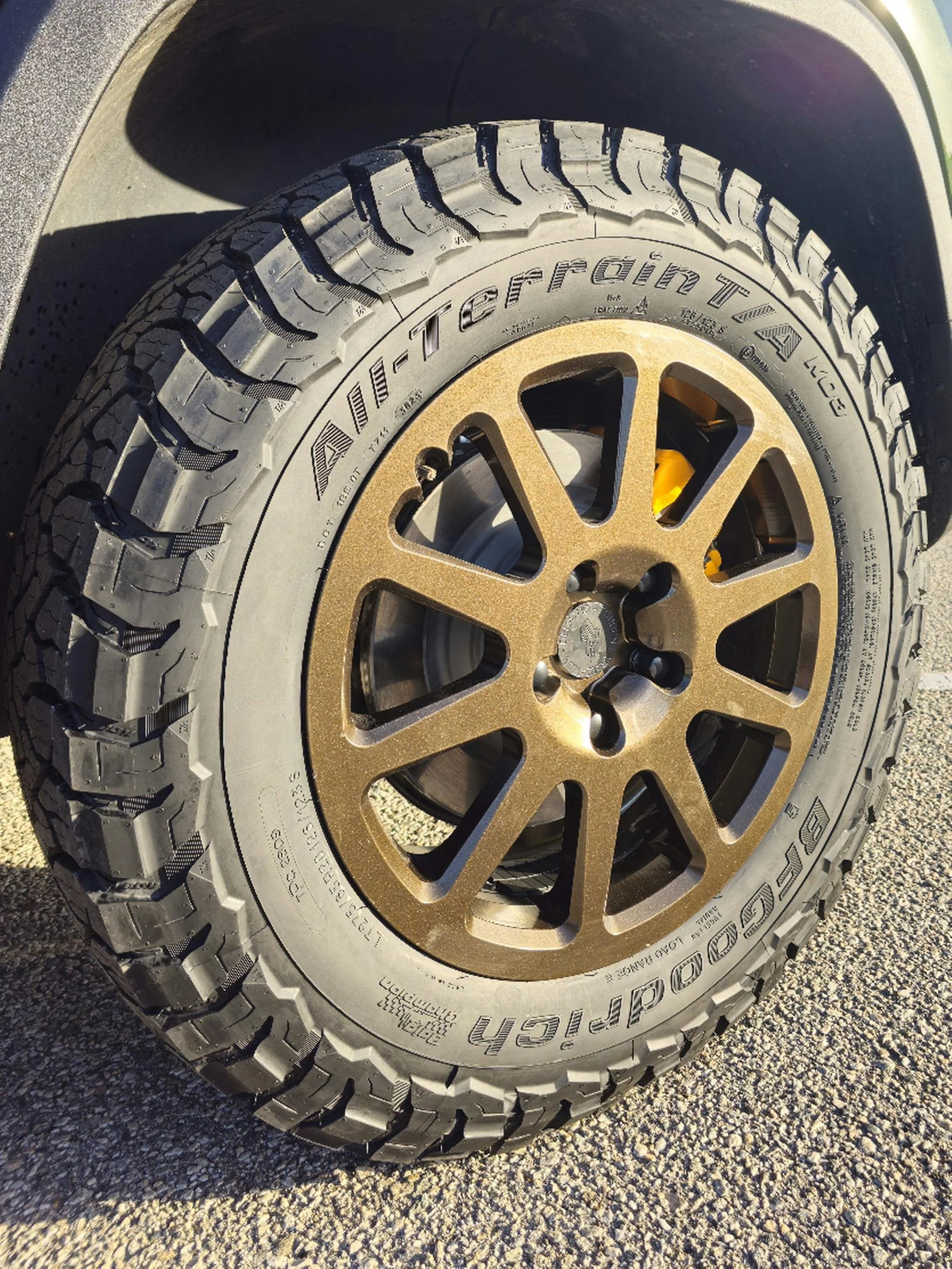

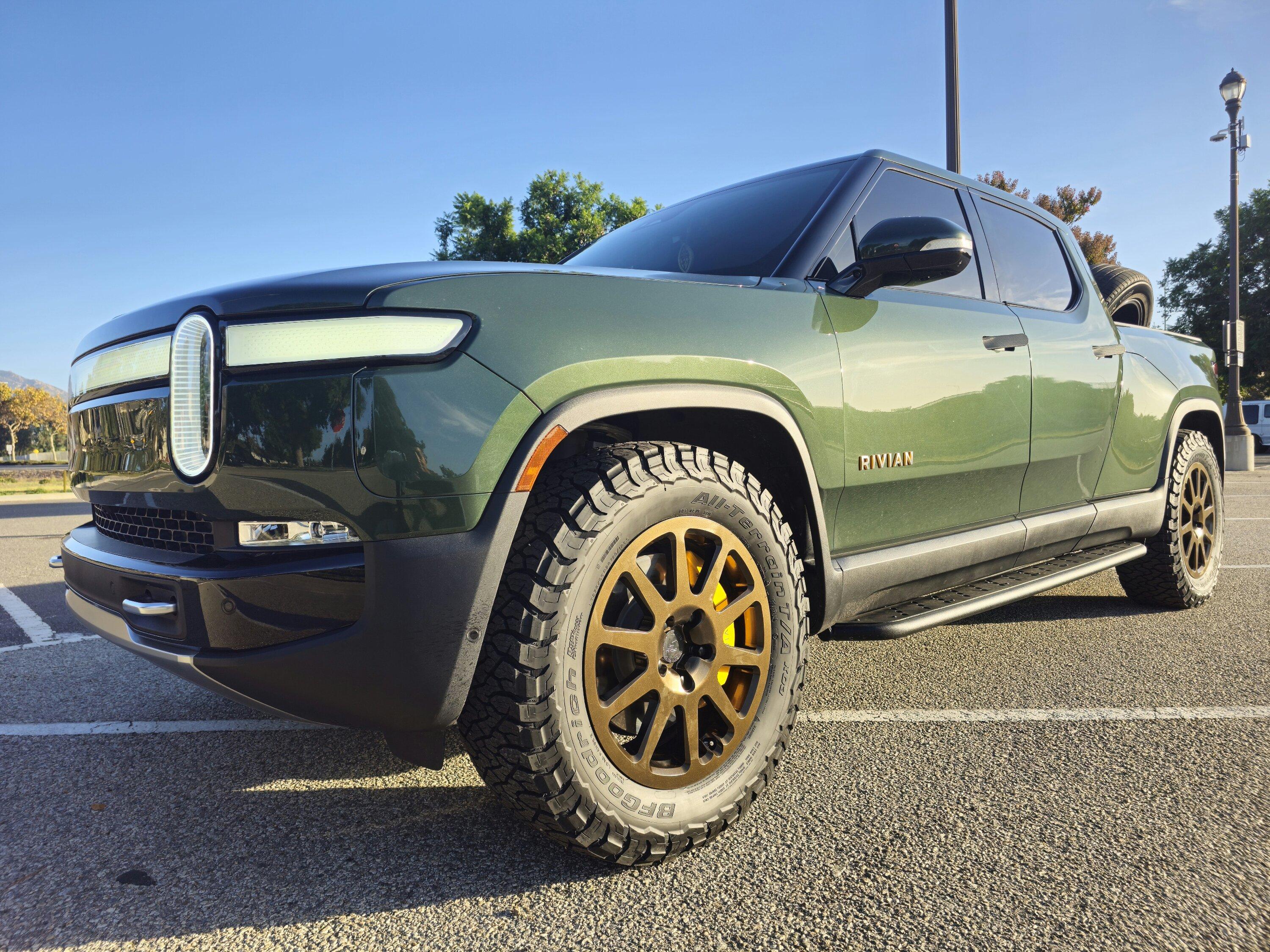

Same here. K03s on Thuren 20 wheels in bronze. First impressions coming from the OEM 21s is there is a droning sound to them and not as quiet. Radio on with the volume at 12 muffles the droning sound completely. I only got to drive it for 2 days then it went straight to a powdercoater to redo the powdercoat. For the time I did drive there was a wobble in my steering above 60mph and not as smooth of a ride. I wonder if it was because America's Tire had issues balancing one of the wheels/tire. The America's Tire in my area f'd up my wheels and put so many scratches and dinks on them as if they didn't give AF what they were doing. But that's another story for another day. I spoke to the manager and he's paying for a powdercoater in my area to redo them. Once they fix them, rebalance them and mount them back on, I'll update my post with my impressions. But take my opinion with a grain of salt. This is my first truck and first set of AT wheels.
