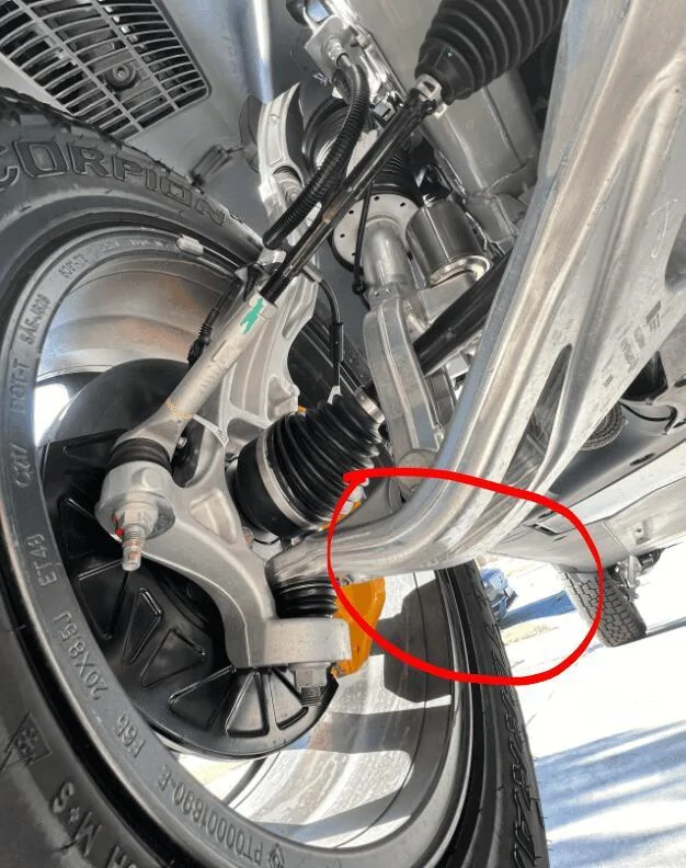

A Rivian service tech lifted my truck by the lower control arm in the rear, which is a standard practice. I've also used this lifting point myself.
(credit jplblue below)
Rivian R1T R1S Lifting by suspension???? Rivian lower control arm floor jack
