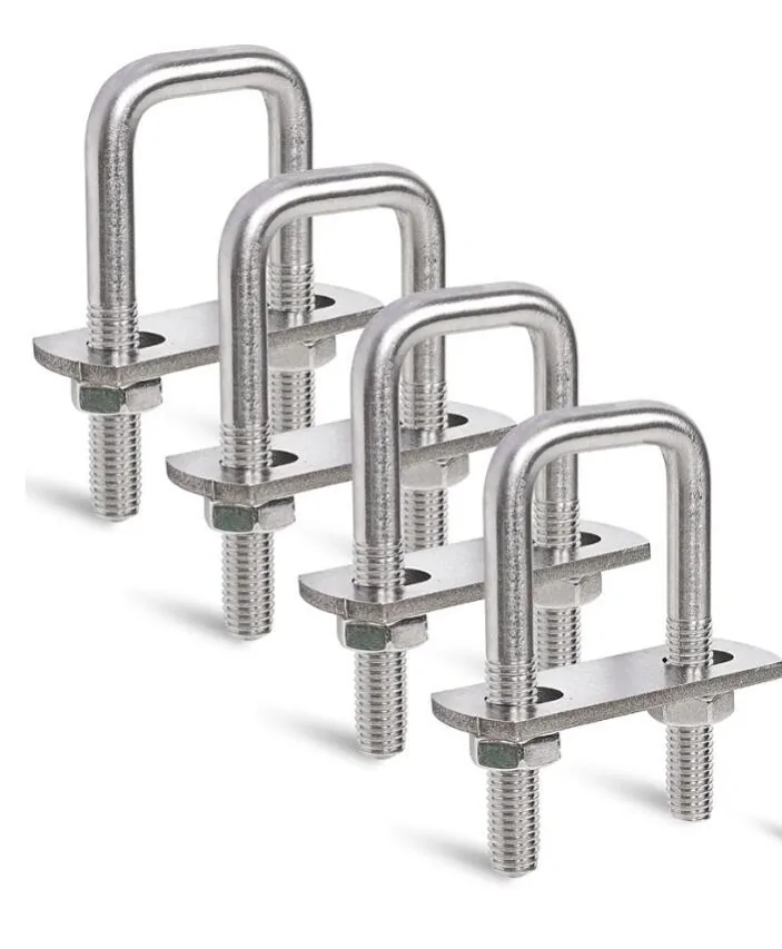

How about grabbing some U bolts that are the same size as the gear tunnel door u bolts and jamming that into the latch to stop the alarm and enable full functionality?

I did the same with a screwdriver and the tailgate latch to clear my errors and make it work.
Kinda brilliant low-tech fix. Love it. Wish the drivers door had something for back in to places
That's a person with experience and problem solving skills right there. Love it.
