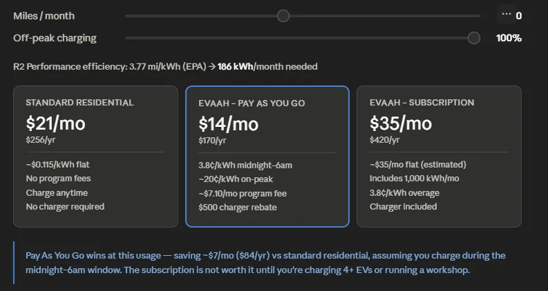

I had Claude build a widget based on the Xcel programs and assumed range of the R2. Here's an example of charging to 8-% daily at 800 miles a month to offset range loss in the winter.
Rivian R1T R1S Looking for advice on Xcel Energy EV Accelerate options in Minnesota Screenshot 2026-04-30 152116

I uploaded the wrong screenshot, I've corrected that to show 100% charging between Midnight and 6am. So I paying 1/3rd standard rates for overnight... but double whenever I charge outside that window. If I'm disciplined, shouldn't be an issue but... hard to tell if needs must would erase that ~$80 annual savings. I get the limitation on ChargePoint though there is currently a $500 rebate on that charger, there's also a possible $1500 rebate on the panel upgrade if I need to. I don't know if that is tied to the subscription offer.
