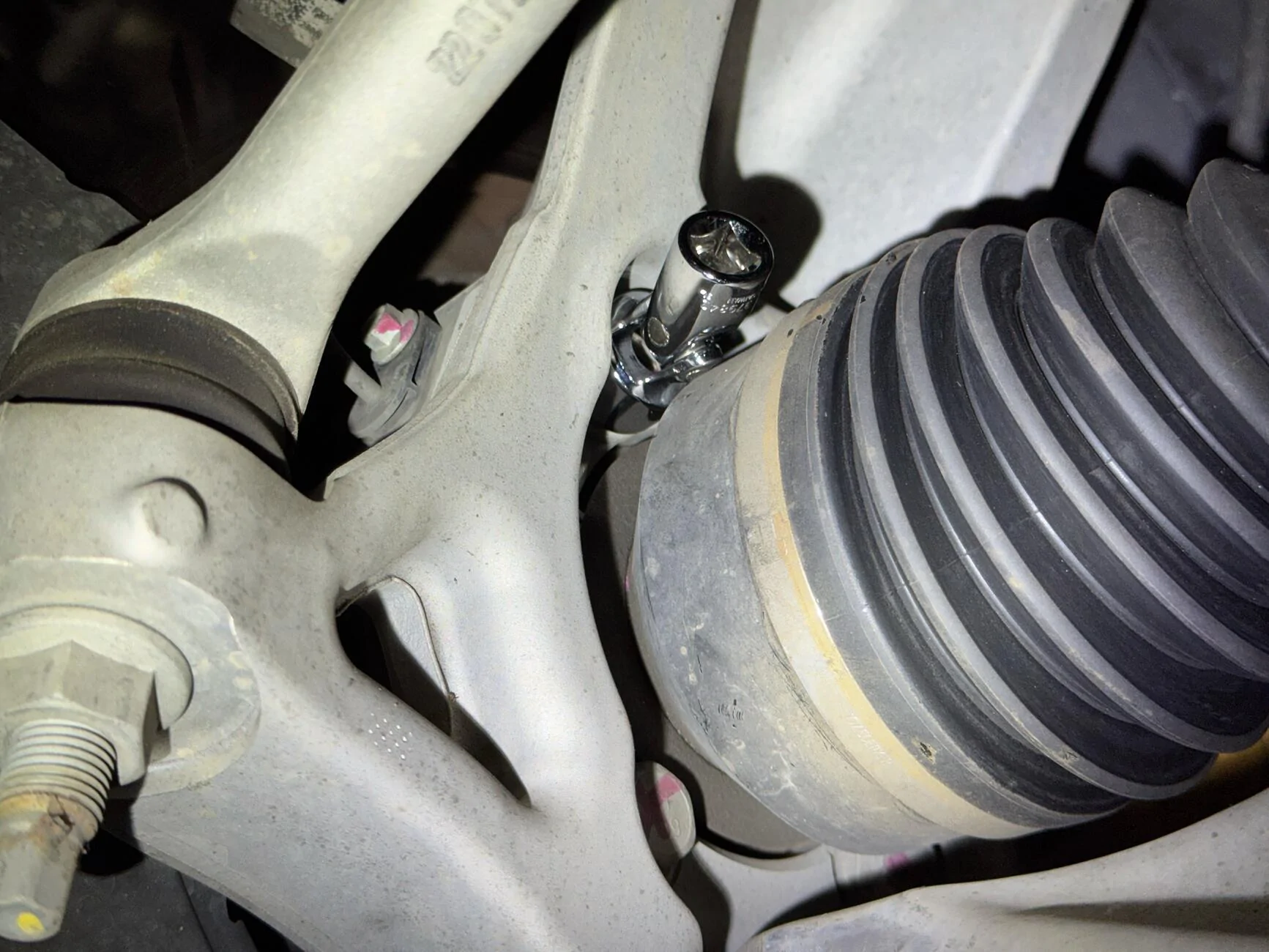

I know this threads a bit old, but had this problem on my 14k mile '24 R1S Quad. Got my half shafts replaced as well after one kissed/made out with said bolt. So, check your bolts y'all!!! I checked other bolts prior to service and noticed a large variance in how (un)torqued some were.

I carry a spare bolt. It is relatively easy to loosen the half shaft to replace the bolt on the side of the road. I did reuse the half shaft bolt, as I knew Rivian would be replacing my bolt and the half shaft bolt. When I checked all the bolts on the front, I found some only tightened to around 50nm. This is a service campagne. I strongly recommend anyone that has not had this done on their 24 or older R1 to get it done. Once torqued properly, it should not happen again.
