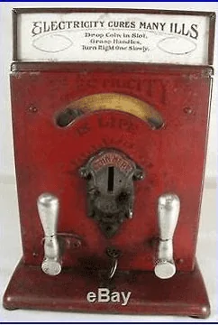

OldGoat
Sep 22, 2021
213
428
North Carolina
R1T Grand Cherokee 4xe
Hey,
Obviously you should get the electrical grounding checked but the shock would not go through the rubber and I notice on mine when plugged in sometimes it vibrates at high freq for a bit. I wonder if that's what your feeling, a bit like those old arcade machines that simulated a shock but was vibrating the handles?
Maybe.
One of my hobbies is restoring old arcade games (1950's and earlier) and trade stimulators. If you are referring to the old devices advertised to provide amazing health benefits where you drop in a penny and either rotate one of the 'doorknob' handles or lever, I can assure you it ain't simulating a shock. It is very, very real. I resotred an old Advance 'Electricity is Life' machine and it can give you quite a wallop. My wife always shakes her head 'why would anyone think its fun to get shock?!?...gotta be a guy thing' (she's probably correct)
Rivian R1T R1S Mild Electric Shock when touching any metal 1714597591484-4o
Jimbydude
James
Jan 1, 2024
78
94513
Rivian R1T, 2018 Tesla Model 3, 2016 Honda Civic
Eeek.
but I'm referring to the more 'modern' ones that use vibration. There used to be in one in local Chucky Cheese, I think it was called Vibrating Ape.
