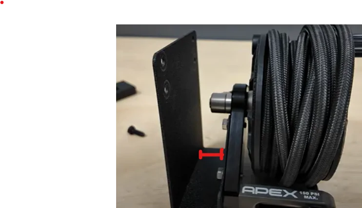

Curious for this one, why have the reel stick out so far away from the mounts? Seems like you could cut that distance in half which would cut down on the force applied so far out.

That's an aberration of the video camera lens. Its really not that much. Also you'll see that I don't have very much room to even get the bolts in to tighten the apex reel to the mount. I'd say I'm at a comfortable minimum.
