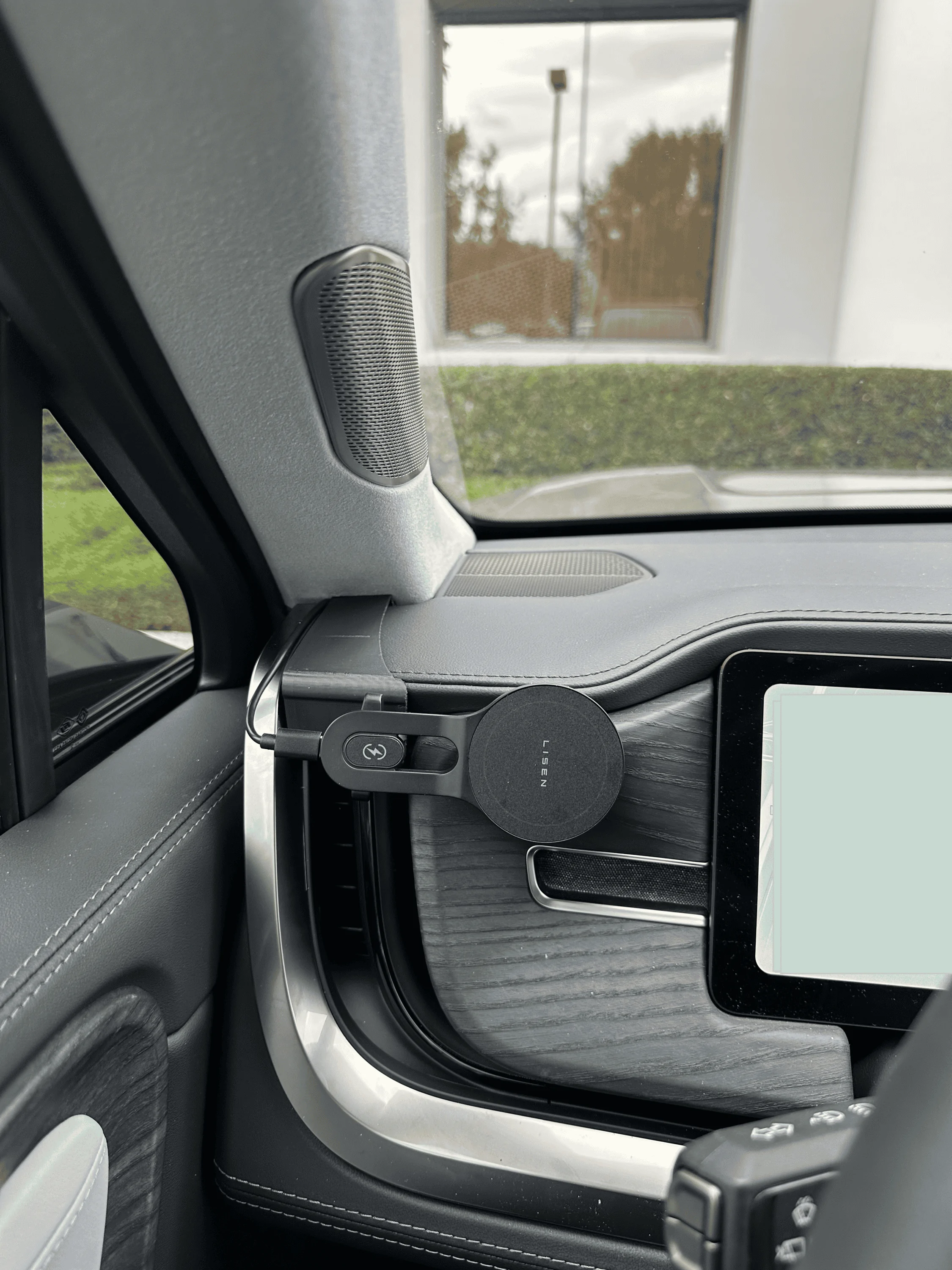

Rivian R1T R1S Mounting a cell phone.  Has anyone done it? IMG_56382
Heres mine, Rob recently sent me the extended version. I have mine mounted this way, fully visible and also completely out of the way of the vent.
I like this setup. Can you provide the source of the charger and "Listen" magnetic holder. Thanks
Parts list:
Left side mount
https://opensourceev.com/products/left-phone-ball-mount-v2
17mm ball
OBDII USB Converter
https://opensourceev.com/products/scosche-obd-ii-to-usb-adapter?_pos=1&_psq=sco&_ss=e&_v=1.0
MagSafe mount
LISEN for 15W MagSafe Car Mount Charger [No More Heating] iPhone Wireless Car Charger Magnetic Phone Holder Mount, Automobile Car Phone Holder Vent Fit iPhone 15 Pro Plus Max 14 13 12 MagSafe Case https://a.co/d/0r4P8jZ
