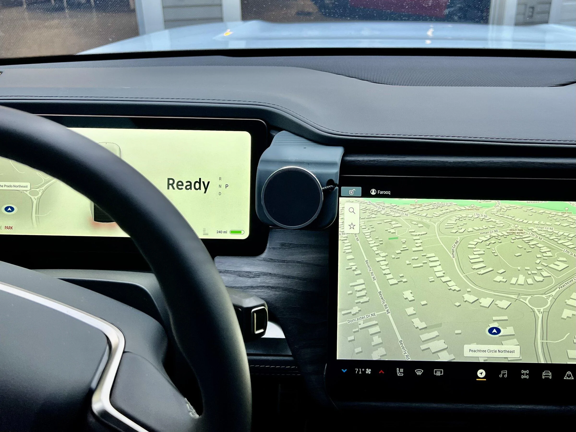

I used the printed part from EV amp
Phone Mount Dash Anchor for Rivian R1T & R1S - Anchor + 25mm/1in Ball
  • Configuration:
    + rRAM parts + Apple MagSafe charger .
  • the printed wedge from OpenEV snapped and broke -the EV amp has a friction screw and is better
  • Configuration:
does your phone even stay on the magsafe charger while driving? before i switched to peak design case and mag mount, i tried this solution and my phone wouldn't stay on while driving

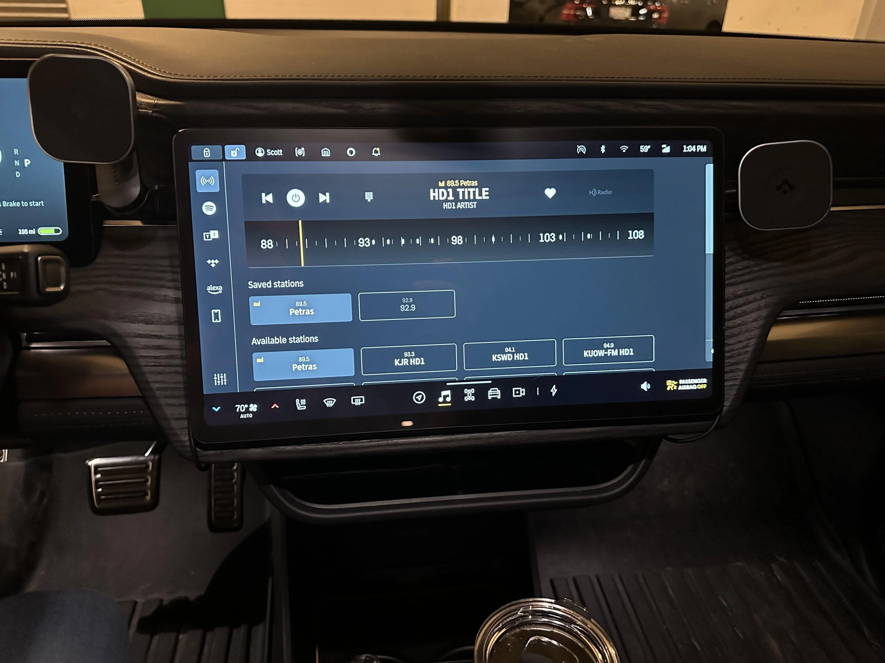

Here is my customized phone mount. Found a flat rubberized plate of which I bent into an "L" shape and wedged it between the top dash panel. Superglued the mag charger onto it and ran the wire down to the 12v adapter socket
Oh man, nice you have a 12v. Most of us don't

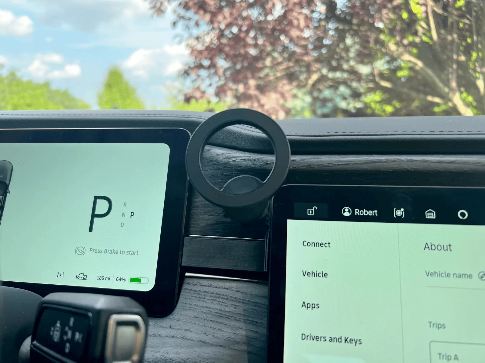

Hey man,
I ordered 2 of your phone ball mount EVOs, and I've send 2 communications via your website about how 1 of them had the plastic deform when installing it. The black plastic is on the verge of cracking, it's turned white.
Anyhow, have you received my messages? My order #4618.
Also, on the unit I did manage to mount, it seems to still be able to wiggle up and down (not side to side). How are you guys getting it to not move (esp w/ a heavy phone)?

Hey man,
Hi Byz - I've responded to both you ticket from earlier today, your PM on here, and to the ticket that you previously submitted (also same day, last week) I just need to know some additional details to process a replacement. I've recently tweaked the design to make it more robust during installation, and I 100% replace items that fail during installation.
It shouldn't wiggle at all unless you have a very large phone with a very large case on it. If it does, you might want to try a slightly different angle.
Keep in mind that the ball install should be snug, not overly tight. There is zero need to wrench it down.
I'd suggest responding to the ticket that you put in, not the PM here due to how frequently I'm here.

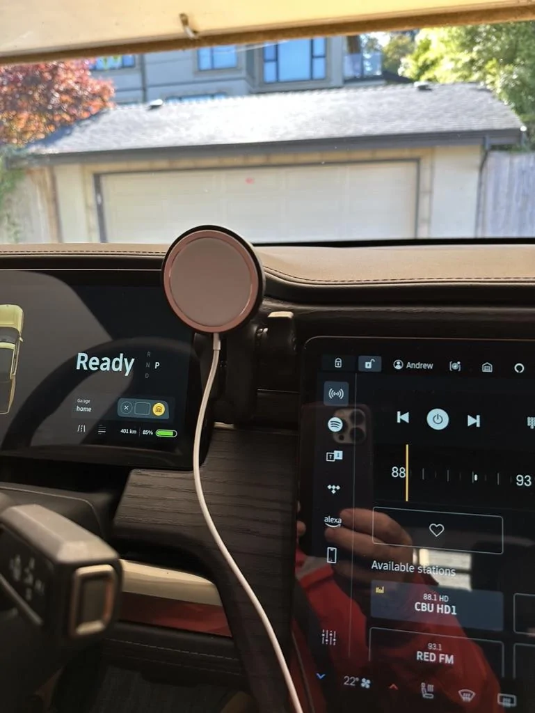

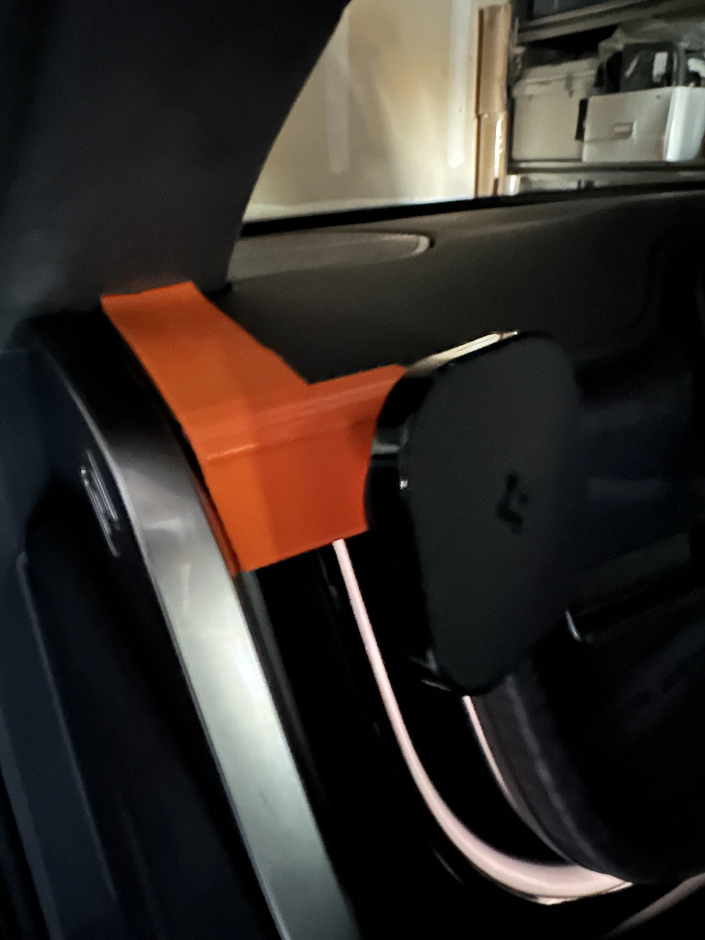

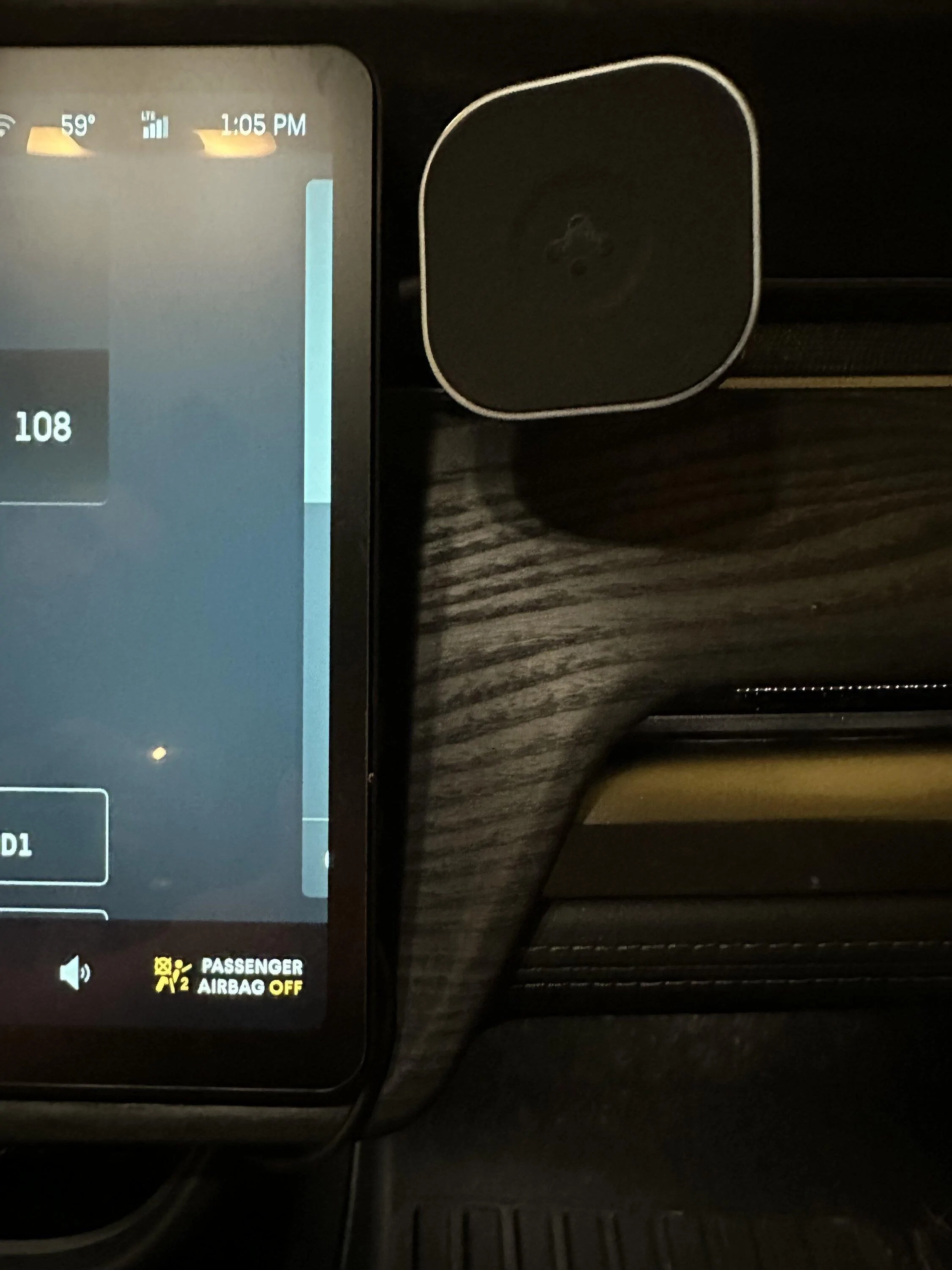

Finally completed the power runs yesterday.
Everyamp Mounts 17mm ball with two Spigen MagSafe 30w chargers usinga USBC buck converter fed from a fuse tap on the drivers fuse block, since like most newer builds I don’t have a 12v socket.
Rivian R1T R1S Mounting a cell phone.  Has anyone done it? IMG_0807
Rivian R1T R1S Mounting a cell phone.  Has anyone done it? IMG_0809
Rivian R1T R1S Mounting a cell phone.  Has anyone done it? IMG_0810

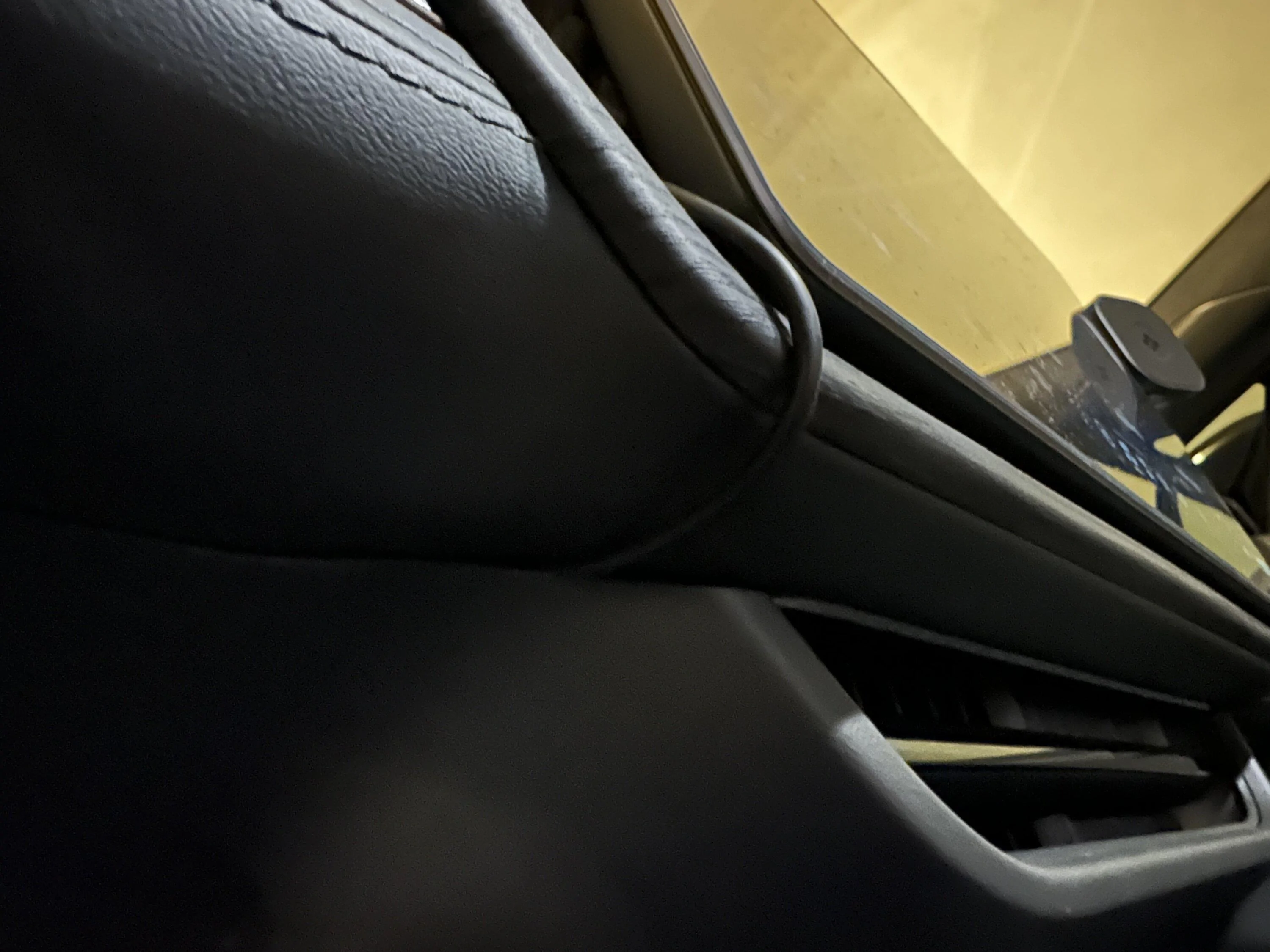

Was excited to get my open source ev left side mount kit but unfortunately the very small tabs on the back of the 17mm ball broke during install. The rear part that goes behind the dash/ near A pillar also doesn’t sit/ latch well. I would push down on it but it just doesn’t want to stay. Waste of money and now I’m back looking for a new mount. Great concept just wish they didn’t use 3D printed plastic and instead was made with something stronger
Rivian R1T R1S Mounting a cell phone.  Has anyone done it? IMG_0824
Have you reached out to us on this?
Rivian seems to have some wide tolerances with the top of the dash that leads to what you see. There is a replacement part that we send out for free when this is reported.
https://opensourceev.com/pages/contact-us
Edit:
It looks like you reached out about 90 minutes before your post. I've since responded and created a replacement order for the longer part.

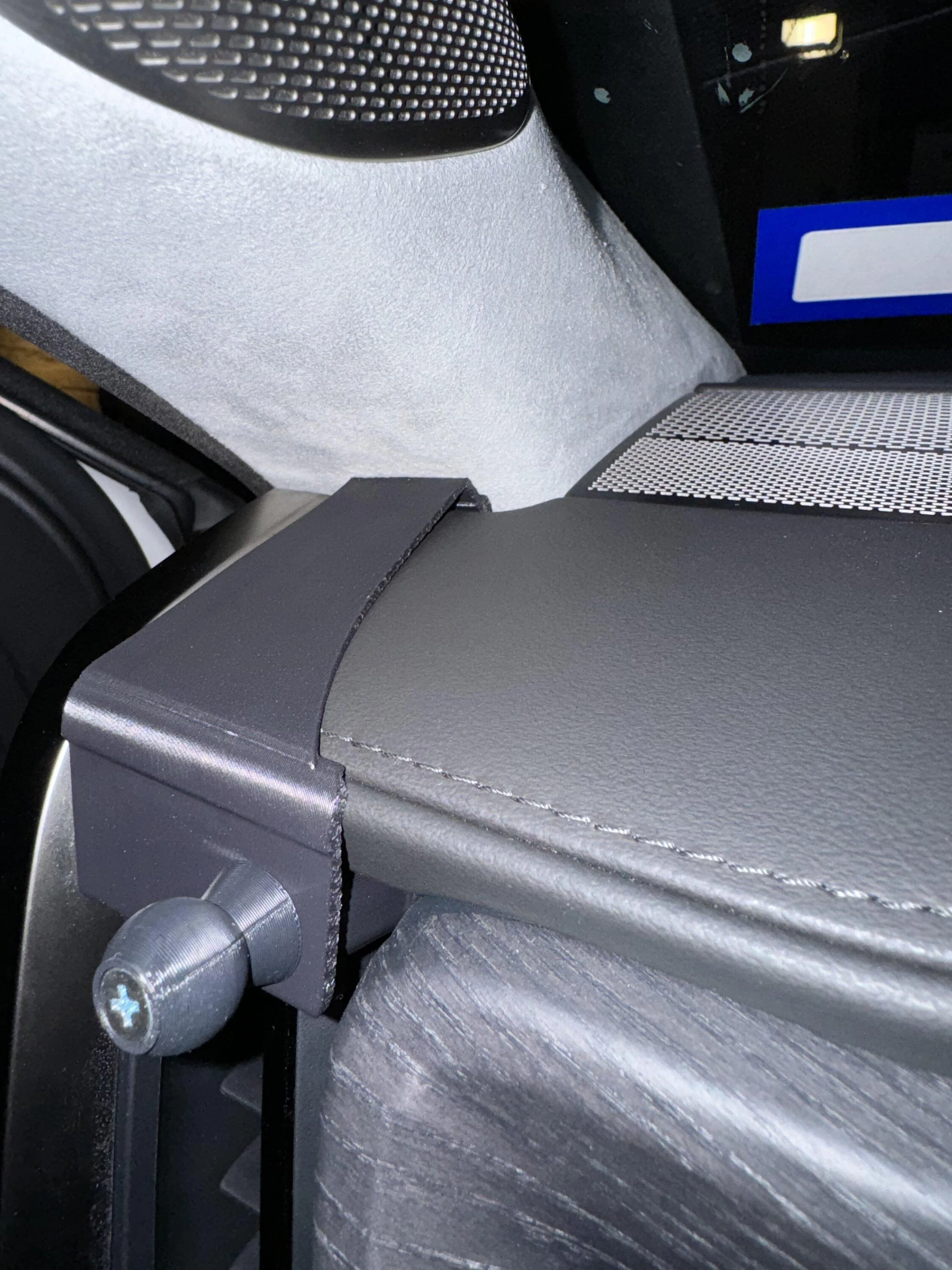

I printed the V1 of that mount myself - and it’s working great. You really need to push the a-pillar out of the way to secure the rear bit behind the dash. When I pull my phone off the MagSafe mount I’ll shift the front of the mount a bit, but when the phone is in place it’s rock solid. So maybe I have three phone mounts now… so what are you gonna do about it?! ?
Rivian R1T R1S Mounting a cell phone.  Has anyone done it? IMG_0973
I printed but have not yet assembled the V2 like you have in your image.
Thanks to @RWerksman for being an awesome maker and sharing their models!
