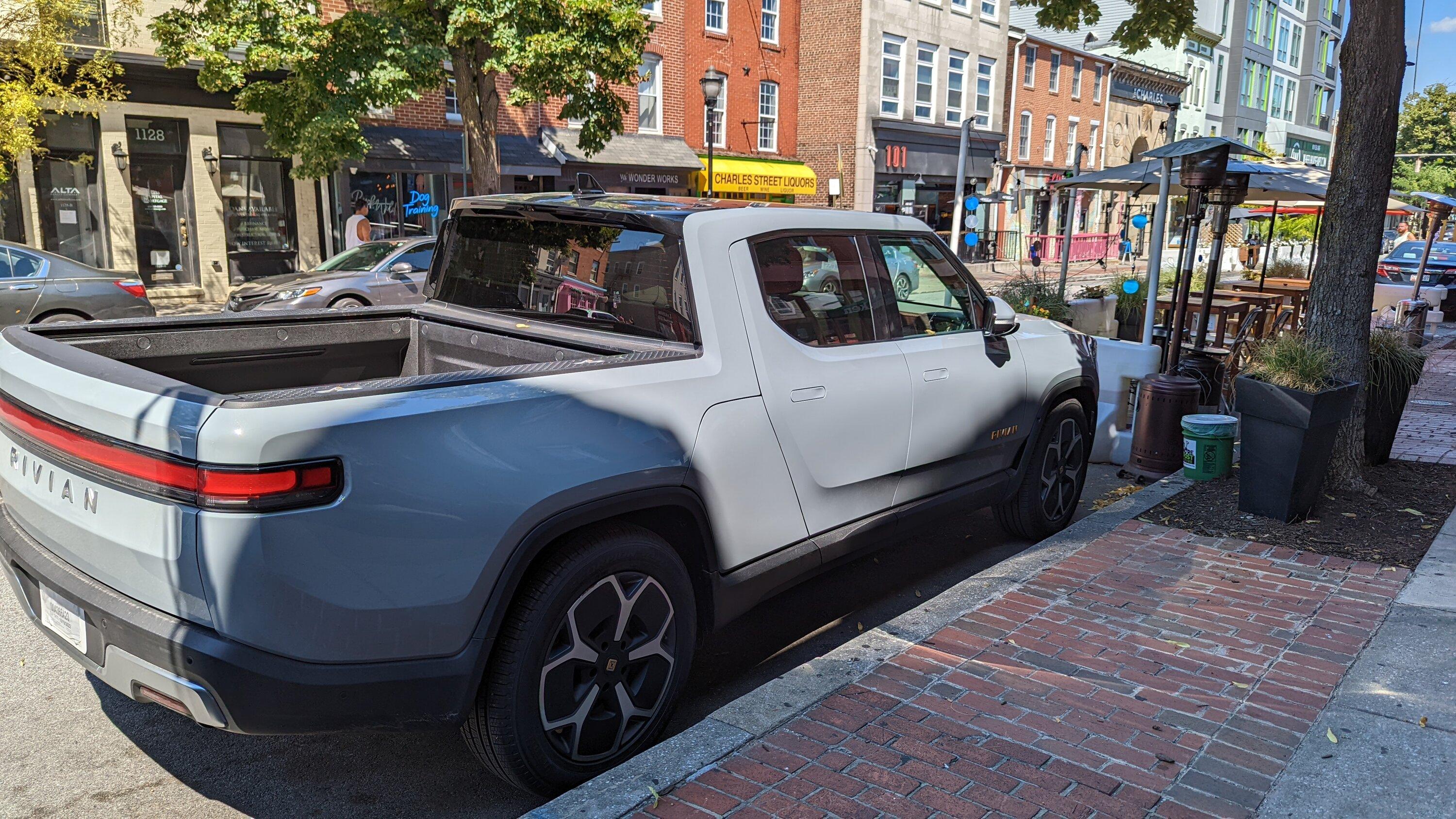

I ended up with launch green but after I saw the Limestone in person it was my second favorite. Would have pulled the trigger on one from the shop but my number was called with my exact config first. I thought the Limestone was in the nardo gray family. Not exactly that or the tacoma cement color, but in that zip code and a great color for a truck. Definitely not like the subaru cool khaki gray which has lots of blue that Limestone did not (to my eyes).
Including a gratuitous Limestone photo with sun and shade in case you're not confused enough!
Limestone is going to be the death of me!
Appreciate the response. I've seen Launch Green in person many moons ago at a local EV event and a family member of a Rivian employe was showing a LG LE with 20" wheels. Launch Green looks so much better in person than I imagined.
Great choice!
