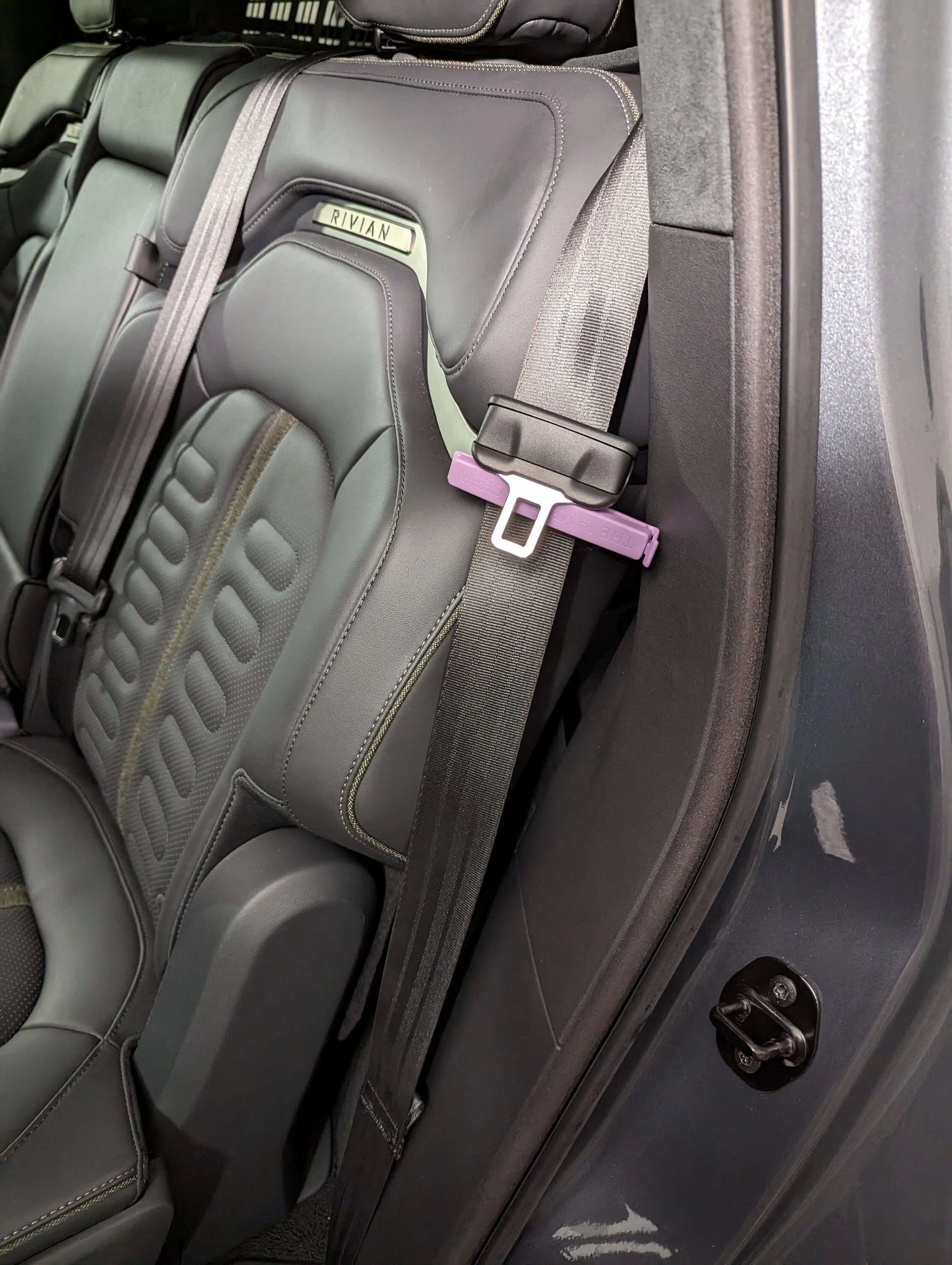

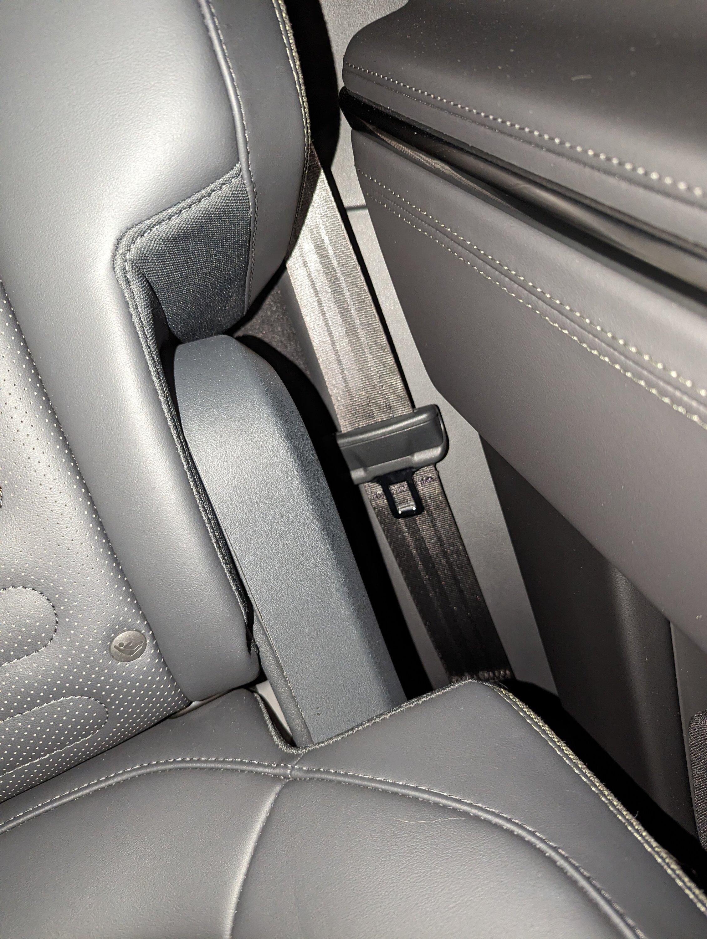

Here is how I “fixed” the issue:
Rivian R1T R1S My R1S both damaged @ inside door panel -- Design flaw? IMG_0947
Rivian R1T R1S My R1S both damaged @ inside door panel -- Design flaw? IMG_0945

I just wanted to confirm for the community that I have a similar issue with the 2025 R1S Gen 2. My door jambs look like somebody whacked the inside jambs with a ball peen hammer!
It took me the longest time to figure out what was happening. I asked the service folks and they said they didn't know and never followed-up. Initially I thought it was a spot weld joint or fabrication seam - but the dents kept multiplying. I'm not paying for this repair at lease end -hell no!
Both my kids and adult passengers, have closed the doors with the seat belt buckle laying inside the door jamb. The door will close shut with the buckle stuck in the jamb. THIS IS 100% A DESIGN FLAW AND SUPER JUNIOR JEOPARDY DESIGN MISTAKE! When was the last time you had this happen on any other car?
Moreover, ALL Rivian passengers have to follow the G-Wagon door closing protocol by using that elbow grease to get the extra oomph to slam door shut for that one time you need the vehicle to be a submarine! You would think an engineer would have thought through this procedure or there would be a bulletin repair having read all these posts. Rivian branded chip clips???!!!
1) The seat belt buckle drops and sags naturally out of the car at the height of the bench -all-of-the-time;
2) There is no tension bar connecting with the strap to prevent the buckle from falling;
3) There is no button on the belt to prevent the buckle from falling too far down - these are common on most cars.
4) The spring in the seat belt retraction mechanisim doesn't have enough tension to retract itself.
