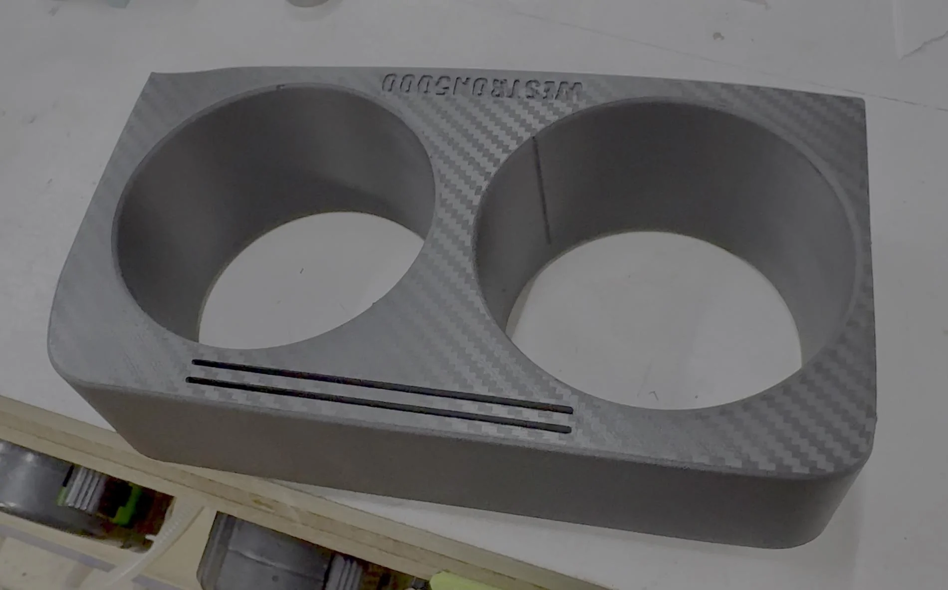

A $250 printer can make slow, competent parts from most simple to mid-grade materials that are mechanically solid. Or slow, fairly pretty parts from simple filaments. A $500 printer can make VERY good carbon-nylon parts that look fantastic, as well as super-fast prints with simpler materials, and they look great. My $1500 printer makes very fast work of most any filament, and does decent work with difficult/exotic filaments. As well as doing multi-color or multi-material combo prints.
This is from the $500 printer, in nylon-CF, with a CF pattern bed to give that texture. Printed at mid speed, high quality settings.
