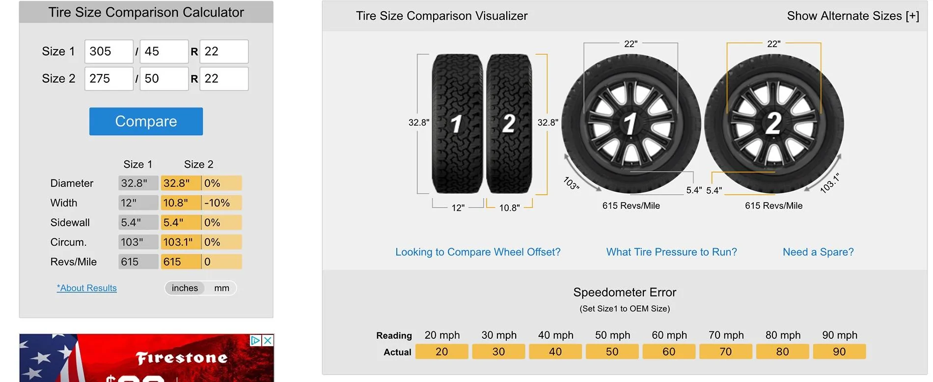

They are not lower profile just wider.
Rivian R1T R1S New 22-inch Staggered Wheel Availability? IMG_4031
69
8,937
12,322
Overall height is the same. Going from roughly a 10% lower aspect ratio but also 10% wider maintains the same height and sidewall thickness front and rear roughly.
Yes. Just pointing out what those two digits are. % of width in mm (3 digits ahead of the slash) yields height of sidewall.
