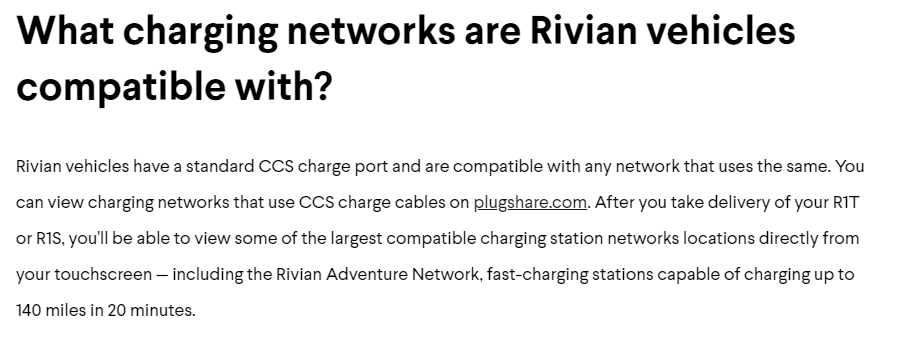

Not sure it is in the LE, the advertised rate of 140 miles in 20 minutes is in line with 200KW 400V charging rate. I believe the 300KW charging is not coming until the Max Pack is introduced.
It is equivalent to 200 kW charging at 800V, 900V, 120V, 240V or any other voltage you want to specify. Lower voltages will require higher amperage to get to the 200 kW and therefor heavier cables both on the charging equipment and internally to the vehicle.
The CCS standard does not define a 200 kW charge rate at 500V or less, nor do the current chargers on the market support it. In order to get anything above 150kW they have to support a rate >500V.
I understand that 400V is not the limiting factor and should have left that off.
But, CCS does support 500A at 400V, and that is the limit of 200KW at 400V. I just looked at a Signet charger at an EA site and they support the full 500A. The ABB units I have seen only support 450A. GM has specified the Ultium batteries with 400V architecture support 200KW charging and the Ultium with 800V architecture support 350KW. This is representative of the CCS standard.
Independent of voltage, assuming a 300 mile full range charge, 140 miles is .47 of a full battery. Assuming the estimate of 135KW that is 63KW. 63KW/200KW*60minutes = 19 minutes of charging at 200KW. That is not 300KW charging.
I thought they said their adventure stations would charge 140 miles in 20 mins, not the cars limits?
Doesn’t Tesla still rely on a 400 V architecture and manage up to 250 Kw? I guess I don’t understand enough about the charging aspect to electric cars to see what difference architectures make, and why they would even do at 800 V if they could just increase the amperage at 400 or 450V? I know Lucid has a 900 V, GM is doing 800 V for all of their heavy duty full size vehicles, and Hyundai/Kia is doing all 800 V, so there must be another reason for the higher voltage if charging rate isn’t a factor if you have higher amperage like you said.
I have read Rivian would allow up to 300 Kw in the past, but I always thought that required an 800 V architecture like the Porsche Taycan. It looks like for now they’re going to be starting off with capping it at 200 kW.
I am a complete layman when it comes to this subject, so please excuse any ignorance.
The maximum current specification for CCS connectors is 500A. That also requires liquid cooled cables and connector in the charger. Tesla is proprietary and is pushing 625A. To get 350KW, you need at least 700V (700V*500A=350KW). At 400V and 500A, that is 200KW.
It is not clear that they ever differentiate capability versus networks on the web site.
