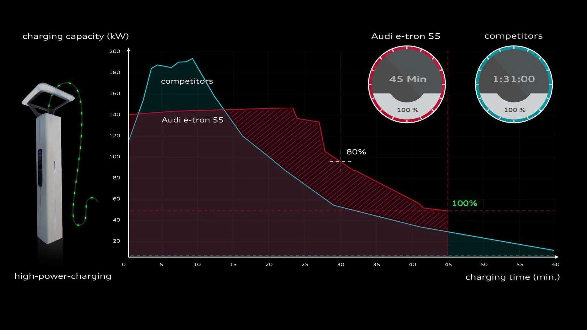

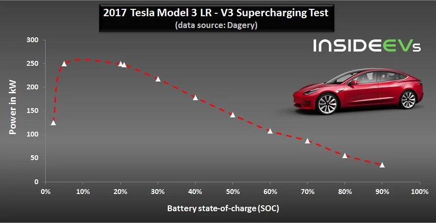

As for the Charging rate of 200kW, we hope the charging curve is better than what Tesla Model 3 vehicles sometimes obtain. The curve may hit 250kW under optimum conditions but only for a short time frame. A charging curve demonstrated by Audi has to be similar to what Rivian is promising since Rivian is stating a much greater range per time frame than even Tesla advertises. One should remember that the actual power output, environmental factors and other will also influence the actual charging rate/curve at each location.
I charged my 2015 Model S today and somewhat paid attention to the power draw. Battery was at about 20% full and it was a 150kW supercharger. It started (and peaked) at 73kW and then tapered down to about 40kW at 80% full. I’m thinking that despite the lower efficiency of the Rivian, it will still charge faster than my Tesla.

The older Tesla can not take advantage of V3 rates. I understand it as these older vehicles were capped at 90kW charging rates. Tesla upped newer versions to 120kW rates. Then last year(?), Tesla introduced V3 charging stations with 250kW rates. However, only newer Teslas can charge at these rates. Thus providing a reason for owners to purchase something newer and "faster".
