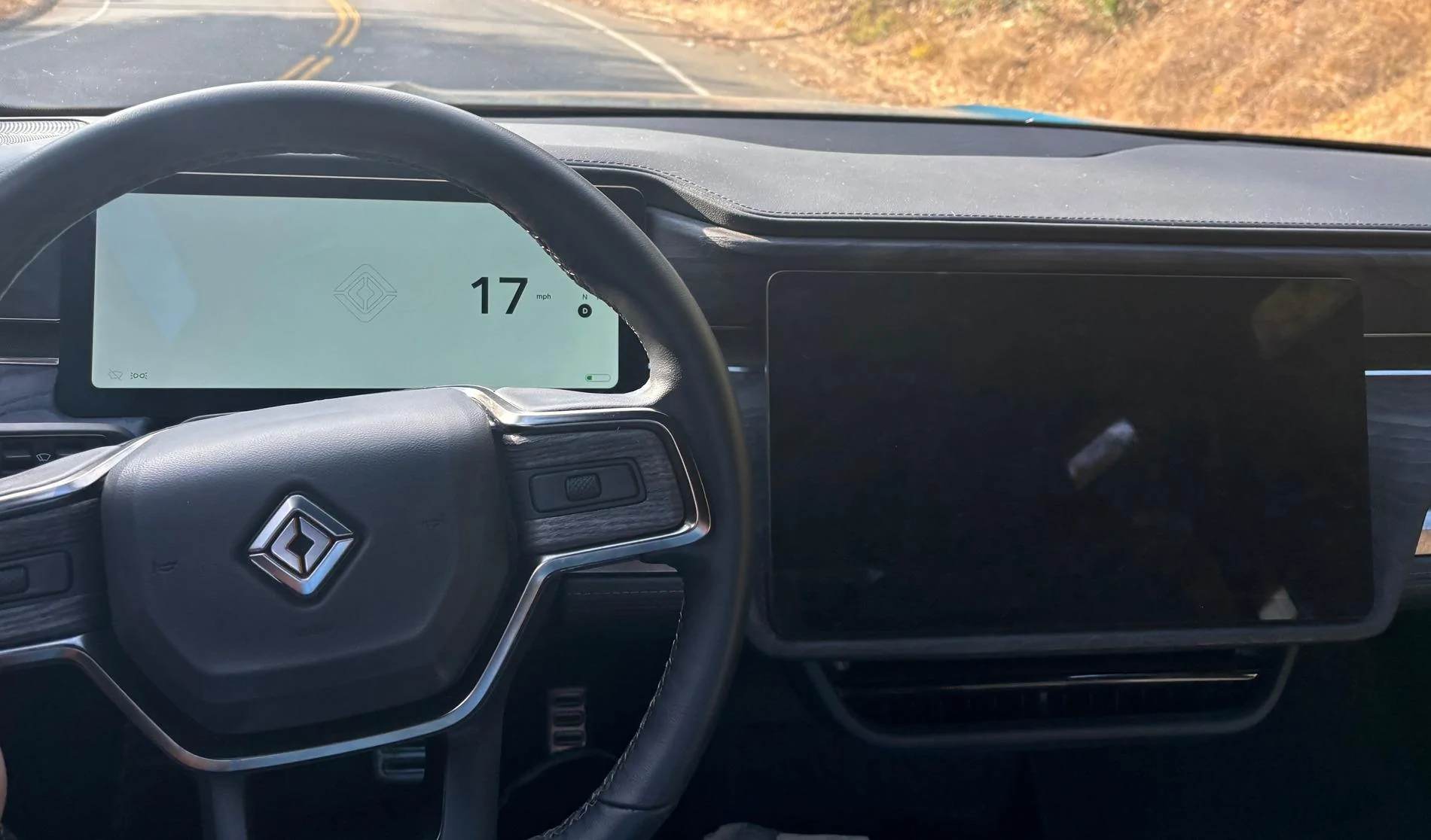

Update
The truck was at SSF SC for 1-week. They replaced the following:
MODULE - ECU; ADAS/CCDE; AXM Part# PT00001493-P
CENTER DISPLAY - INFORMATION, R1 Part# PT00055883-F
During the 1-hr ride home, the screen crashed 5x, no change from before.
The truck returned to service a week later. I noted specific time points of the screen crashing event during the drive in to SC for the benefit of their log review. This was their conclusion:
Cause:
- Confirmed with vehicle logs found a SanDisk device which is being attached to the USB in the
center console is causing the screens to crash at varying times while the vehicle is in the
customer's possession It is advised that the customer stop using or replace this SanDisk device
So, since the 2 TB USB-C has been disconnected, no issues.
Add me to the list of significant sw issues. Three of the most significant in order of least to most:
  1. volume from 1 to 2 is too much (Spotify)
  2. PAAK does not recognize the @home setting to only lock. Now, it freely locks and unlocks as I leave and approach the R1T
  3. Black screen of death. While driving and using the nav for the first time since update, 10 minutes into the drive, the main screen goes black and secondary screen only shows the speed and RDNP symbols (see image) - driving ability was unaffected. After 2 minutes of black screen, it did reset and was okay for 5-8 minutes before it happened again. During the 50 minute drive, it crashed five times.
I did contact roadside service to report the issue and did a hard reset to capture the log file.
Can they allow us to revert back to the previous sw?
